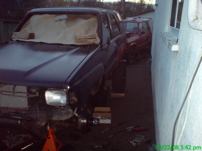

Gotta love living in Victoria, BC. The only place in Canada that didn't get snow last year. Unfortunately we get a ton of rain. Not quite Seattle or Vancouver rain, but enough grey windy days, that if you have to work outside as I do, it can make for slow progress. Especially if you have to keep regrinding and cleaning things of rust so they can be welded. Here's another couple of the rear and front with winch in. This is still the DD at this point and so signals needed a place to go until they could be dealt with. Funny thing is this is how the front stayed for quite a while till school was done.
So you can sortof get a look at the front axle.
IFS Calipers/LC Rotors/Extended Brake Lines/Dual Diaphragm Booster w/Large Bore MC/Front Armor/Complete Rebuild/Sitting on Custom Springs.
About the springs. They started out as a really good set of 79-83 rears as the main leafs. Then used the military wrap from a set of 85's. The rest are whatever was left in whatever order they fit best. I started with a 5 leaf pack. Whenever I did a U-turn or shap turn, the front would just nosedive and try to lift the opposite rear. So then I went to a six leaf pack. A bit better, but once winch and more bumper were added, the 6 leaf pack would be way too soft. So a seventh leaf was added and though I still have a bit to add to the front bumper, it seems perfect.

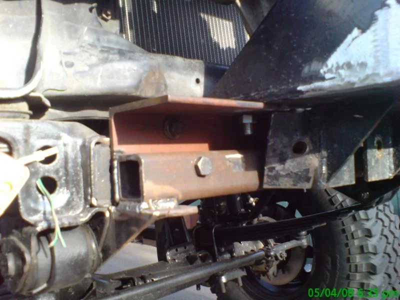

OK, so jumping ahead a bit to May and we've got the beginnings of a bumper on the front and rear. The winch is as yet unwired and the rear swingout was almost there. A few gauges got thrown into the dash and, after moving a couple of the rear window switches from the center console, a marine switchplate was installed in front of the armrest. The switchplate has three main switches, 1 momentary double pole, one momentary push-button, and fuses and a voltmeter. The main switches are for my fuel cut, winch circuit, and starting circuit. The double pole switch is activated by the main winch switch and controls the winch in/out. The solenoids are all mounted under the hood. The push-button switch is powered by the starting circuit switch, and it controls ignition. Unecessary? Yes, but cool and one more step in stopping a thief. Also unecessary but cool was a factory inclinometer/altimeter.

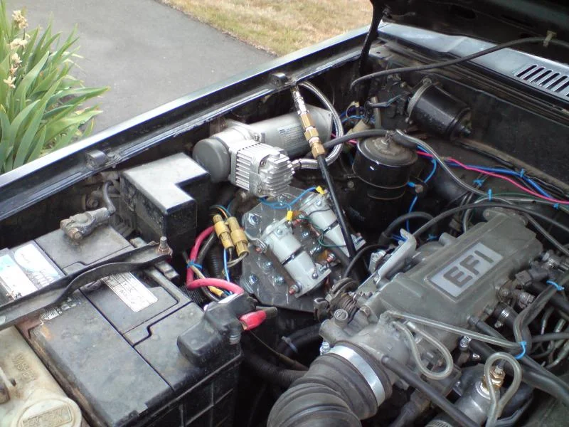

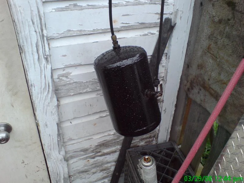

OBA -What started out as a plan to use a factory Toyota A/C compressor, ended up with 12v ViAir unit going in. I had all the airlines and my airtank, a few fistfulls of fittings, and though it never got installed, I have the plans and valves for a type 12 maxi brake(air/spring brake) I'm going to be using it as my Parking brake. So it will be a hand valve controlled Parking brake. Spring on/Air off. Good luck stealing my truck.
Ultimately, I need a bit bigger tank to run stuff for longer, but the ViAir is 100% duty cycle. I've had it running for about 30 min straight with no probs. I only have a small piece of coiled plastic hose that mounts to the only quick connect under
the hood, but it reaches my rear tires, and it's regulated, so it's good enough for now.

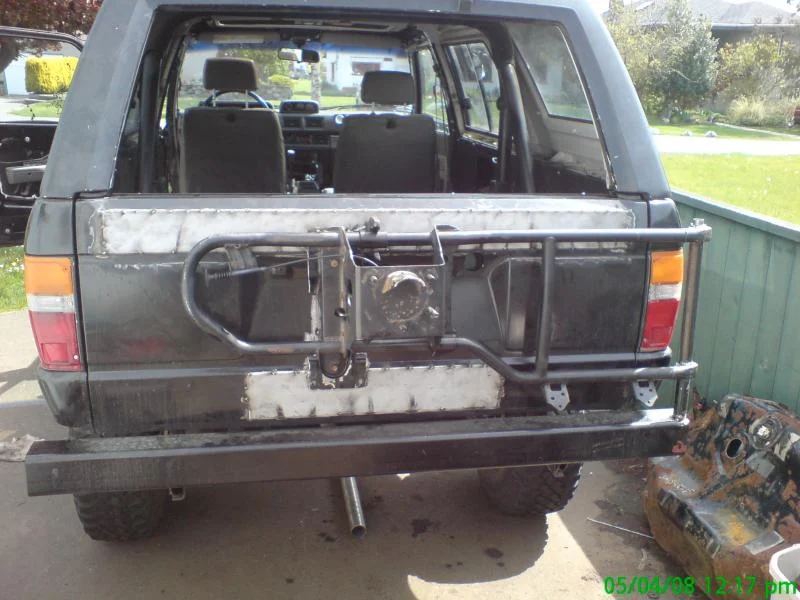

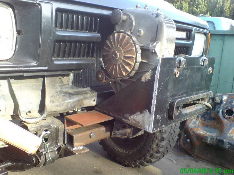

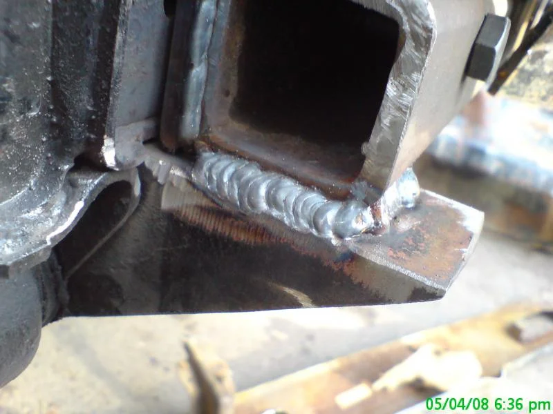

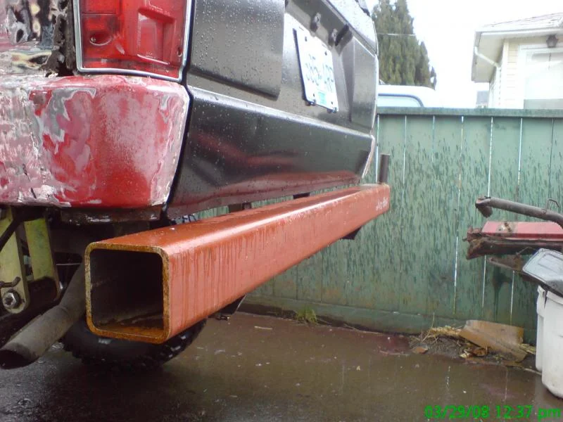

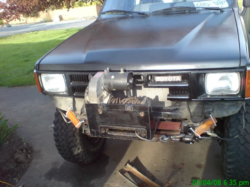

finish bumpers(front/rear) -As the pics have shown, bumper progress was slow at best. Partly because of school, partly because I kept changing my plan, partly because I'm a bit lazy. But in the weekend leading up to departure, it was because I ran out of welding gas. Well to be frank, it had been one of those months. 2 weeks earlier I had run out of wire on a weekend as well. A big spool no less! So with miscellaneous delays out of the way, and having a spare tire now that could be mounted on the back I plugged away with the swingout and side pieces to the rear bumper. We left on June 25th and I put on my last welds on the 23rd, didn't even get a chance to clean and paint.
I didn't get to complete the front one either, but got most done as far as having the winch securely mounted, but needed something better for the signals than zap-straps, and wanted a little bit of brush protection. So a couple of 1.25" pieces of tube got cut and fitted and when I came home on Monday the 23rd with gas, they became part of the truck, and welded the stock signal mounts to the tubing. also unpainted.
wire winch
-Wiring sort of got left till the end. So much so that a day before we left I was wiring the winch to the solenoids that had been mounted on a cool little piece of Aluminum treadplate under the hood(see pic) it matches the piece I cut for my rear tailgate. I never actually got the ground cable to mount, so jumper cables where there if winching was required.

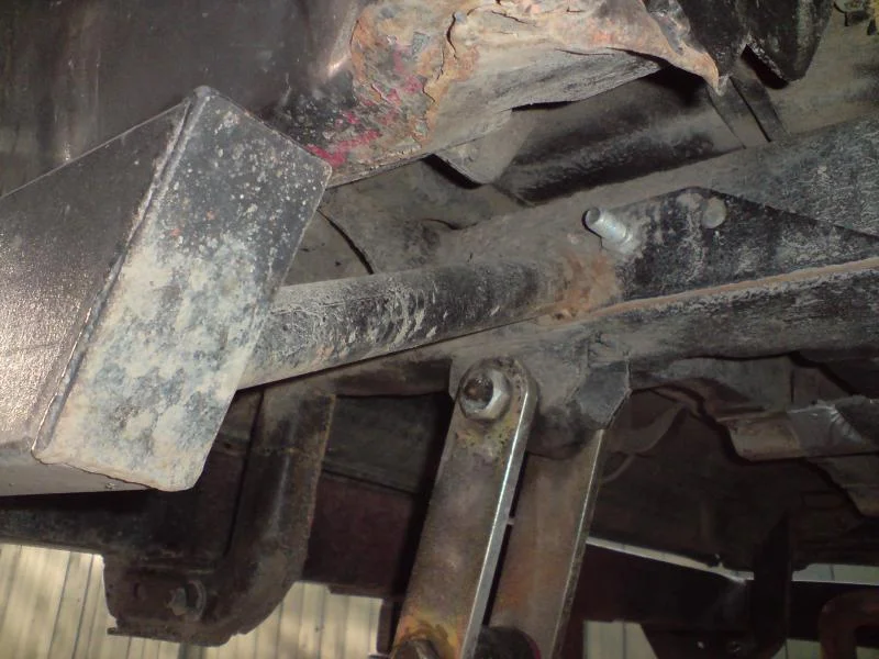

T-case skidplate -Take one large piece of 5/16 steel, bend to match the upper side of a stock X-Member. Drill holes. Leave in driveway for months putting it off and then deciding to not put it on. Can't really explain that one, it looks great, it's big, I just decided not to put it on. There you have it.

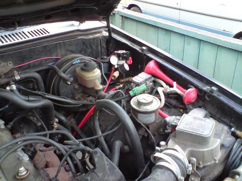

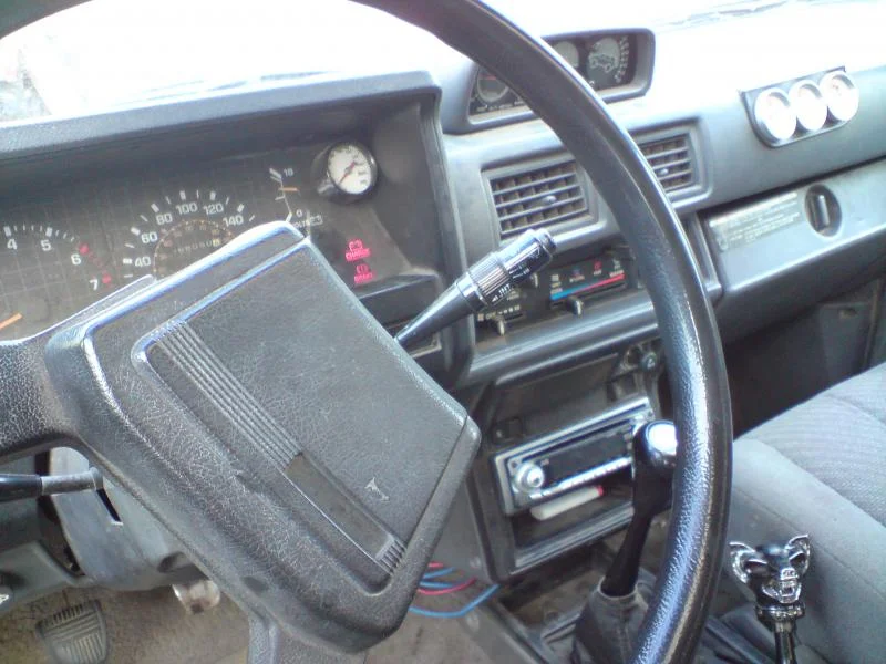

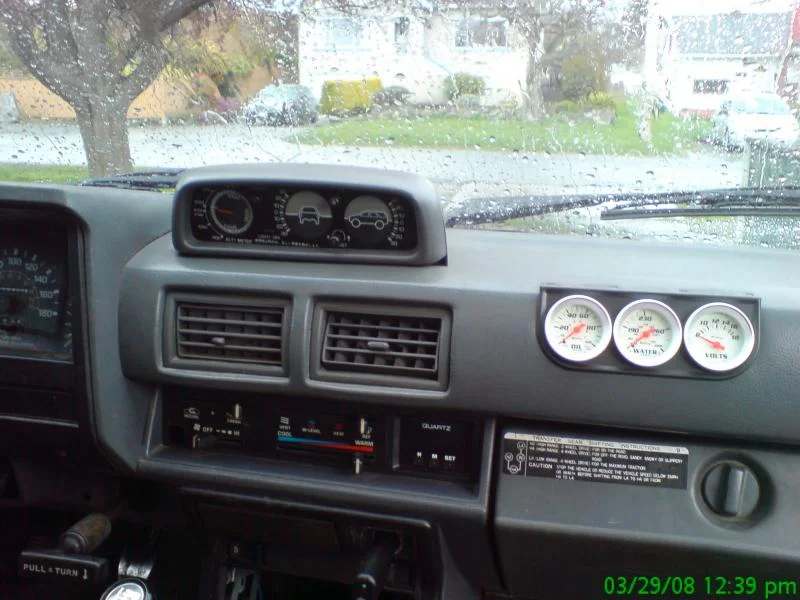

finish wiring/plumbing all switches and gauges
-So as you've just read, I had my weekend open up a bit and used that time to finish plumbing in the gauges and switches etc... All in all, there was the armrest panel that was all wired on the panel side, but only half so on the other ends of things. Pretty much the same thing went for the dash mounted gauges. I have a switch going from the armrest panel to the fuel pump, one goes to the 2 way winch switch also on the panel. The winch came with no remote, so this is how I did it, I wheel alone a lot so it works. The third switch was already in use as the arming switch for the push-button start that's located there as well. Best part is, I've reversed some of the switches, so on isn't always the same way. One more step in stopping a truck-thief. The two factory switches for the rear wiper and window had already been moved to the spots(unused) above the stereo opening. This was done to make room for the custom panel that was going in front of the armrest.
So a lot of plumbing went on throughout the weekend. I decide to move the CPU's temp sensor from the thermostat housing to down on the driver side of the block near the back. Anyone know what that spot is meant for? Every 22re I've seen has a plug screwd into it, with another sort of plug threaded into that. Anyhow, had to clean out a lot of crap that was in there, but eventually I reached coolant so decided the sensor could go there, and I'd mount the one for my new gauge in the thermo housing. For the oil pressure, I found a small pipe plug inside the engine mount on the pass side. Voltage went right to the battery.

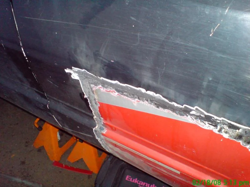

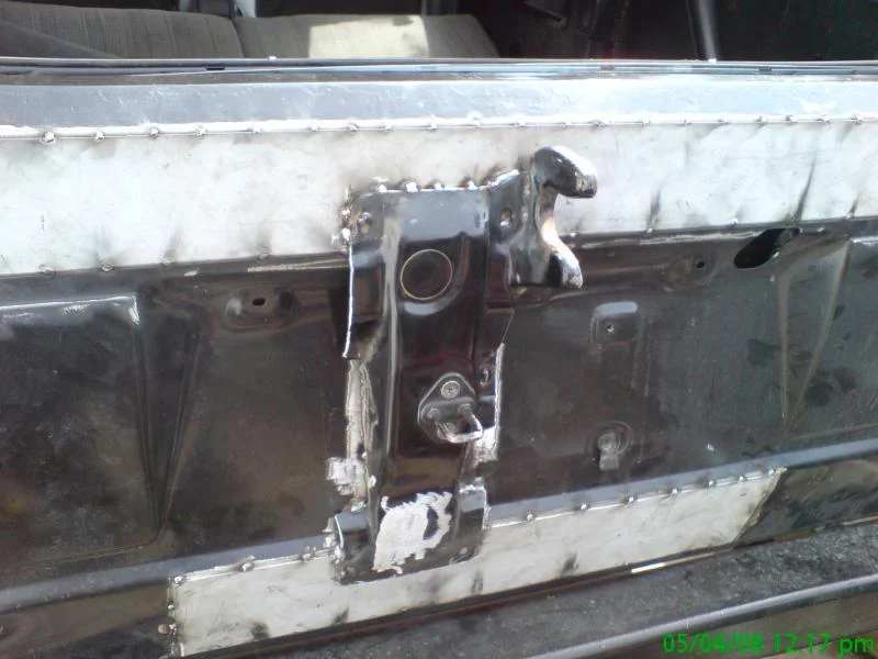

make some rear inner panels -I had mentioned at the beginning about the truck being near the ocean and under cedars and having a leaky windshield. So, well the inside was prett rotten. When I first got the truck I had pulled seats carpets and all the panels. Carpets were cleaned seats were replaced originally for 10 set of truck seats that sortof worked. I'm still in need of a driver door panel. The rear panels I decided to replace with 3/8" plywood, paint it black and even install the factory seatbelt trim and cubbys. It turned out this would also be a good way to mount some speakers in the back. Though I wouldn't know that until 2 days prior to leaving. Panels turned out ok, some fastener replacement has gone on (bigger hex-head self-tapping screws). Left two square openings at the rear where the factory jack and tools go. still no doors on em. install cd player and speakers(currently nothing) -Well, I've already alluded to this, so on the second to last day I decided to pull the CD player out of the GF's Civic and throw it in the truck. 7000km, we'd want music, I was sure of it. When I moved the two window switches to the spots above the stereo opening, there was no stereo,nor did I think to take a future stereo into account. Not a whole lot of space back there. Anyways, I shoe-horned it in there, wired up 2 2-way speakers for the rear panels. I had those speakers already, and there were no factory fronts so install was limited. 2 speakers, one cd player(mp3 compatible) couple hours later and whamo, truck has music for the first time since I'd owned it.

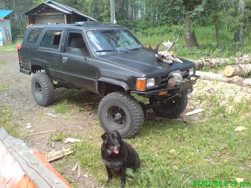

Day 1(Wed June 25th) turned out to be a late departure day, but we sortof planned it that way. It was an estimated 18 hour trip from Victoria to Smithers including the Ferry crossing to the mainland. For those not aware, Victoria is the capital of BC and is located on the Southern tip of Vancouver Island in the SW corner of the province.
Government of British Columbia
So, we spent the morning packing and cleaning the house for our friend who would be housesitting. Packing took a bit longer than expected as it can sometimes do. With that much gear it took a bit of tetris playing to get it all in there just so. The layout changed a couple of times until we got it just right and easy to unpack and repack what we needed first etc... By 2pm we were underway. The plan was to drive through the night and show up at our friends place in the a.m for coffee. We were off!
No we weren't. About 3 blocks away I realised I had forgotten my sunglasses at home. OK, now we were underway! We got to Sydney, and the Ferry terminal around 2:30 and made it on the 3pm sailing to Tsawassen(Vancouver). A quick stop to gas up and check tire pressures etc... and we were on the highway heading East. It's a bit of a tangled mess of higways in the lower west corner of the province, and a couple are under construction so our initial enthusiasm, wasn't matched by our speed of travel. Ultimately though, we persevered and overcame this first of what we were sure to be many hurdles on the voyage.
The first leg of day 1 being from home to the mainland, meant that our second leg would be a 150km/90m jaunt taking us from Tsawassen to Hope. It's hard to find a bad view in BC, with mountains, ocean and rainforest everywhere in one direction or another, but when you finally start driving towards those mountains the view becomes that much nicer. The Fraser River Valley is a lush section full of various farmlands. In late June, it's a sea of green as you slowly pick your way into the foothills of the Rocky Mountains. Once you reach Chilliwack, you're into the hills and the climbing has begun. It's safe to say the drive is beautiful for pretty much the entire rest of the trip, so I'll avoid going on too much about the stunning sights around every corner. After the up down up down necessary to cross foothills, the climb gets you to Hope. Hope, as a small sign still attests to, is where they filmed Rambo, First Blood. Being as how we had only been on the road for a bit and we still had a long way to go, we pushed on to the third leg of the day. This would be our last section on Highway 1, the Trans-Canada, for a while. A 200km/125m stretch of road, also called the Fraser Canyon Highway. Just outside of Hope, we stopped in a small town called Yale to let the dog have a stretch/snack/drink and do a little leg stretching of our own since we hadn't been out of the truck since we gassed up 2.5 hours earlier. We knew this was a roadtrip and that many KM's had to be covered, but it was also a holiday and dammit we were gonna ease into it! Yale is on the river and the Fraser is a fairly wide fast moving river which does explain the abundance of river rafting and white water kayaking signs we say along the way. So onwards and upwards, we continued North past such lovely places as "Hells Gate Canyon" and before long we were also noticing a lot of dead trees. If you haven't heard, there has been a Pine Beetle epidemic ravaging the forests in BC's interior and the evidence at times was jaw-dropping. Huge stands of dead trees in amongst live trees. Another stunning sight is driving through an old forest fire. Even being able to see only the portions visible from the Highway, thousands of square hectares of blackend tree trunks is still one heck of a sight. Unfortunately, it was getting dusk and pictures no longer became a viable option so you'll have to deal with my literary genious to impart the scenario. Well, no you wont really because it quickly became too dark to really see anything anyways, and so we drove. With a little "Thievery Corporation" coming out of the recently installed pioneer 2-ways behind me, and the glow of many new gauges in front of me, I was happy as a clam as we made our way further into the mountains. Before long we hit Cache Creek where we gassed up and made the switch onto Highway 97, a.k.a the Cariboo Highway. This would be leg 4, a 440km/275m stretch of darkness through the mountains to Prince George. PG is basically in the middle of BC. It's a bit southeast of the actual center, but once up in that neck of the woods there aren't a whole lot of cities, so for arguments sake, we'd be in the middle of BC by the end of this leg. Again, by this point it had been dark for a bit.
Everytime we gassed up, we kept a record of mileage and cost etc... and while we didn't really do any math at the time, when we got back we were roughly able to figure out our stats. During our first "tank", we used 50L to go an adjusted 450km or 9km/l or 21MPG. If we kept that up the entire trip(not likely), we would need around 890l/240gal of fuel. Since we were paying around $1.50/l or $6/gal, that put our gas budget at under $1500 and we liked that since we had budgeted $2k. I'd like to take this time to vent my frustration at "Grants Law". It's now a law in BC that you have to go in to pay for your gas before you pump. All the time. Everywhere in BC. It came in because a boy named Grant had died when he got killed by a car that was leaving without paying for gas. He tried to stop them. So, now, instead of just filling and paying, you have to guess as to how much your tank can hold, or pay more and then have to go back in to get change. Seems to me the easier way would be to tell gas attendants not to chase cars. Instead the Gov't decided that every driver on the road was guilty and punished us all. OK, I'm done
I'm gonna rush the rest of this day because well it gets a little hazy. Around midnight we called our friends to tell them we were in Williams lake, a couple hours from PG. It's supposed to be around 4 hours to their place from Prince George, and we figured we were in good enough shape to make it all the way. Well we were wrong. We got to PG ok, and another leg was done. We grabbed a Tim Horton's Coffee and decided a nap wasn't needed. PG is where you make the switch to Highway 16, the "Yellowhead" Highway heading west again. The coffee didn't last long, and neither did the wakefulness it provided. On top of the 800 kms we (I) had driven, and the late night/early wake of the day prior, we now got a little rain added to the mix. The rain was kinda nice at first since it was a real good rain. In Victoria, it doesn't snow, but it does rain quite often. Unfortunately it doesn't actually rain hard. I hadn't seen or heard a thunderstorm in a decade. But even the heavy beating of raindrops wasn't enough to keep me bright eyed. Though it did give me a chance to see that my self install of the windshield was holding up well without a leak in sight. About an hour out of PG, just before we hit Vanderhoof, I decided to pull over and try to get a couple hours shuteye leaning over in my seat. Well it was around 3am and it was raining hard, and trucks kept flying past us shaking our little truck fiercely. So after an hour and a half of almost-sleep, we decided to push on. In Fraser Lake we gassed up again. Looking back later we had gone almost exactly the same distance but we took an extra liter of gas. So far so good and we grabbed coffee and pushed on towards Smithers. The highway winds its way along between two of the many mountain ranges that make up the Rockies in BC and as morning crept up on us, we were a bit tired and cramped to really appreciate it. Long story short we arrived at our friends place at 9:30am. A 17 hour zig zag across, up and back the bottom half of the province.
That was a ridiculously long story about a 17 hour drive, but here we are. We had decided that Smither's was our 1/3 of the way there mark and having spent less than $200 on gas, we figured we were sitting pretty. The next few days would be spent with our friends before heading out again. We made their house base camp. On Everest, climbers use the base camp for staging , preparing and acclimatising. Well, we would do much the same. pouring over maps and GPS info and giving me a chance to finish things on the truck, and just getting used to the fact that we were on vacation. Part 8 comes soon with our eventual departure northward.
