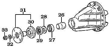

So completed the 2" OME lift the other day and now notice a vibration in the read end at 50-55 mph. Suttle, but it is there. Went under the rig today and yanked and pulled on the drive shaft to see if there was any play in the U Joints. Nothing moving in the U Joint that I could tell, but was getting some movement out of what I would call the differential flange (#31).
Spoke with a guy who said it could be the differential nut (#33?) is loose allowing there to be some side to side play in that flange where it meets the diff.
So I am talking about 31 having some lateral (non-rotational) play in it. And he is telling me 33 might be loose and need retorqued.
Does this seem possible or a likely culprit. I am not sure what else would be causing a vibration back there that would only show up after the left went in.

The flange (33 in your picture) should have absolutely zero lateral slop in it. It should be as tight as a…..

i had a similar problem when i did mine but it was because i used slightly longer shackles than what comes with an OME kit. check your pinion flange in comparison to the output of the transfer case. if they are not parallel you may need a castor shim to make them parallel. otherwise the u joints turn at a slightly different speed (angular rotation) and will cause a vibration. that being said there really shouldn’t be any play at the pinion so you may have that problem too
