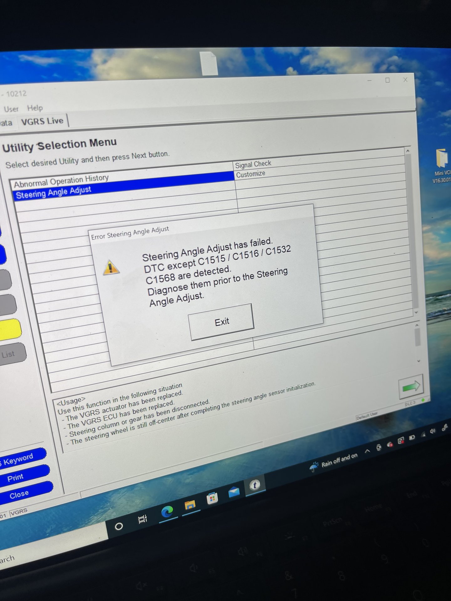

I was attempting to recalibrate vgrs but it won't let me due to these codes. See attachment . So frustrating ..
Your vgrs is out I took mine to dealer to confirm they wanted 6k my mechanic just took the Steering wheel and realigned it but I bought it’s about 90 percent better the light is still on I bought the lower and upper shaft from o2 Lexus that’s next step if it locks up

Ugh!!! Dammit . . Well my steering wheel is straight and drives straight down the road tho. I was hoping and praying it'll recalibrate itself after driving it for a while. .
