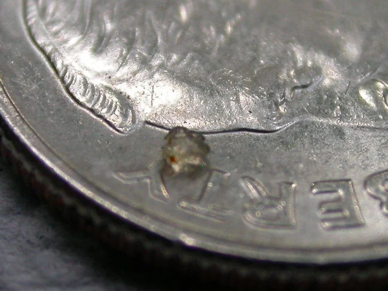

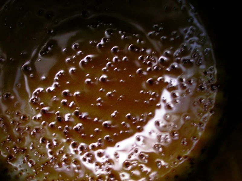

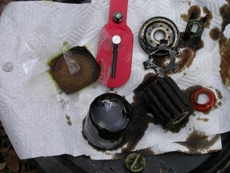

Anyway it was now at the top of the "to do" pile at the new place, did an oil change and cut this one along with my own, not sure it is of any use anymore but here are pictures anyway.

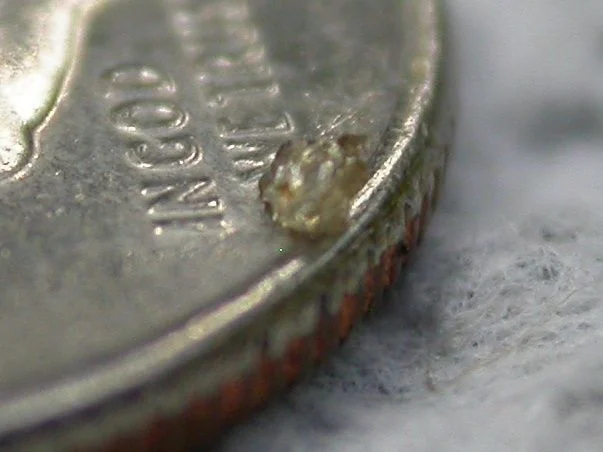

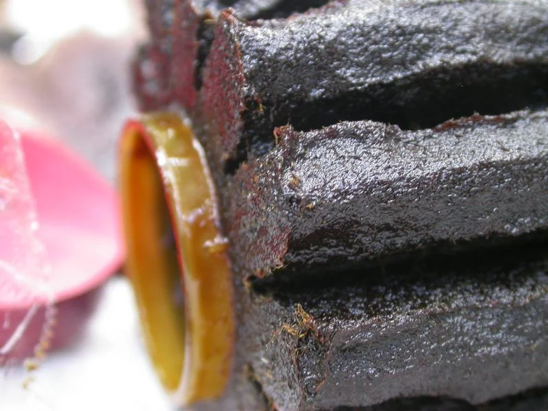

All I found was one bit of grit/sand (pictured on the dime) and some carbon in the end, completely normal.
Tiney bit of grit, looks like quartz?

15K? Nice, and no metal not even some random aluminum glitter,
Been running 10K OCI's for a while now I have been thinking about going further,
