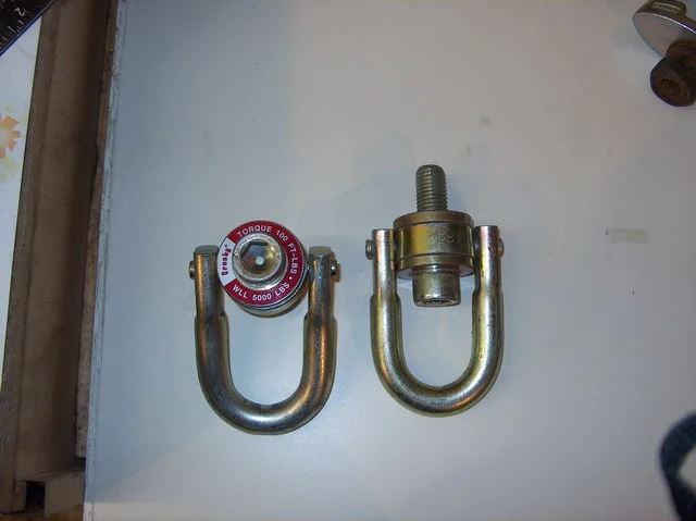

The Crosby ones are expensive but a non Crosby 3/4" 5000# WLL one similar to the pictured Crosby but in black oxide finish can be had locally for under $100 a unit.

It sounds like the difference between recreational recovery gear rated by its breaking strength and industrial rigging/lifting gear with at rating the reflects at least a 5:1 safety factor based on the breaking strength might be something not clearly understood.
As already pointed out the 5000# is the WLL/SWL with at least a 5:1 safety factor built in so the minimum breaking strength on the ones in the picture is over 27,000#'s and they have been proof tested to over 12,000# and mag particle inspected by the manufacturer after the proof test.
Rated by the same standard the common 5/16" wire rope on most of our winches would have a WLL/SWL of under 2000# based on it's nominal breaking strength of under 10,000#'s.
Just to illustrate, one of these is rated at 20,000#'s and one is rated at 6,200#'s. Care to guess which is which and which style I actually use:
The 6,200# rated one has a minimum breaking strength of 31,000#'s:
