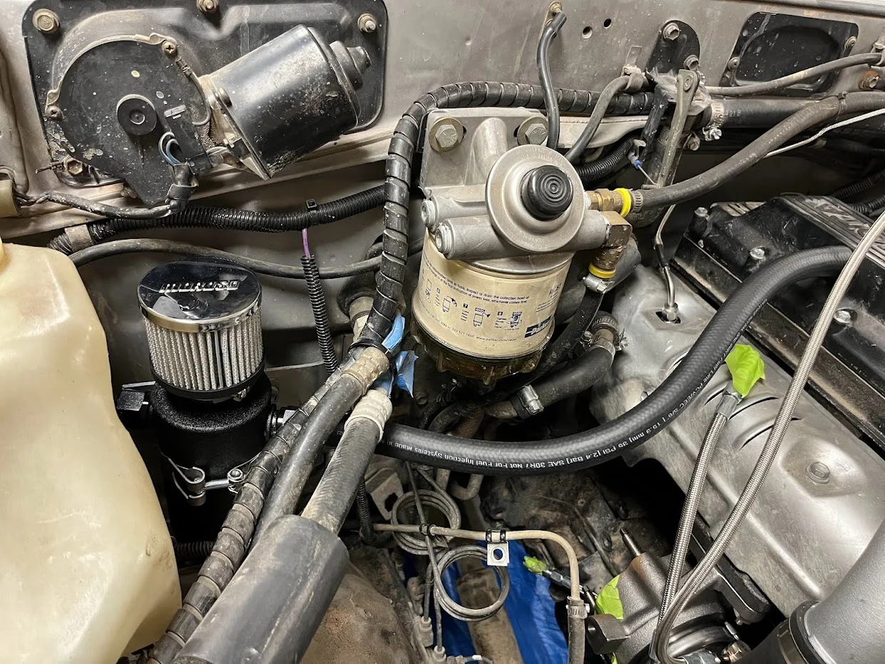

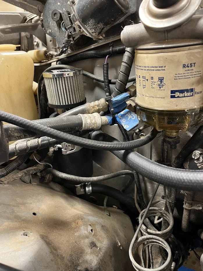

Yeah good to hear. Provent takes up too much room.
I bought a Provent at one point. Then gave it away to my friend with his cavernous HDJ81 engine bay. For the same reason; no room in my engine bay.
I take the edic rod off before deep crossings so that way its 100% mechanical engine, and if it stalls that deep its going up the exhaust and into the engine anyway.Unless you stall it in the middle of a river, and the cooling engine draws in air....
Never really heard of it being a problem though; so probably don't have to worry.
Ikarus, you and I have the same engine: if I want to vent to atmosphere, which line is it I should look for (I've deleted EGR)?If you know you’re going to be doing some big water crossings you could just temporarily vent it back into the intake like stock. I know some people have airboxes that they always close the drain on before doing a lot of water crossings. Like that, you could make it a habit offroad and then switch it back once you’re back on the road.
