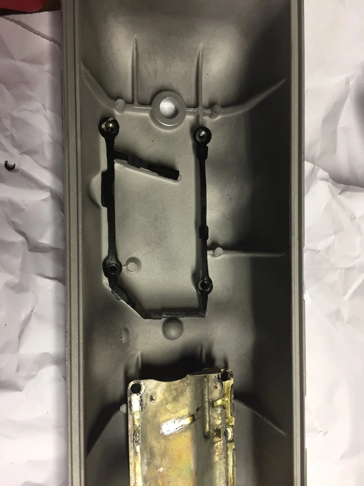

does anyone know where i can find a new Ventilation baffle gasket(for 1978 Fj40) which is located inside the valve cover
That isn't one we carry but I'll dig into it.
I never did find one so I purchased some good oil gasket material at Oreilly’s and carefully cut it with an exacto knife. I recall i went slow and used a couple of different blades to make sure it was sharpe and cut clean. turned out pretty good.
