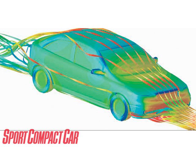

Has anyone taped string to the areas where you want to put the vent to see what airflow is doing at speed? For heat extraction to work the scoop needs to be in a low pressure area of the hood (area where air movement is the fastest). The base of the windshield is a high pressure area at speed and if the vent is too close to it then air will get pushed into the vent which would impact radiator efficiency.
In these pictures the Subaru scoop seems like it would be ok but the the louvered vents look very close to where the high pressure area would be.
Not a truck but a good diagram of high and low air pressure at speed.
