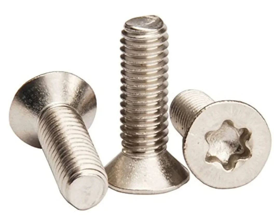

To replace the original JIS/Phillips, which tend to strip out/break...
I'd suggest trying to get them as Torx rather than Allen.
M6 Flat Head Torx Screws,Countersunk Head Torx Screws,Full Thread,Pack of 10-Piece (M6 x 12mm) https://www.amazon.com/dp/B07BS8CVD9?tag=ihco-20
Torx has a much larger footprint in the head of the screws vs Allen. Better leverage on the screw, and less likely to strip out.
Stainless fasteners are usually soft. Probably better to find zinc
