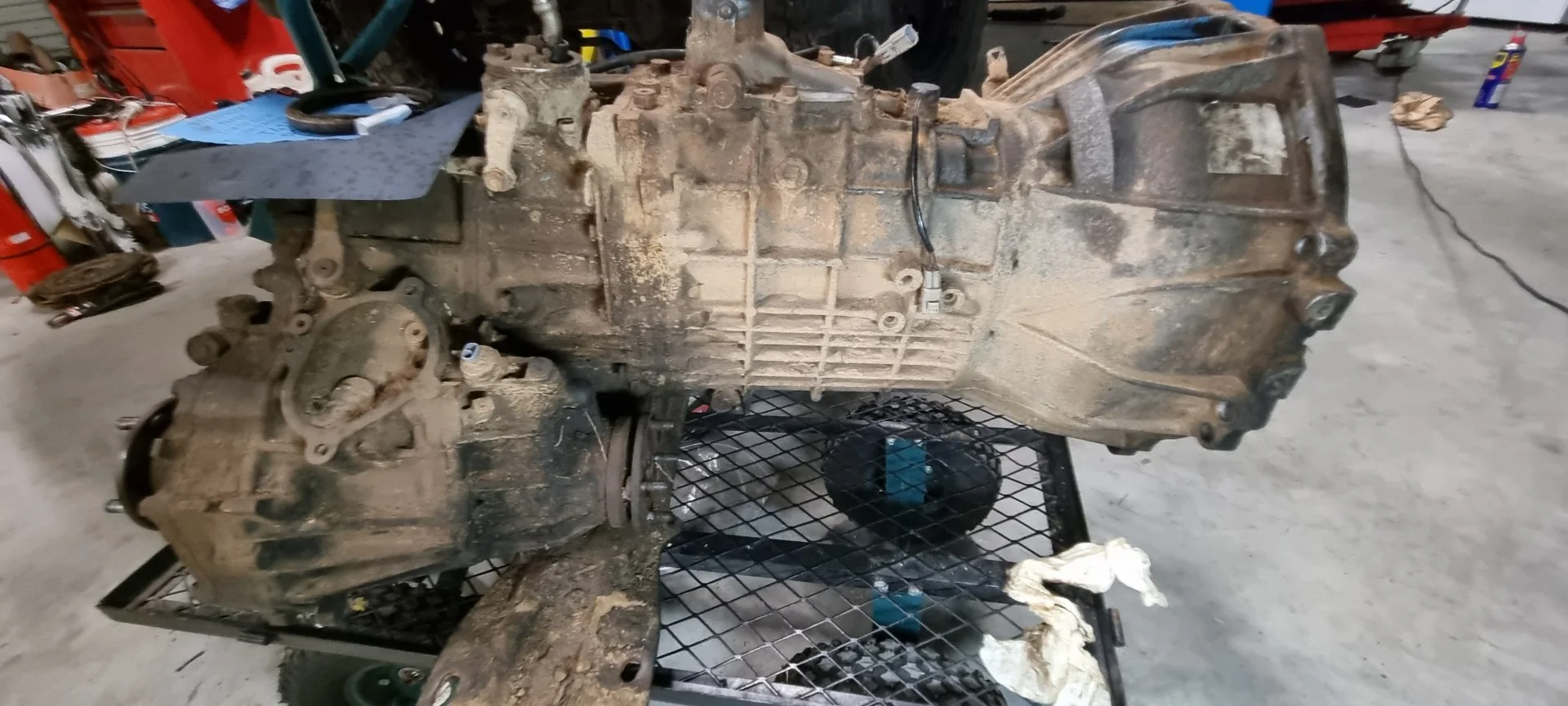

I have a 91/92 model hzj80...
On the firewall, says its a h150f, from wat I can make, it's actually a hdj box...unless, someone has done the input shift exchange and watever else, failing taking both boxes to a box shop, any ideas how I could identify and differentiate between them?
Put in first gear and count the revolutions.
Also, there isn’t much difference between a H151 and H150 apart from slightly shorter first and second gears for the H150 box which is actually an advantage off-road. It was the 1HZ in the 100/105 series that got the s***ty R151 (or maybe R150) box that should be avoided. If you are wanting to do a swap it should be fine…
In the 60 series box there were different splines for diesel vs petrol, but not on the 80
There were 2 noticeable differences between these 2 boxes, one, the bell housing, slightly different and also one is longer/shorter then the other, by about 10 mm
Also the input spline, although looking very much the same, wouldn't allow the new spigot bearing to fit, albeit, I have since found out I was sold the wrong clutch kit, but, also, wen trying to fit my old spigot bearing, to see if there was a difference, it would slip back over the old shift, but not the other, newer box? Which has me thinking, my original box, being for a diesel, maybe the other box was for a petrol? If so, is unusable for transmission swap?
