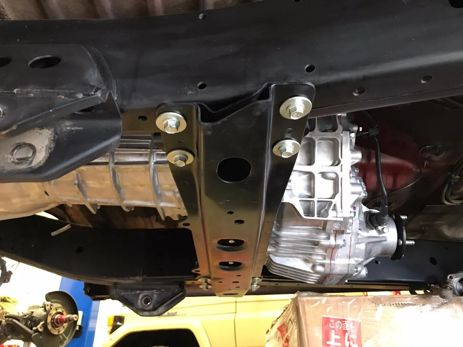

HDJ80 H151F into HZJ78 R151F 2001?
Since I do not have the opportunity to change the gearbox myself, I have a mechanic on that job.
Previously, switched from, 1HZ to 1HD FT engine.
The R151F failed. Splines between gearbox and xfer were striped. of.
The mechanic says there is no room for the H151F instead of the R151F. He says there is no room for the bottom of the cabin.
Raising the cabin above the chassis is not an option.
Has Toyota made more room to mount the H151F?
Problem with regular mechanics is they don’t know the ins and outs of various landcruiser models, gearbox’s and engines - they’re not swapping this stuff every day just fixing. He’s wrong about there not being room - ask him how it fits in an hdj78 (same gearbox essentially as the 80 series one), the body is the same. Only issue is the stick is in a fractionally different spot so you need to cut the steel tunnel a bit.
Only issue is the TC. I don’t know how that ancient (60 series) TC adapts to the H15* box... every other cruiser I’m aware of that uses an H15* box uses a different transfer.
I have done pretty much this exact swap though - it was in an hzj79 (same body forward of behind the front doors). All went very smoothly, but I got a low km box with TC (off a vdj79) from a wrecker so didn’t have to muck around with it it all bolted straight in. Just used the hdj79 rubber mount
As others say, it absolutely fits. 80’s came with H150/151 and the H152 is the same size only internals changed.
The shifter is different 78/79 to 80 though. The 80 has a bit of a bend in it while the 79 shifter is straight.
