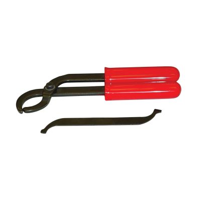

Adjusting the valves is a good idea. Be aware it takes a special tool to extract the shims out of the buckets under the cam. Looks like this:
You can find these on eBay all the time. You can get the shims out with a prybar and magnet, but it takes 2 people and it's kinda difficult.
You also need a good set of feelers, and a good micrometer, and hopefully a dealer close by with a good selection of the shims in stock. The FSM shows how to do it, with a big table where you can lookup which shim to get based on how far out the valve is from spec.
PITA.
