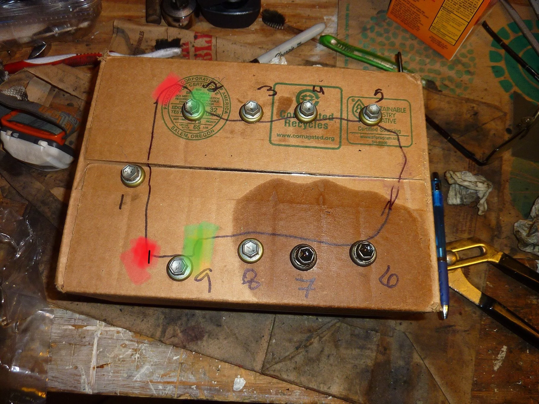

Wasn't my photo... but I can answer. Per the FSM, you only need it at the front corners (near 2 and 9 on the outline above) There is a sharp corner where the flat part of the gasket turns up 90 degrees to go around the cam covers at the front of the head. Just put a tiny dab of it there in those corners.

Hi, do you mean you put a small dab on the front of drivers side cover where i highlighted in red? Or highlighted in green?
Is it the same on the passenger side?
Thanks!
Thanks!
According to the videos I've watched and what I've red, its the area highlighted in red
Thanks!
You are correct, it's the area you highlighted in red in your drawing. There is a 90 degree bend upward there, dab a little in the "V' of the bend.
I was the original poster for that photo and on my 98 it was on both the red and green spots. Only the red spots are shown in the FSM (page EM-66) but I was matching what was on mine (presumably from factory). I also ran a fine finger tip bead post install along the very back outside edge of the valve (cylinder head) cover.

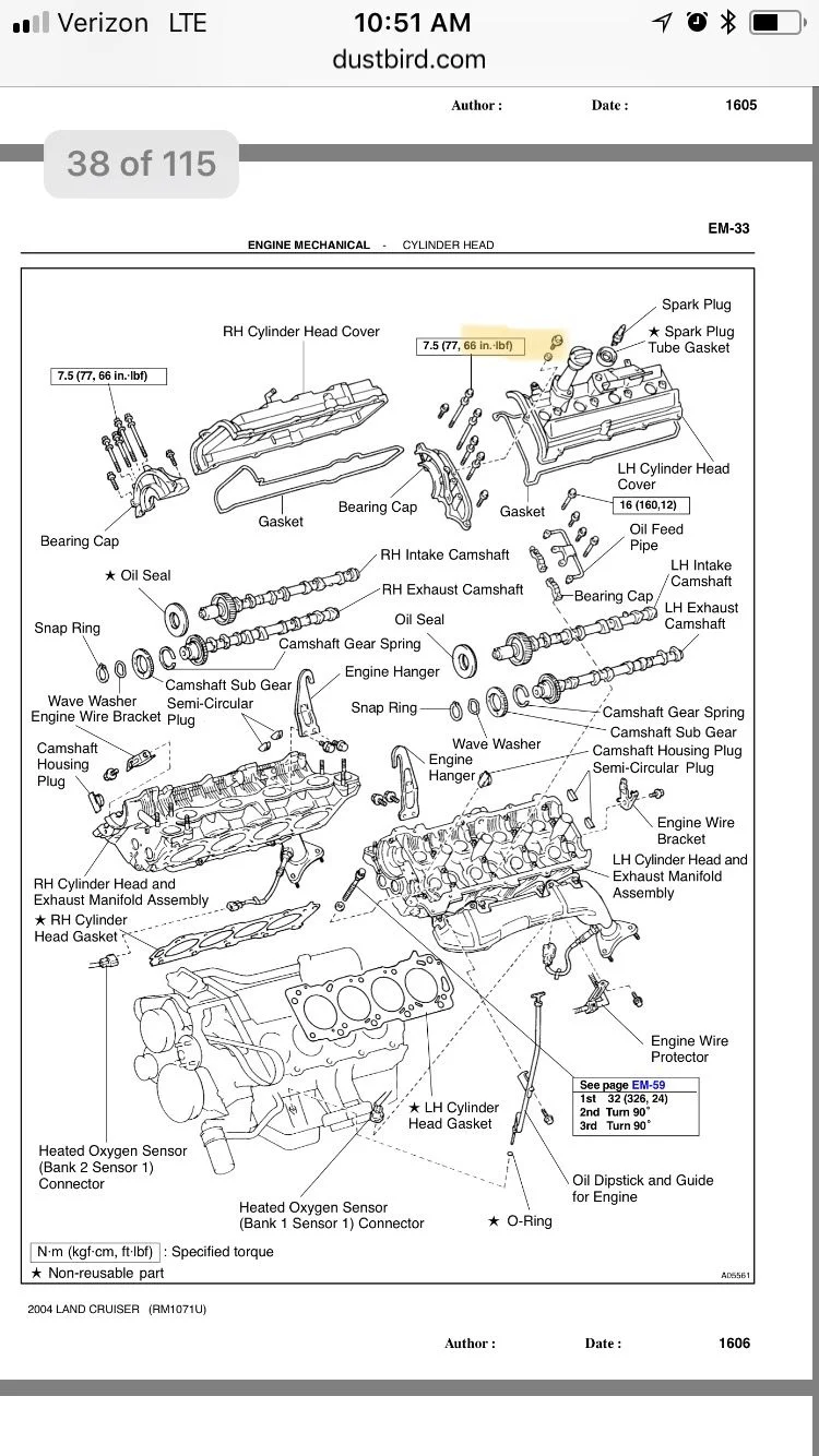

According to the fsm the valve cover bolts need to be 66 in.lbf which is 5.5 ft lbf.
I had a torque screwdriver that went up to 40 in.lbf so I used that and gave it about half a turn more til I felt it snug.
Wondering should torque them down more?
Maybe a little locktite?? Or is that a bad idea? I would think it would be better than over-torquing them...based on all of the loose valve cover bolts, a little locktite might help.....?
No
The reason people report the bolts coming loose is because the gasket dries out and shrinks.
If you over torque the bolts they can break off.
The bolts really only need to be snug and they should be good for another 10 years.
I'm getting ready to do this, so thought I would add a little to the tech on this.
Details from the FSM (EM-67), including exactly where to apply FIPG shown below. Many people seem to skip step 10 if they are not leaking. Seems to me like an easy "while you're in there and the tube of FIPG is out" kind of a thing though. YMMV.
Note that the torque spec for the valve cover bolts is 53 INCH-lbf. (NOT ft-lbf)
The torque spec listed a few posts above is actually for the bearing cap and not the valve cover.
