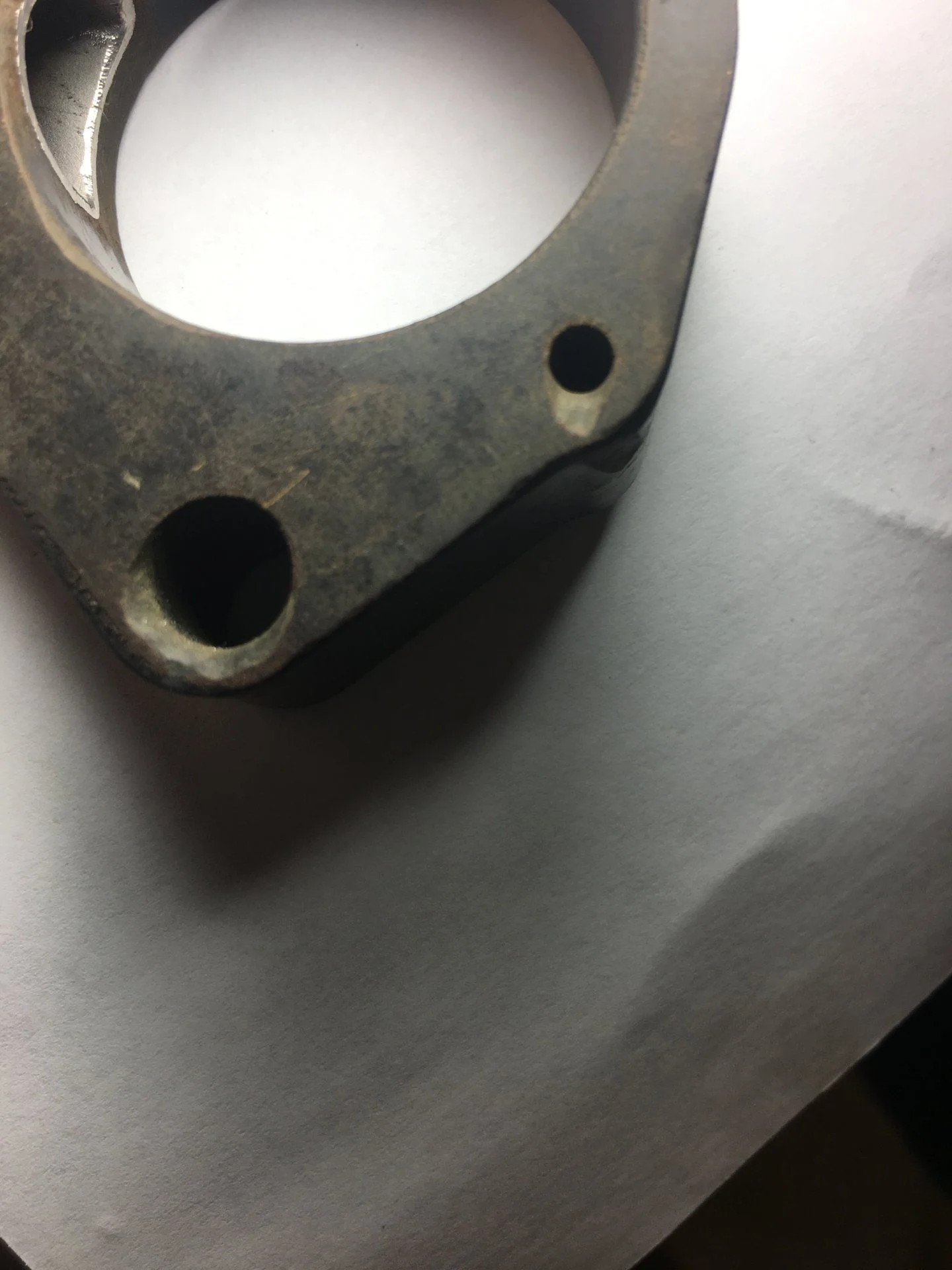

I've often used this site to help answer mysteries and so I thought I'd pay it forward and offer my insight into a vacuum leak that plagued me for several months, until the solution appeared. When I first started to go through the basic tune up portion of the project I had a persistent rough idle situation (failed CO emission test) which was not phased by 4 carb rebuilds, fuel solenoid replacement, timing adjustments, electrical system checks and numerous other refurbishments. I really felt I had left no stone unturned but knew it must be a carb related issue so I began the fifth tear down of the carb and noticed some peculiar gouges around many of the holes in the phenolic block between the carb and intake manifold. These gouges were somehow formed over time and were creating a vacuum situation at idle but as RPM's increased the problem subsided, likely overcome by increased air volume.
I JB welded the gouges, filed it smooth and flat, problem solved.
Lesson learned and emissions test passed. I hope this might offer one more solution option for someone having similar issues.
