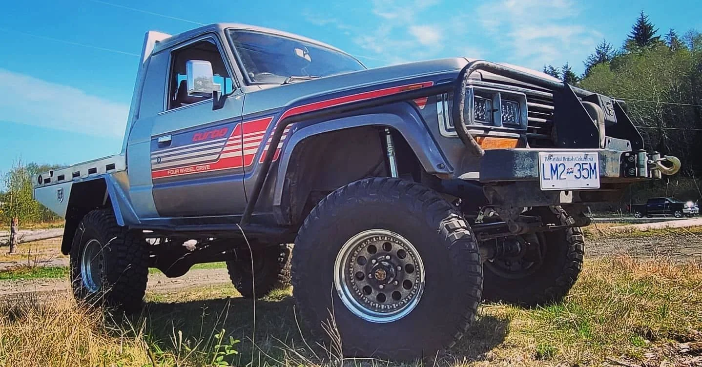

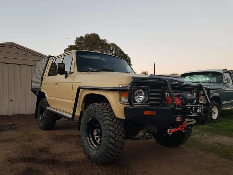

After 4 long months of waiting and I can't believe my eyes, the Dirty 30 build is complete!
Jeremy Browne of MtnGhst Metalworks Ltd and his amazing girlfriend Ashley Tapp have gone above and beyond making this dream come true.
A lot of work went into this Cruiser with some hurdles to over come. Some of the mods include...

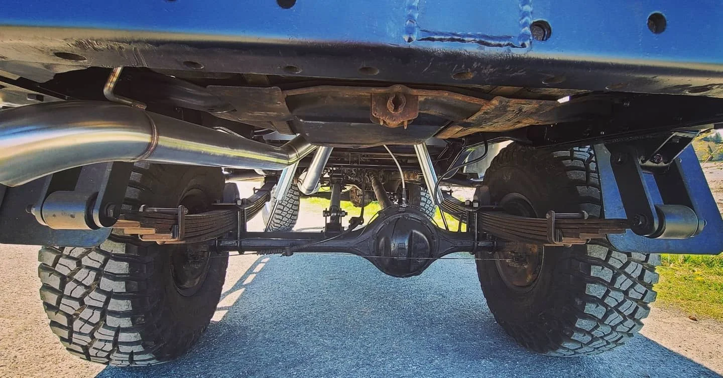

- Spring over lift
- Anti wrap bar
- Body work
- Custom tray
- Shock tower mounts front and rear
- 3 inch stainless exhaust
- Front and rear axel rebuild
- Frame repair
The biggest thing is that this truck is 100% road legal. A structural and mechanical inspection had to be completed to change the classification from Wagon to pick-up.
Thanks to Radd Cruisers 4WD Ltd. , EBI Cruisers and 4 Wheel Auto Wholesale . If it wasn't for these 3 specialty Cruiser shops, this build would have never happened.
Special thanks to Jeremy Browne, Ashley Tapp and Petra Sinclair, you 3 are the best.
Follow me on Instagram for more updates on the cruiser. A lot more to come.
📸Land_bruiser60

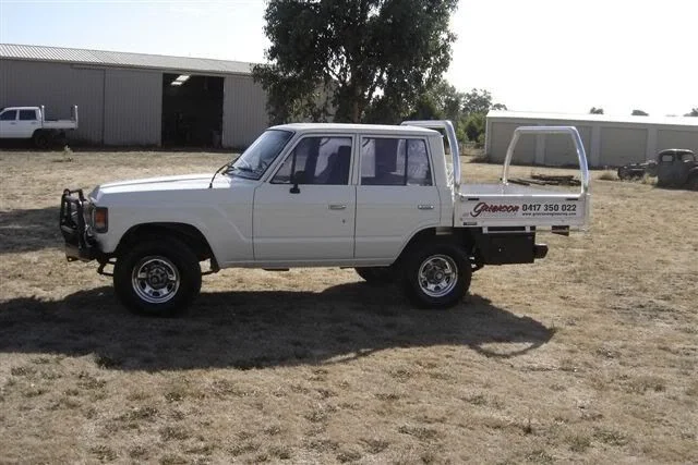

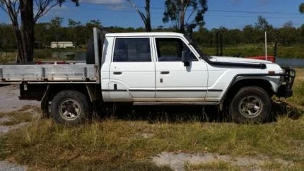

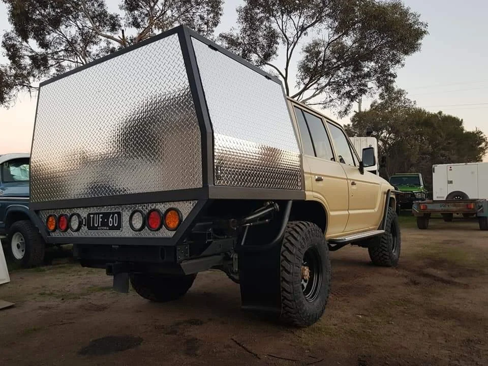

You should not sure is you're on Facebook but there's a chopped 60 Australian group with a really sick looking 4 door 6p ute.
Are you going to do the work yourself?

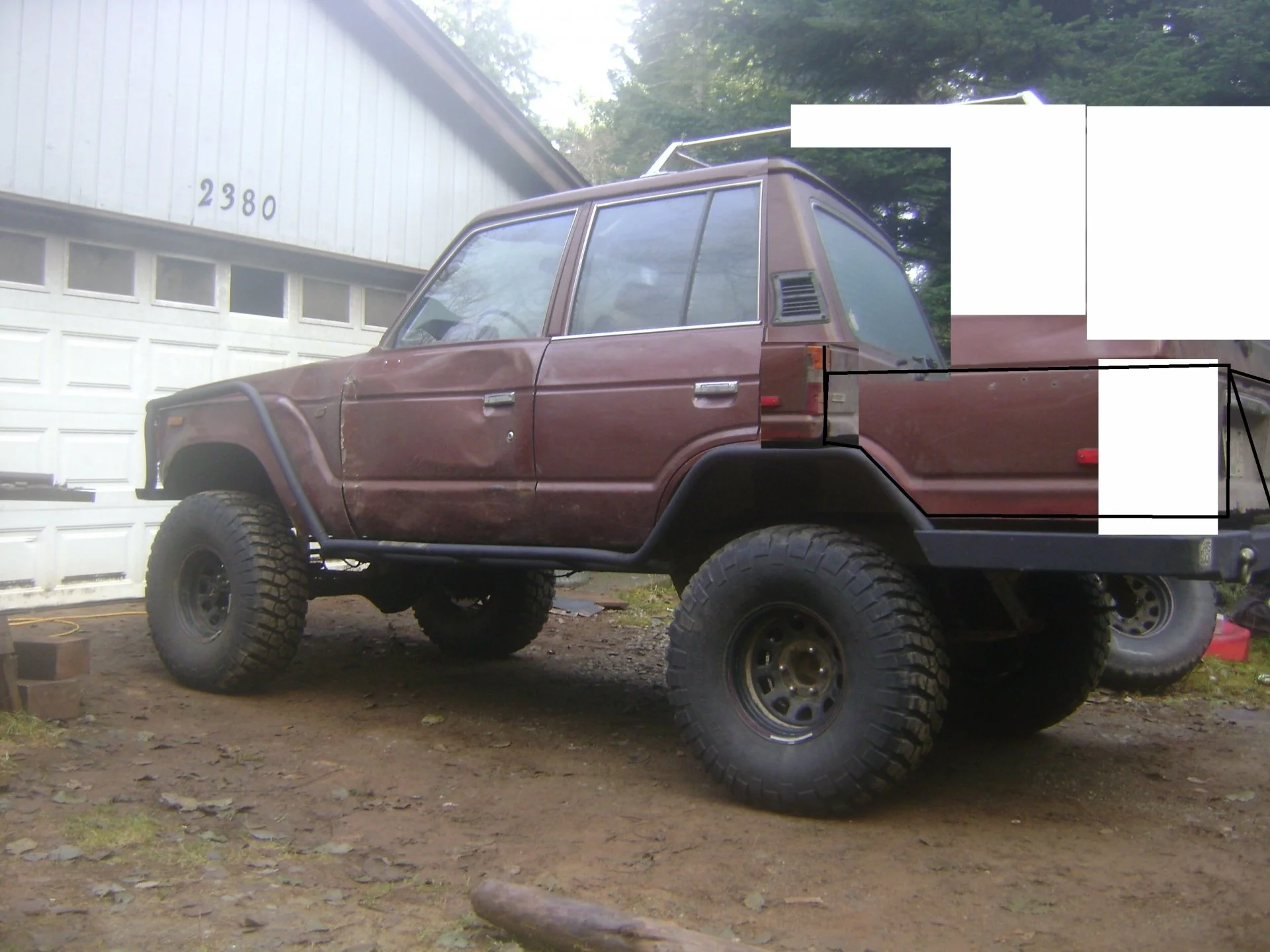

I saved these pics years ago when I was thinking about chopping mine.
The longer version that's squared off under the back doors looks better.
A lot more work with the frame I think for that length of wheelbase
There's a couple nice looking 4 doors that don't have the frame extension. If you're worried about your wheel track what you could do is put the Chevy 63s in and don't change the front spring mount. It'll kick your rear axel back by 5 inches I believe.
Here's a few builds that are on that Facebook group.

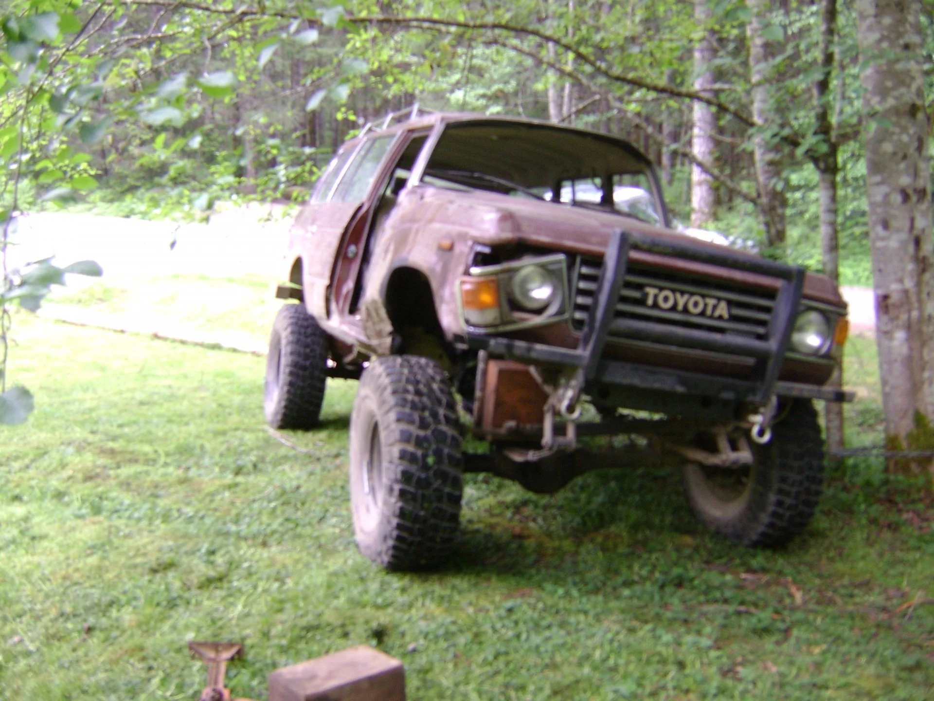

It'd be hard to get rid of a decent diesel cruiser these days when it would be so hard to replace. I actually bought my 61 as a donor for the green 40 thing, but then could never bring myself to kill it.

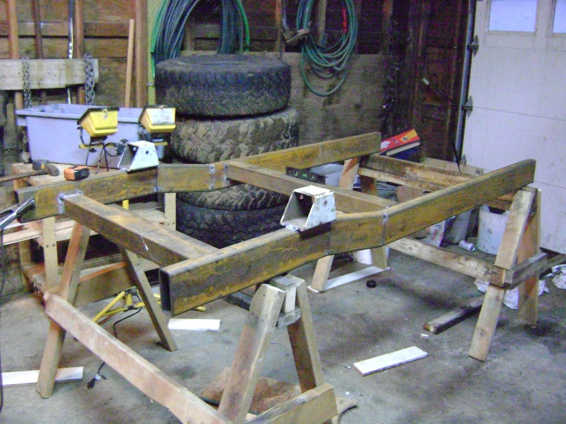

Well I already have a 2"x5" rear frame replacement so extending the frame would be a breeze. My truck almost holds no value in the cruiser world. Unless you think you can sell a New york whore for top dollar? I am in need of a new project.
