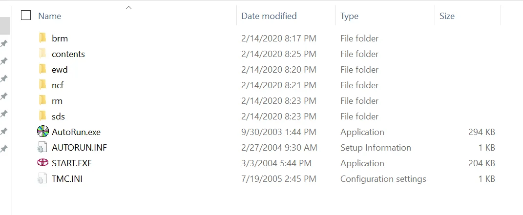

Step 1: Copy CD contents to a folder of your choice. It should look similar to below
Step 2: Open "Contents" folder

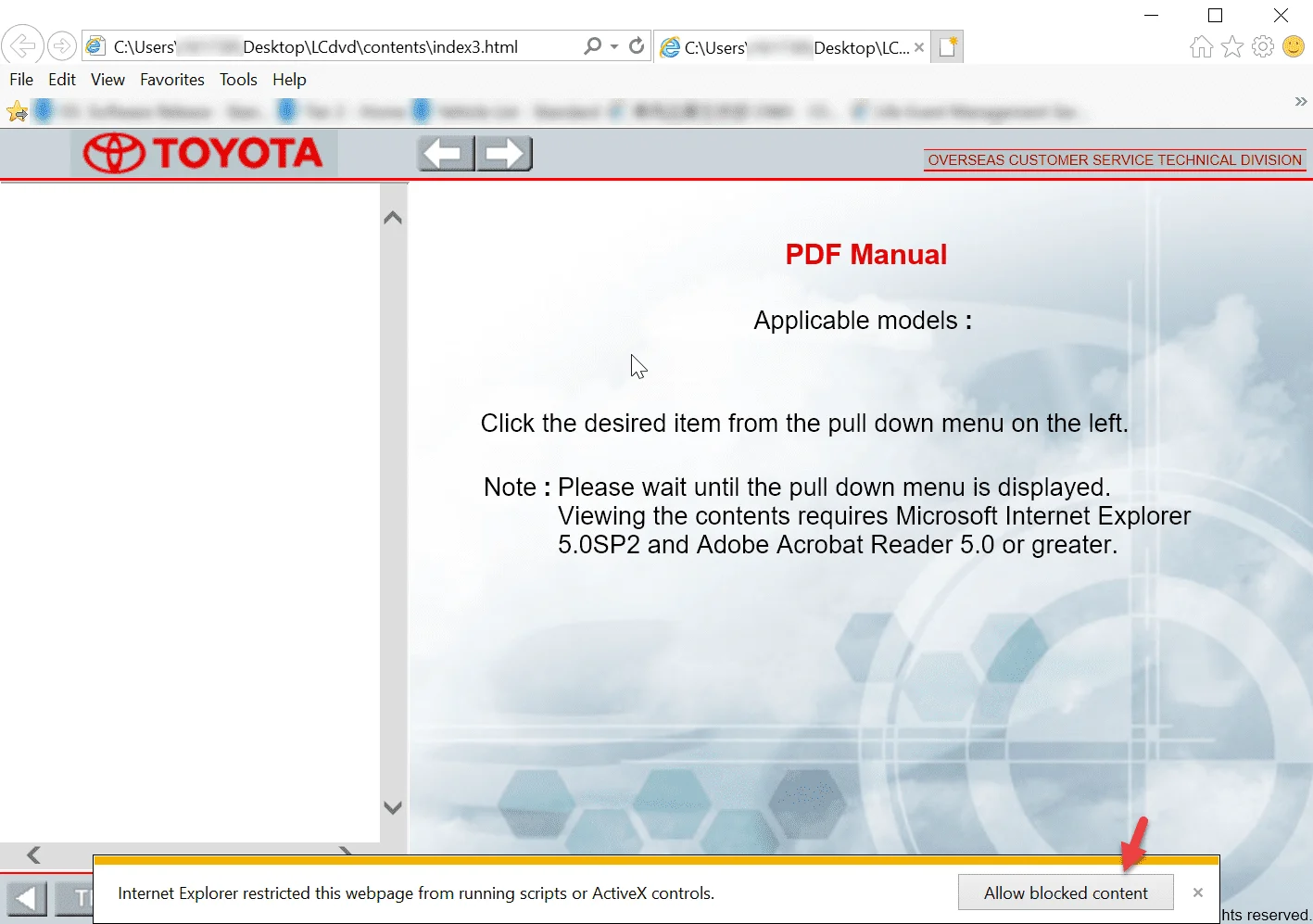

Step 3: Double Click "Index3.html"
Step 4: Allow Blocked content

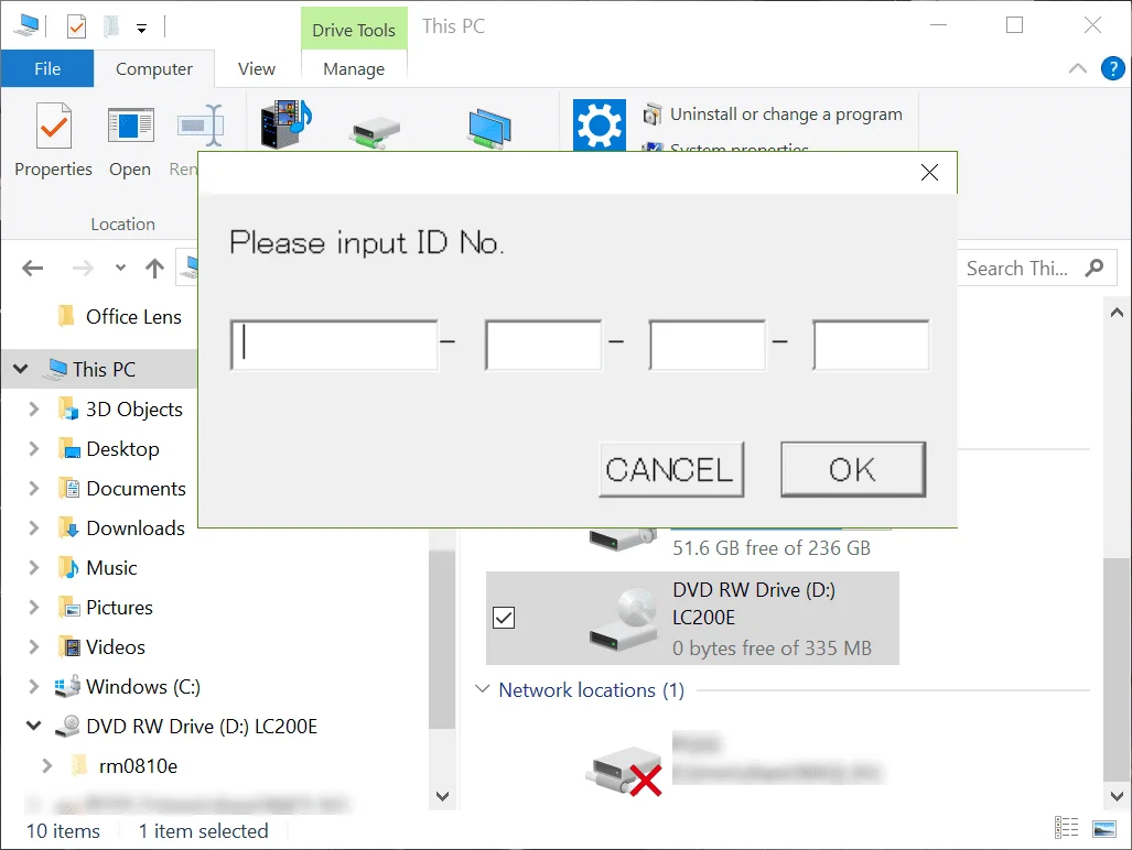

OK about the serial, if you open the CD from the "PC" screen (where you see your other disk drives) it will ask for the serial rather than the contents. However, if you select from the side bar navigation, it simply opens up the CD to show the contents, no serial needed.

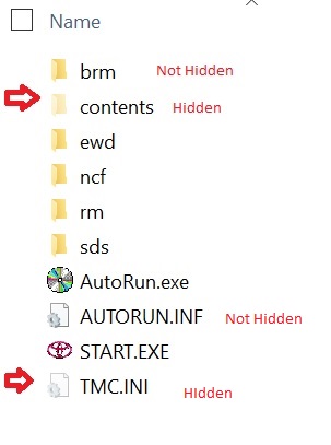

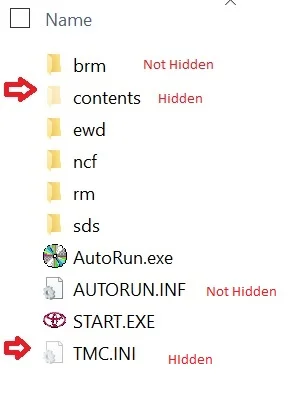

From your images... a lot of these files are hidden.
Anyone looking for the "Contents", folder would want to make sure they set their view settings to show "hidden files and folders.".
You can tell from the images where the folder is more opaque.
Thank you! That is a key setting, I’ll have to add that to the begging of the post. One of my first setting changes on a computer for me so I totally spaced it!
