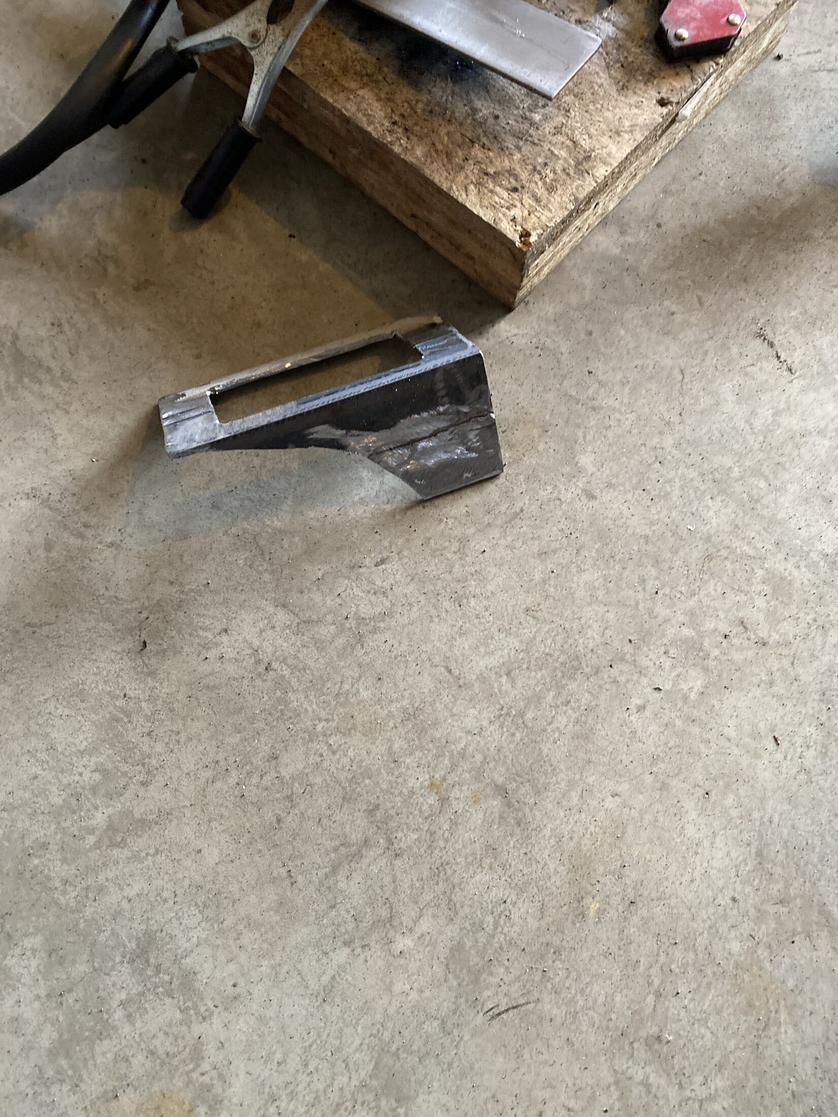

Here’s what I did, I made a bracket to support the cable and hand brake on the transmission tunnel. Its close to the heater but is totally useable. I had previously swapped in axles from an 81, I now have a fully float rear axle and continued to use this set up.

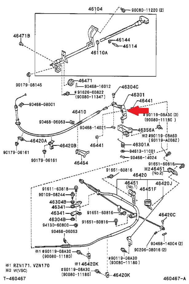

I am working on solving this exact problem on my FJ40 . I am in the process of adding later model drums with integrated park brake to my rear axle using adapters from @cruisermatt . My plan so far is to use a bellcrank and other bits from a 96-2004 Tacoma (model RZN161L-TRMDKAB). The piece I am missing is the cable that will go from the dash pull handle to the bell crank. The current cable that goes to the transfer case park brake will not work because the end will not work with the bellcrank. I either need to find a way to modify the cable end or get a different cable.
Here is the parts diagram.

Maybe we can make an adapter piece? It would be really nice to use the stock 40 cable.
That would definitely be preferable.

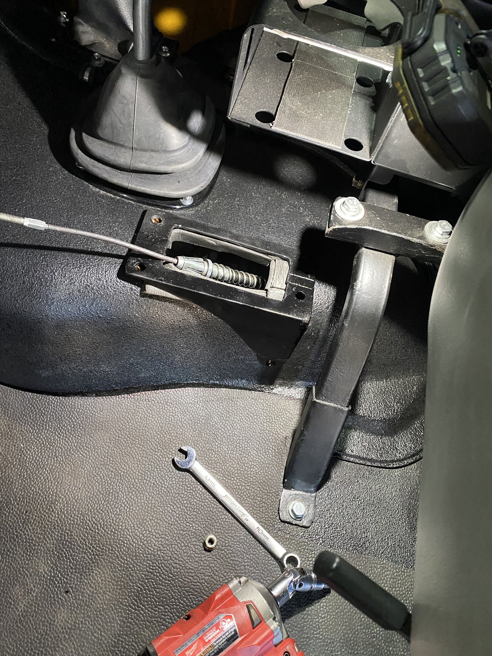

On thing that came to mind was cutting the end of the 40 cable off and crimping the appropriate size eyelet onto the cable which could then connect to the bell crank with a pin.
Something like this
