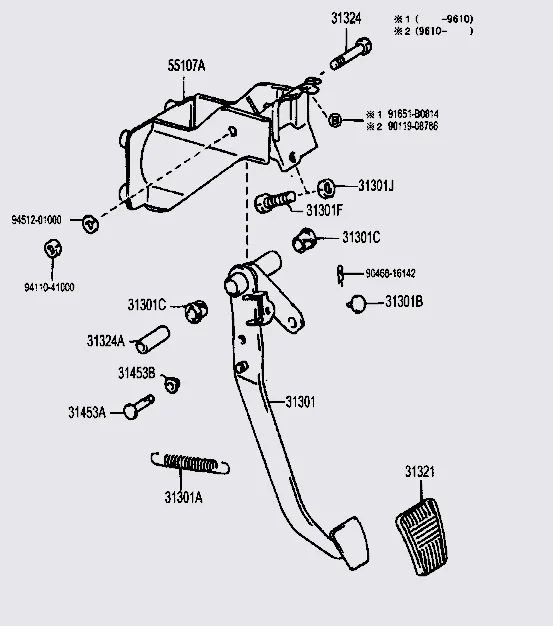

Then you will need a clutch pedal bucket and bracket, you will need the hard lines going from the clutch master to the clutch slave cylinder. The hard lines are discontinued. The pedal bucket and the bracket might still be available. And of course all of the little bits and pieces.

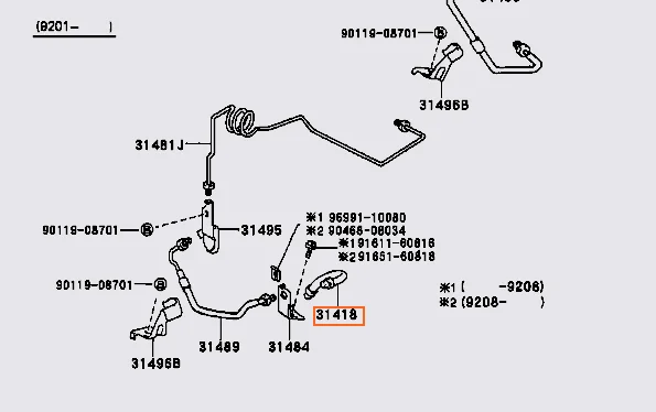

Clutch Slave soft line: 96812-50205

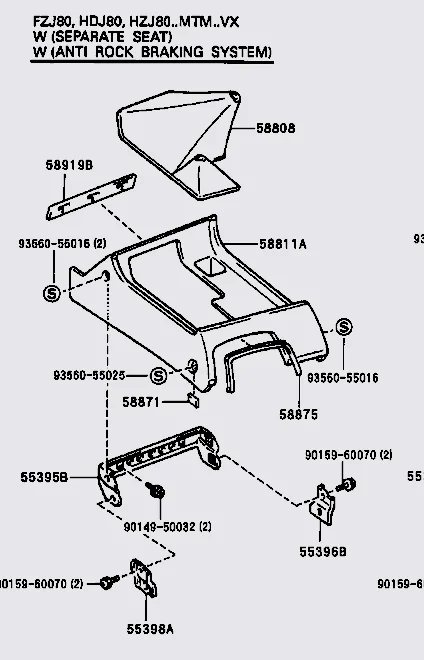

Then you are going to need to get the center console parts (most of which are discontinued unfortunately):
The boot is available: 58808-60060-C0
Shift knob: 33504-60130-C0
Shift lever: 33530-60202
Shift lever boots for xfer/tranny at floor: 58280-60041
Floor bracket: 58123-60010

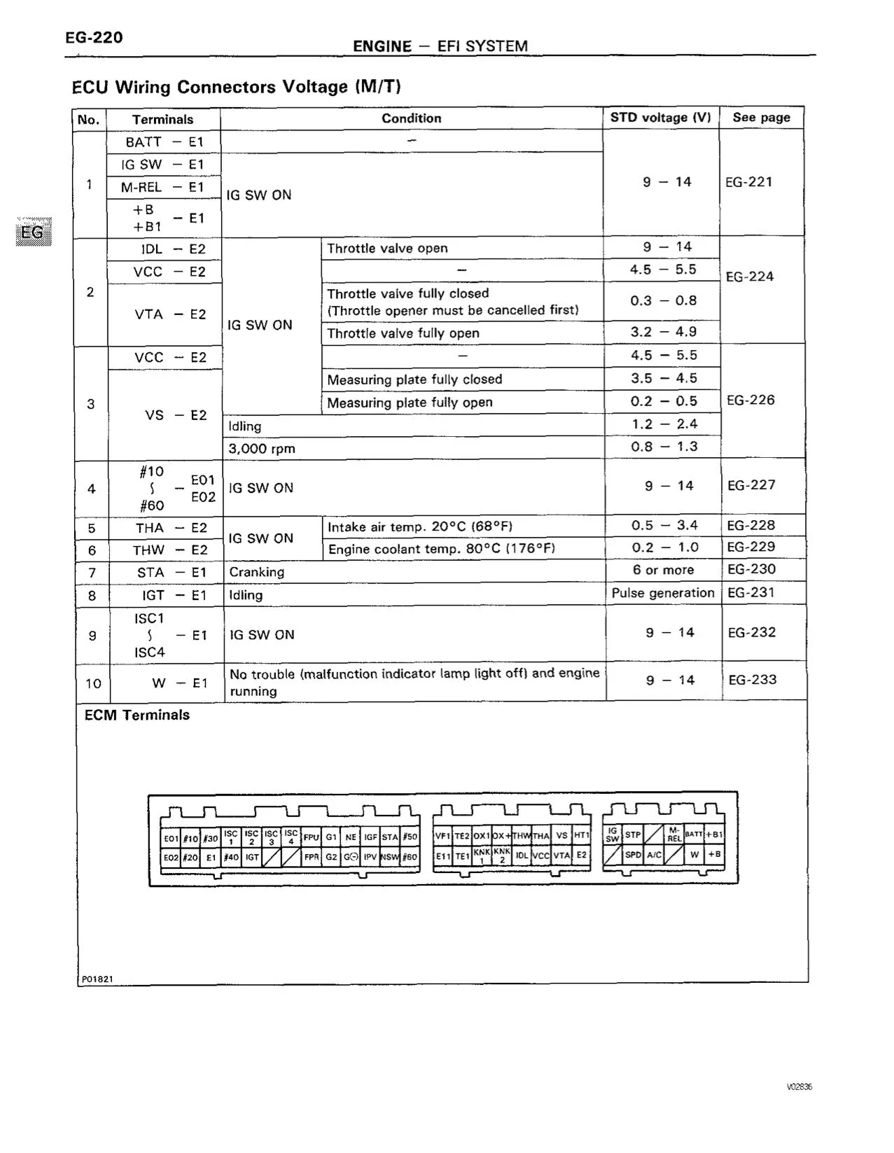

I have a obd1 1fz m/t ecu but had a hard time fidning a wiring diagram for it, I did find a pinout diagram that I believe to be correct but I never tried working with it.

I happen to have a 1992 J80 EWD, in my stash of 80-series general market EWD's.
Anything particular you're looking for?

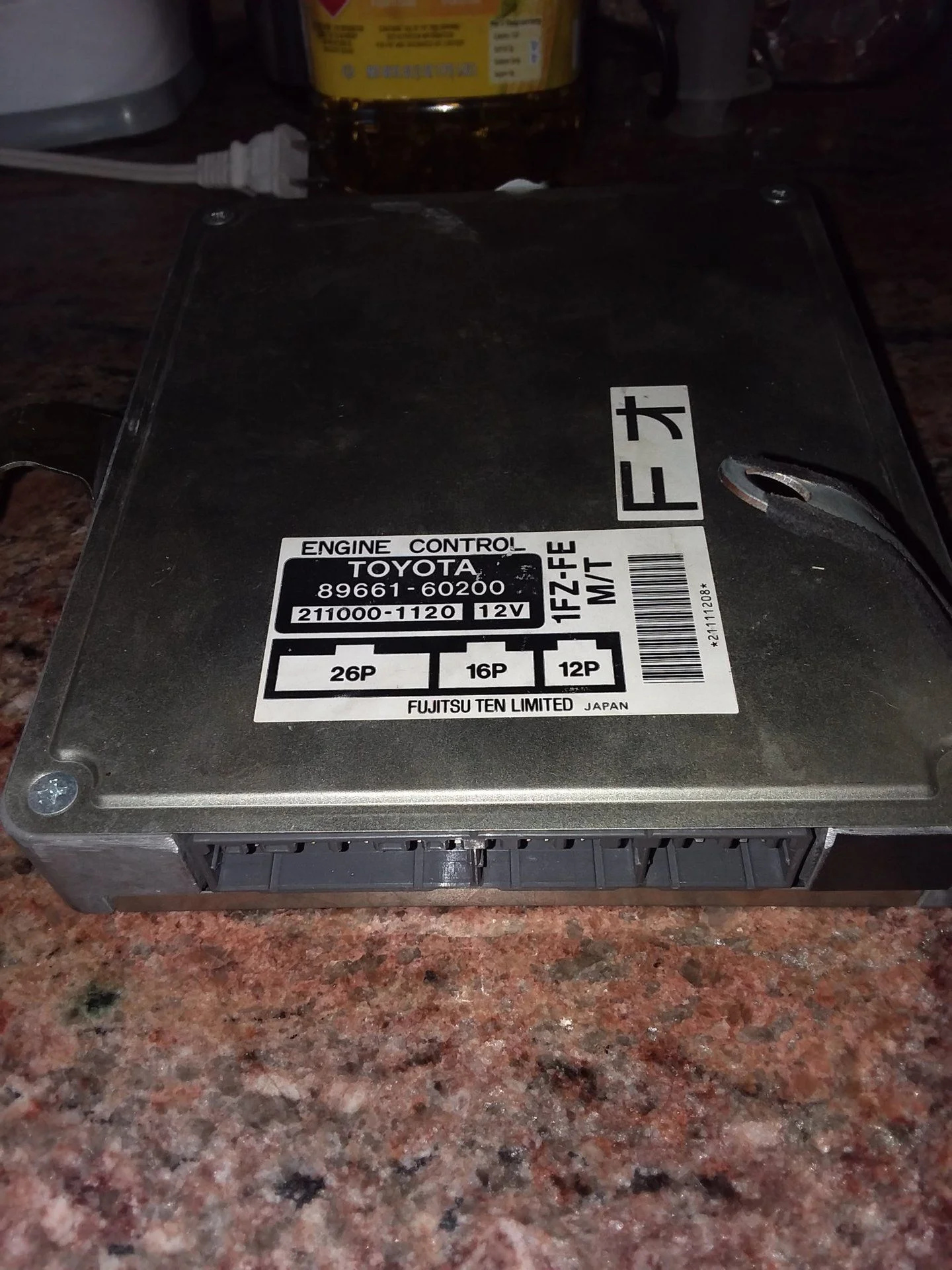

I have what I believe to be a OBD1 1FZFE M/T ECU that I scored from ebay australia. These are the pictures I have on file.
At one point I was just going to do a h151 swap and keep the 1FZ motor, but I really like the diesel efficiency. I never actually found a complete wiring diagram, just the pinout above.
Same as the one I have. I did notice the 3rd connector on the right when looking at it like you have pictured is a different physical connector than the A/T US spec rigs came with.

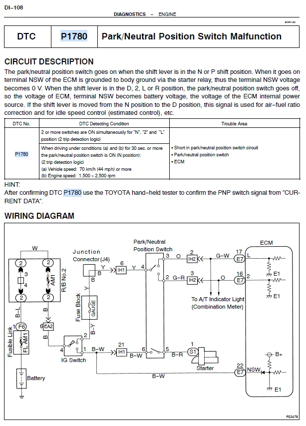

On the electrical diagram for the ELECTRONICALLY CONTROLLED TRANSMISSION, the neutral signal from the PNP switch seems as if it's not used by the ECU, but in fact it is - it is the NSW wire on pin 22 of E7 connector and is a +12v signal directly from the ignition key and has nothing to do with the PNP switch on the side of the transmission.
One very helpful table about the behavior of the AT, is the table that shows electrical signal combinations that tell the ECU what gear it is asked to activate. What I found was that the ECU judges that the car is in NEUTRAL when no +12v signal is sent to either of the three gears (R, 2 and L) and the NSW pin 22 on the E7 connector. Simply removing pin 22 from the connector to prevent the +12v signal from reaching the ECU, isn't enough to make the ECU think that the AT is in neutral.
From another Toyota document (in the description for the DTC 1780 for ENGINE diagnostics, not ECT diag), we found that that same signal on PIN 22 of the E7 connector, is in-fact dual signal pin. When the car is driven, it receives +12v, but when the car is in NEUTRAL, +12v is cutoff and it is grounded thru the starter circuit (Pin 11 of E7 is also grounded thru this wire). So either you have to depin the original wire and attach a different wire with a pin and splice the other end of the wire into the ground wire of the ECU, or you have to bridge pin 5 and 6 to be in NEUTRAL. If you want you can remove the speed sensor signal number 1 (back of transfer case) from the ECU connector (pin 8 of E7) and viola - no more CHECK LAMP!
