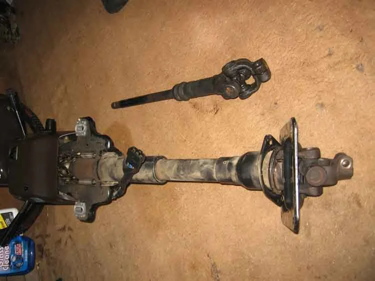

wow, the Cruiser Gods have spoken! thanks, here's a picture of what i have so far. i'll go ahead and unbolt the lower joint and pull the entire shaft out. thanks.
nevermind, couldn't get the pic to load. thanks.:beer:

thanks! much easier to pull the entire steering assy out all at once. for anybody else doing this, i'd suggest to unplug all wiring harnesses before removing the bolts that hold the steering column in place. There are 3 plugs total that need to be disconnected. Two are right under the steering column, the other is a separate set of wires slightly behind this mess. Also, I didn't mark my orientation correctly so I'm going to have to figure out the best way to realign my steering wheel once its all done. Any ideas?
