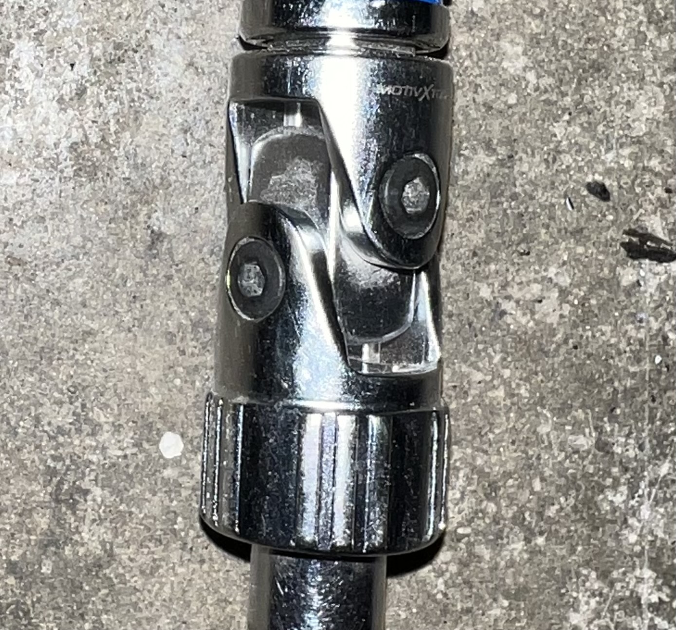

This little thing from MotiveX that has a spring loaded flex joint made it easy to do solo. It came in a set if three sizes and was silly expensive (Christmas gift), but is so much better than other ways of making a regular one less floppy (o-rings, electrical tape, etc.).
