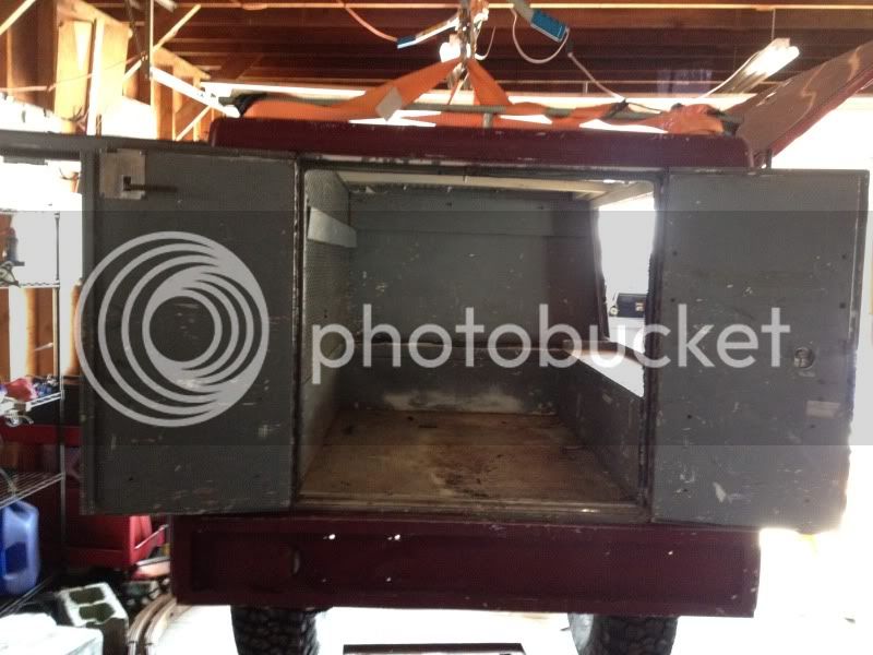

So I mysteriously hurt my knee last week. No specific instance of injury, but swollen to the point where I couldn't walk normal and certainly couldn't work as well.
9 days later I'm back at it, light duty but at least it got me into the garage.
I used a few come alongs and brought the utility body high enough so I could slide the new shoes underneath.
From there I measured inside rim to inside rim and got a measure of 52''.
Still looking into it but I think the adapters I need come in 1.5 inches x 2 gives me 3 inches.
49 inches is the magic axle length. Will order it with electric brake and e brake.
Will shoot for 5,200 pound axle. As some mentioned earlier if you use the 3 inch diameter axle it seems to up the weight capacity.
The only down part about using the same tire size as my rig is the overall height of the trailer.
I will also need to do some trimming to make the meats work.
Trailer height at the moment will be 77''. One reason it's so high is that I want to be comfortably able to step under the doors when they are open.
I want to have the RTT hang over so I can walk under it and use the add a room feature.
I'm not overly concerned about being top heavy because all the weight is down low and I don't think it will be a huge issue.
Plus once I fill the water tank and a possible aux fuel tank, it should offset any concern.
Enough with the chat, here are some pics.
