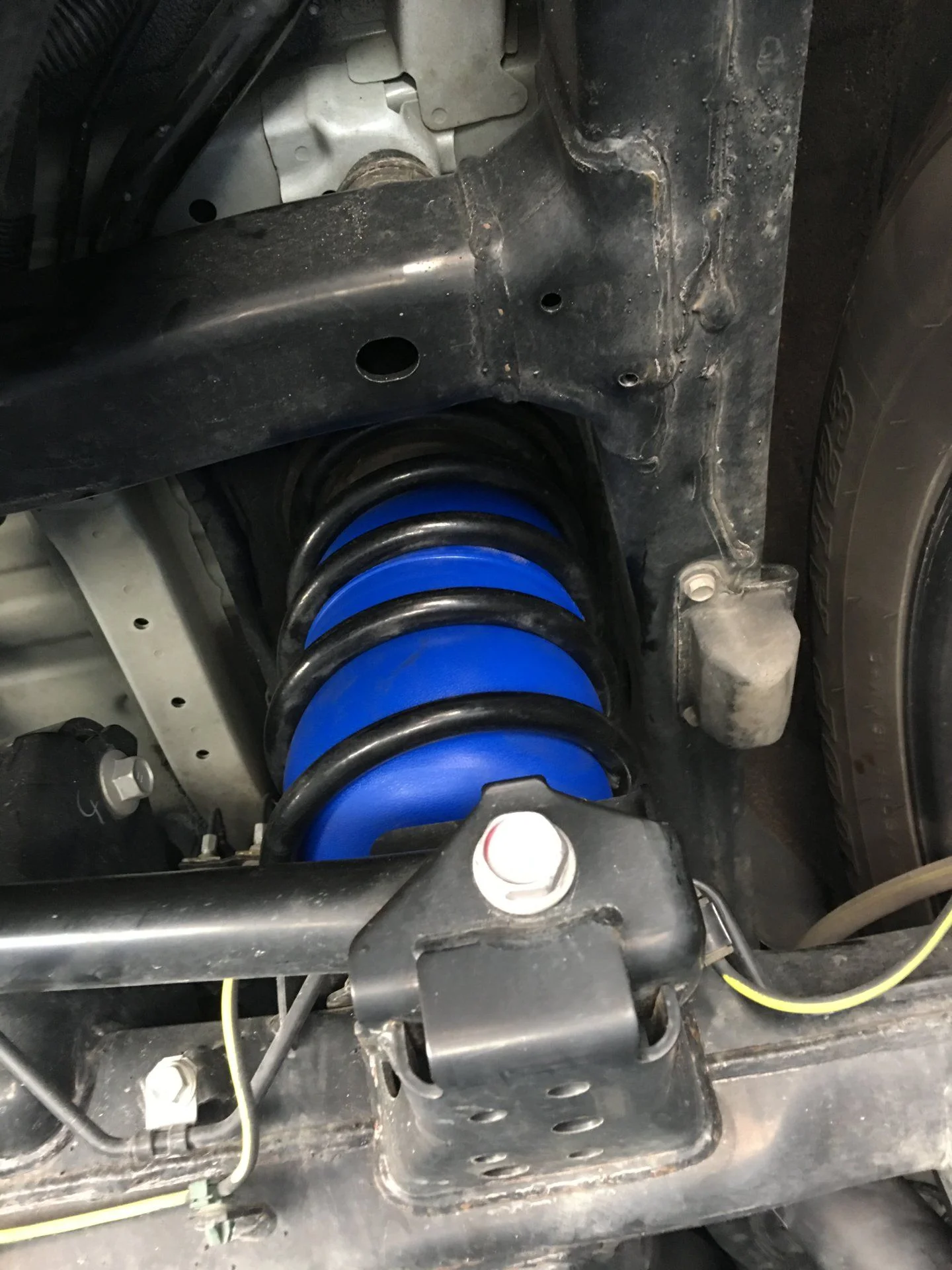

You need to buy a Firestone 4164 or 4129 kit. The 4164 kit is actually for the LC and is preferred if you already have a lift and haven't installed these before. The 4129 kit is (basically) the same, but the bags are 1" taller and can be used if you installed the 4164 kit on a stock truck previously. The rule is:
  • With the 4164 kit, cut off all 4 segments of the bump stop for trucks with NO lift.
  • With the 4164 kit, cut off 3 segments of the bump stop with a 1" lift. @Dan Higgins this is what you want to do
  • If like me you already cut off 4 segments of bump stops, you can buy the 4129 kit (which is for an 85 Buick), cut off all 4 segments of the bump stop with a 1" lift, and throw away the clamps and plastic spacer.
As far as the installation goes, any reputable shop could do it. The installation takes about 2 hours. The shop simply does the following:
  • Remove the springs as if you were swapping them.
  • Remove the rubber jounce stop from the top of the spring
  • Use a sawzall to cut off 3 of the 4 segments
  • Use a file to de-burr the hole in the center and any rough edges from the cut
  • Put the bag into the spring, fitting side up. Put the (now shortened) jounce stop back in the top of the spring
  • Run the air lines from somewhere in the cabin (or wherever you want to mount a compressor or just the tire/schraeder valve) along the frame and zip tie them securely.
  • Feed the air lines over the top of the spring perch and down into the spring area.
  • Reinstall the springs. As you do, feed the air line through the center hole in the jounce stop and push it into the fitting in the air bag
  • Inflate the bags and make sure they don't leak
If you're close to Slee and they can do it, I would take it there because they are trustworthy. If you're not, but you have a reputable local mechanic who is willing to give it a shot, there's a video at LandCruiser - Firestone coil-rite airbags - Project 200 which shows how to do this. Honestly the hardest part IMO is getting the PS side spring in and out - it's really a 2 person job (one to push down on a ~4' prying bar, the other to slide the spring in or out or to realign the sway bar). I'd offer to help but it's probably not worth the 1,000 mile drive to Chicago for you

This is my install:

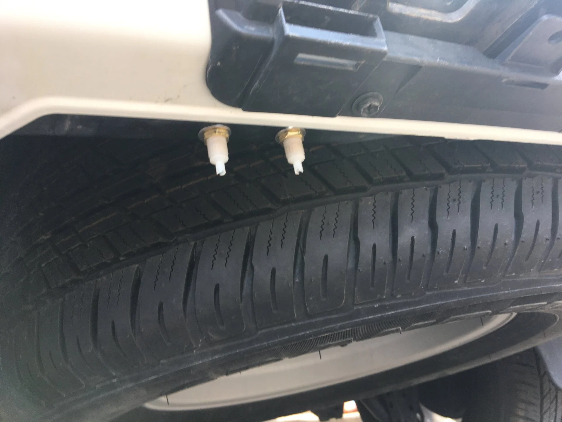

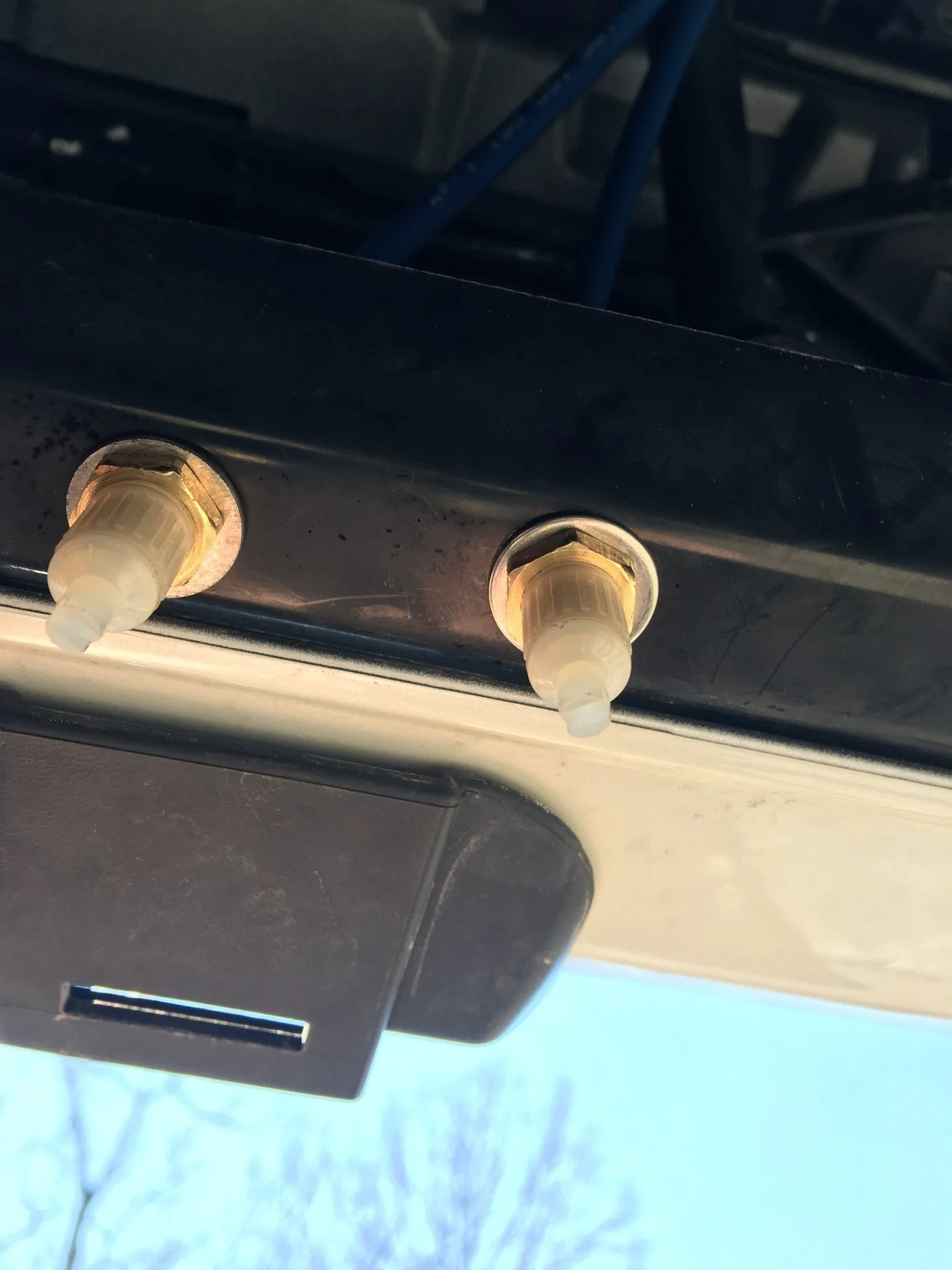

On another thought......I can't tell for sure where your fill valves are, but if they are facing down make sure they are well sealed with the cap. Otherwise the caps will fill with water and corrode the valve stems. (Learned the hard way on mine).

EDIT: Thank you for the tip about the valves, yes mine are mounted at the bottom brace of the rear bumper, no T-tie, two separate valves with those nippy white covers (in pics above). I will put some grease on those valves.
