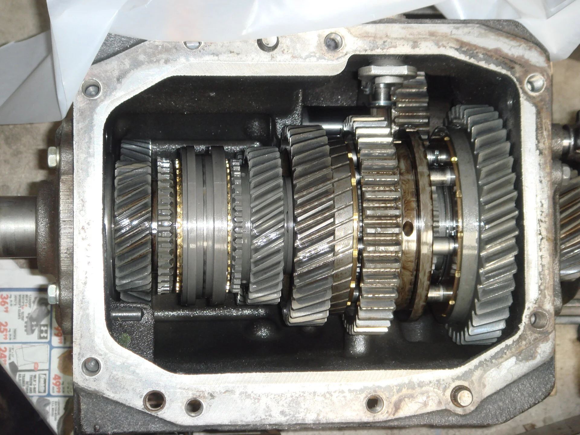

Here’s a photo of the transmission gears with the top cover removed — to get a lay of the land. May help you visualize what’s inside. This picture is of a 5 speed transmission but the 4 speed looks almost identical in the main case.
