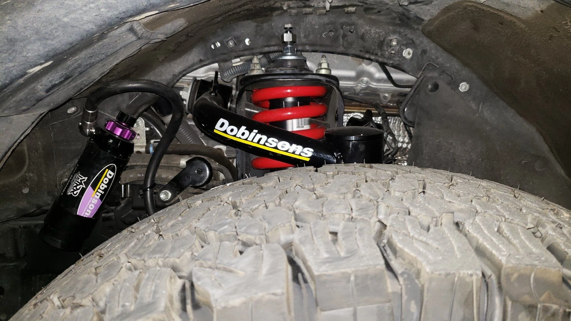

I have the Dobinson 2.5 mrr kit with similar tire and have the UCA works very well and allows for better articulation with the larger tire and lift.

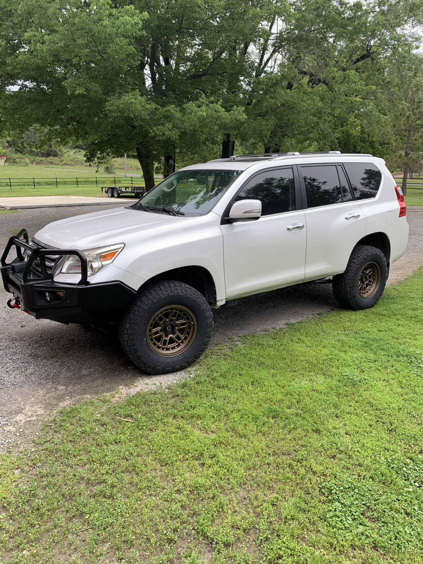

So went ahead and tried the fit without aftermarket UCA’s. Eventually will spend $ for some but not at this time. Looking into sliders-like RSG at the moment. Searching daily tho so anyone that likes some enough to mention let me know. Had some rubbing on the fender. Heat gun and some maneuvering and all is well.

No he just said he had no trouble with alignment. I asked him about UCA’s-said I didn’t need them but would help more so Offroad. Honestly I was expecting a different feel altogether with everything I changed. The ride and steering response is pretty much the same as it was before. The only thing I would have changed was the lift (2.5” front and 2” back). To level out a little better. I did 2”front with front arb bumper and 2”back. So front dips just enough to bug me! I had nitto grappler G2’s (18”)and went to cooper at3 xlt’s (17”)also.

short answer, aftermarkets will provide greater options to move the caster to prevent rubbing. as per which aftermarket has the most versatility, it is SPC UCA which also makes you future proof if you wanted to go 35s
