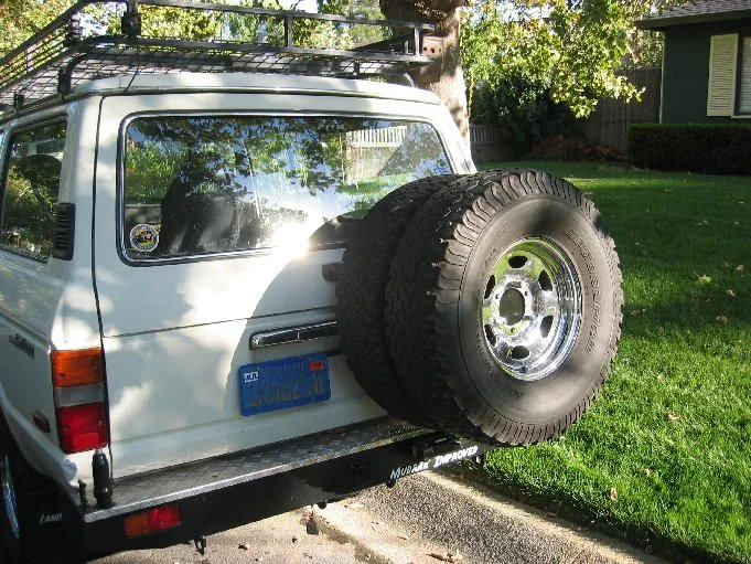

A card carrying member the empirical school of engineering, I've seen some pretty big tire set ups with high-lift jacks and all sorts of other stuff hanging off the back of Kaymar tire carriers. So...trying to save rack space for a 3 week trip to Baja starting next week, I thought why not piggy back another spare on the tire carrier?

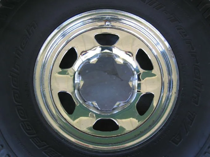

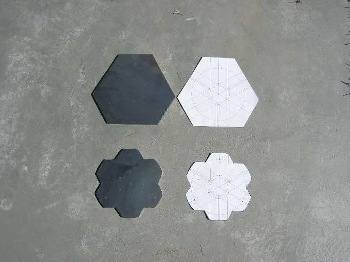

Stock rims with 33X10.5s, I cut out some 1/4" plate to fit the inside of the wheel. The outer face of stock rims have those "dimples" so you get this "hex" shape. The backside is no issue so a simpler shape.

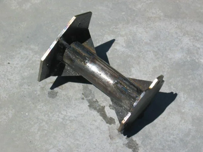

A 9" long piece 2 1/2" tube was welded to the plates and gusseted. M12 X 150 X 40mm were tacked to the outer plate.

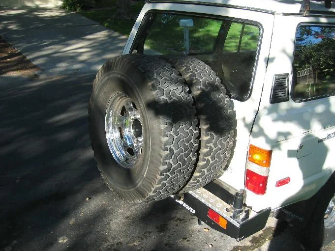

Images show piece work, the completed assembly loose and mounted. Final assembly worked pretty well. A bit of a cantilever, so some bounce, but no worse than a stock FJ40 tire carrier!

looks like it worked out for you, how does the weight feel when you swing it out
Not bad, I have buddies that have these cooler/tire carriers on their 40s. This isn't a fraction as heavy.

Maybe consider a lock and cable through the outer rim to your roof rack, just in case the leverage is too much for your set up and your outer rim/tire decides to go awol as you're driving.
Nice work by the way.
We are thinking along the same lines. I use ratcheted straps to hold my kit down on the roof and was thinking using one to tension the tire back to the roof rack. If it deadens the bounce, so much the better. I gotta say, though, it ain't that bad and I don't think it will be a problem...but we will see!
