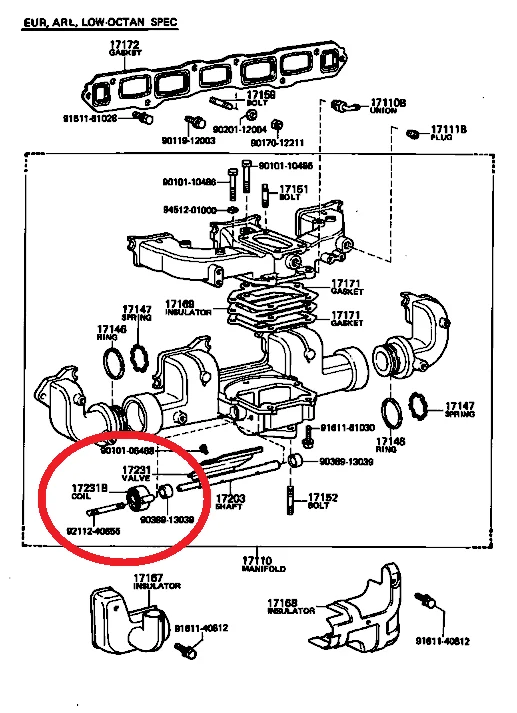

While checking the choke adjustment and all between I was looking at the heat control valve located on the exhaust manifold. I decide to add this to my checklist for the startup to op temp. I placed a yellow paint dot on the shaft to use as a reference to any movement while warming up. While the engine was reaching operating temperature I noticed the yellow dot was not moving. Taped with a small hammer, shot it with some liquid wrench, no movement even at op temp. Put a industrial heat gun right up next to the spring coil and had movement about 1/4 upward to where it held in that position. I do not have a outer balance weight on the side as some (not sure if I should) so I cannot move the shaft manually to do a feel travel test. The question - isn't this heat control valve suppose to open and stay open until engine cool down with more than a 1/4 turn on the shaft?

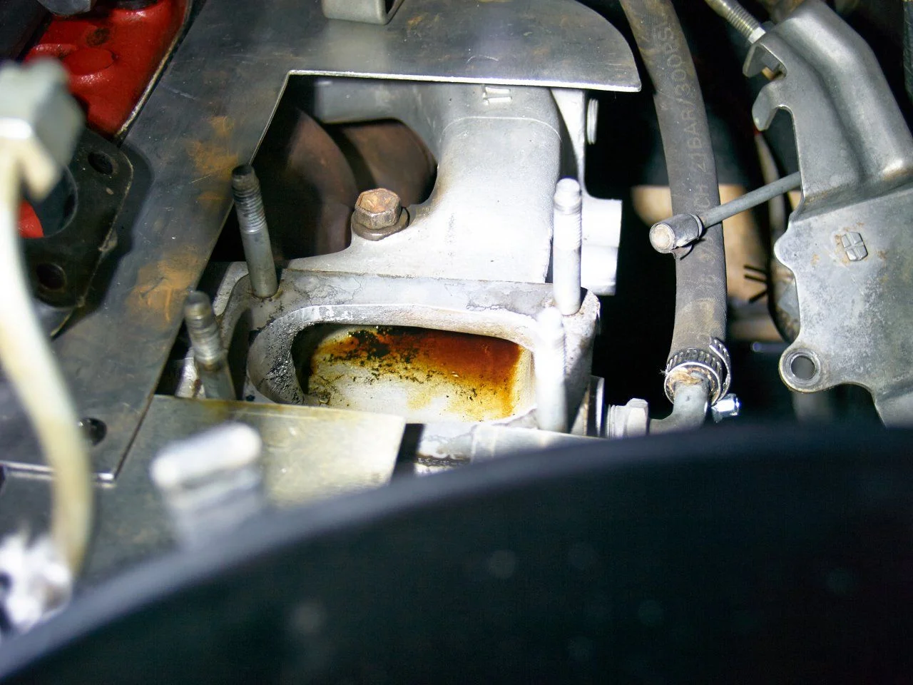

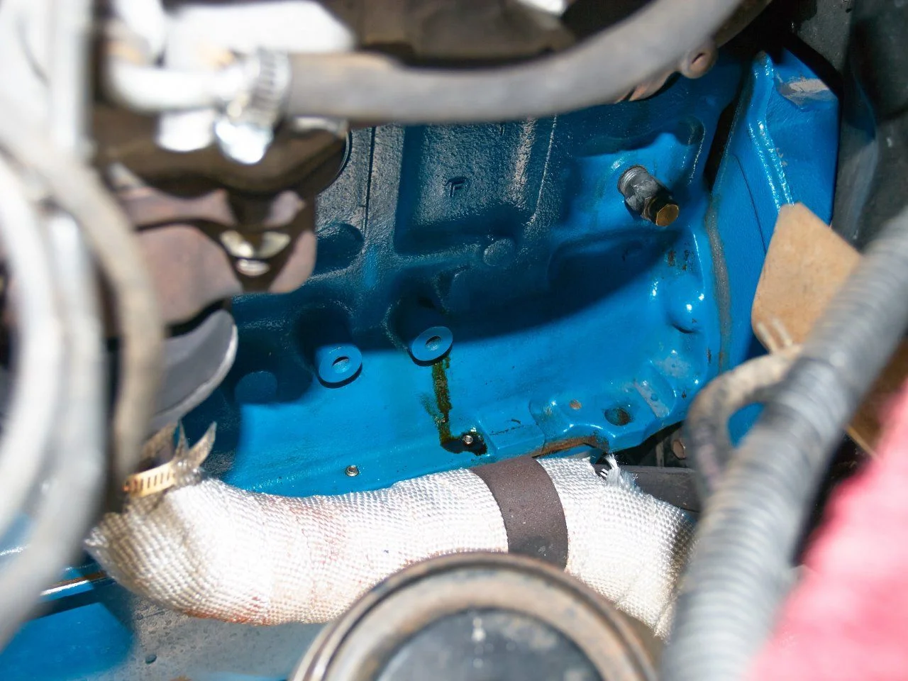

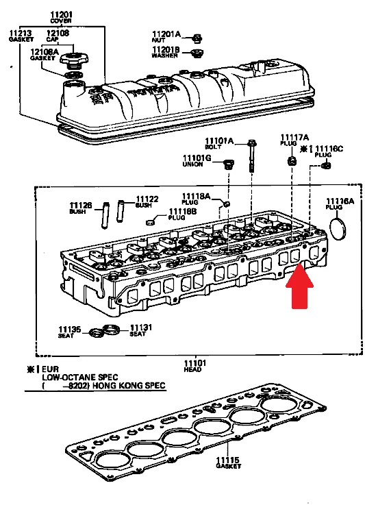

Also saw some oil on the side of the engine block so cleaned it up - after start up some what maybe fuel from the intake manifold dripped back down to the same area on the block. Looked up under the manifold with a mirror and light and saw small area where that oily dark drip came from. I have had problems with my car leaking fuel into the manifold. The question - could this be just residue from that and seeping out on startup?

Looks like oil maybe dripping onto the stud connections on the block-correct? Likely leaking out of the exhaust mani--may be some issues with valves here--do as sometic suggests--compression check. Also look under the mani to see exactly which cylinder it's coming from--(4/5/6) Could be the valve guides are worn, allowing oil to seep down into the chamber(s) and then out the exhaust. Take a look at the plugs in those cylinders too--they will tell you a lot about the combustion there. What does the tail pipe interior look like? carbon/oily? The leak looks too small to show up as an increased oil usage issue.
From the look of the pic, it appears this has just recently started. best to get it solved before the valves are compromised.

When viewed with a flashlight and mirror it looks to be coming from the area shown in the diagram with red arrow. Not sure what side of the exhaust gasket it drips from but I have wiped it out with a flat tip with rag attached and it will return after a 20-30 minute drive.
I adjusted the engine valves a few weeks ago and first thought it was a valve cove gasket leak but that seems not to be the predicament.

The heat control valve seems to be accurate when compared to the parts book. The two nuts I put on the end thinking it would keep the spring in place.

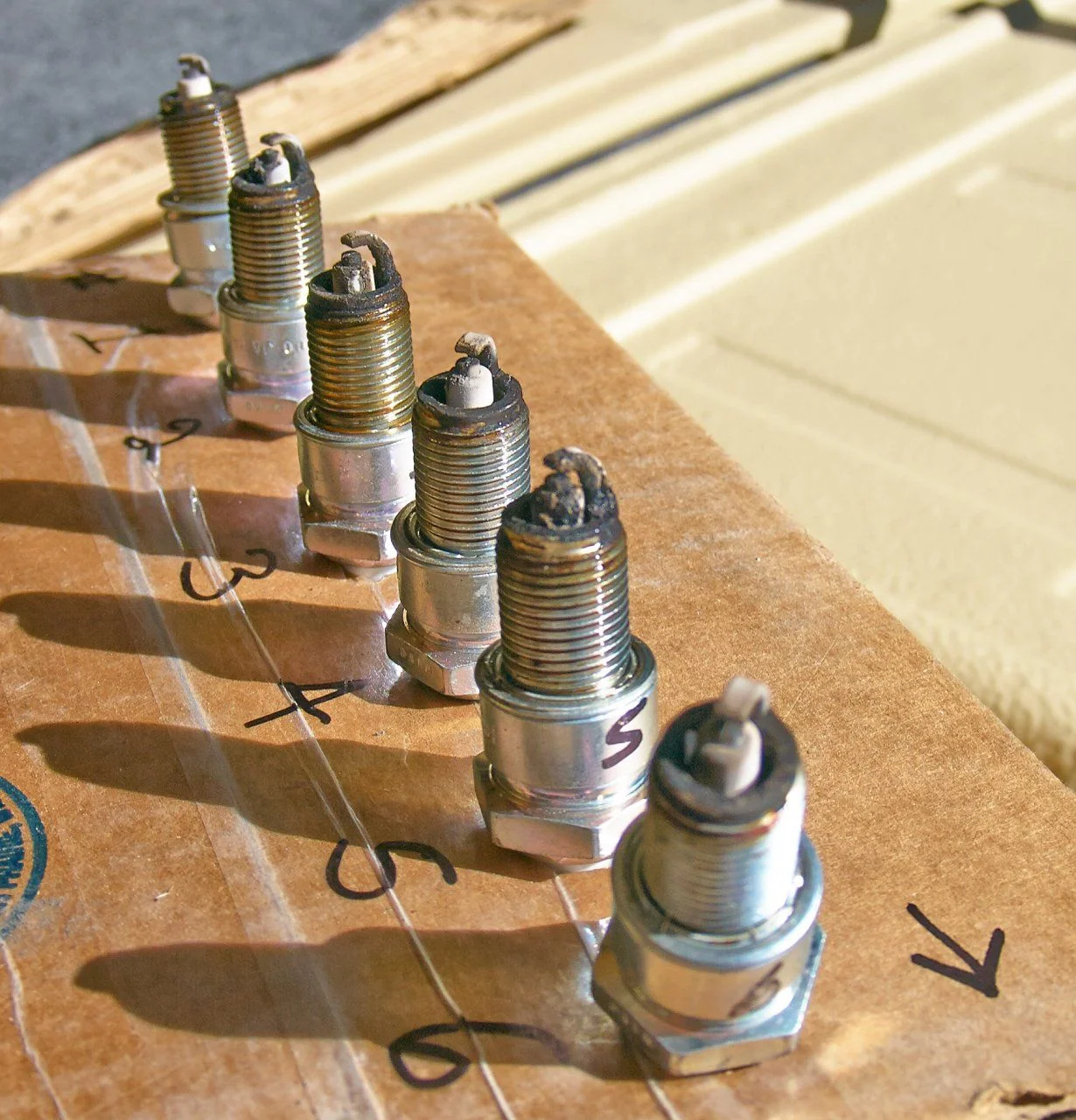

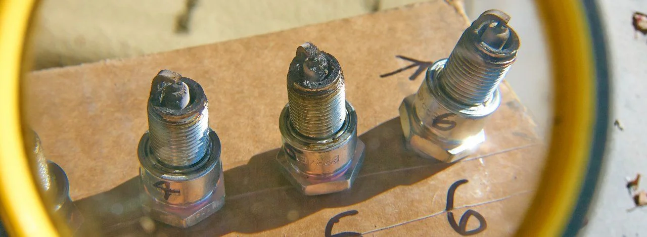

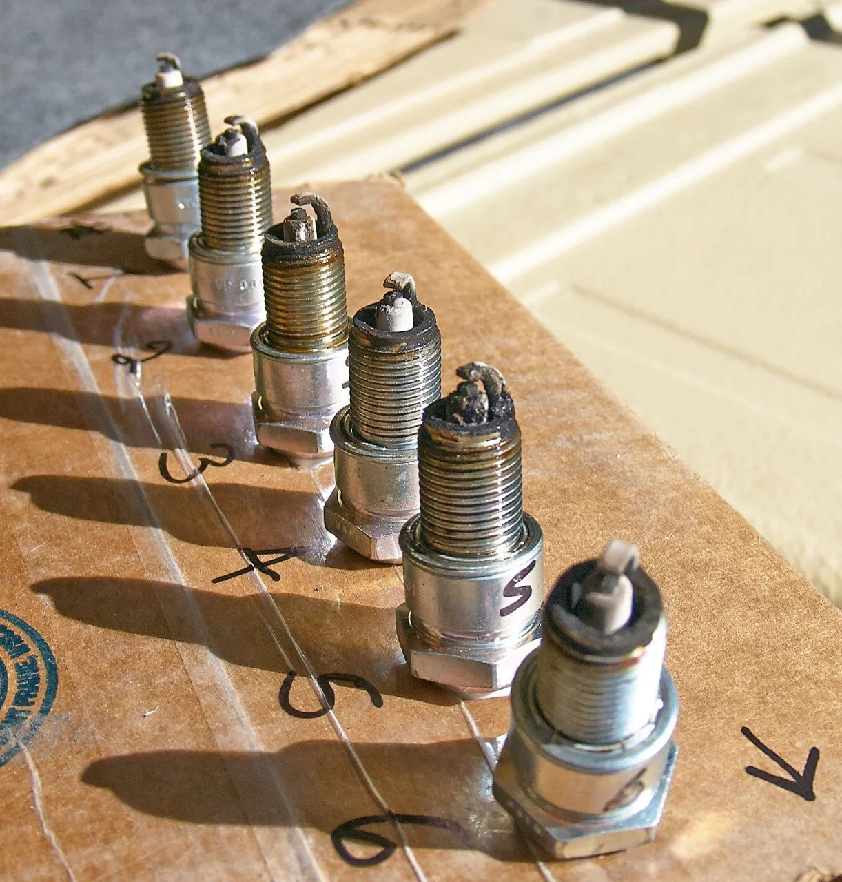

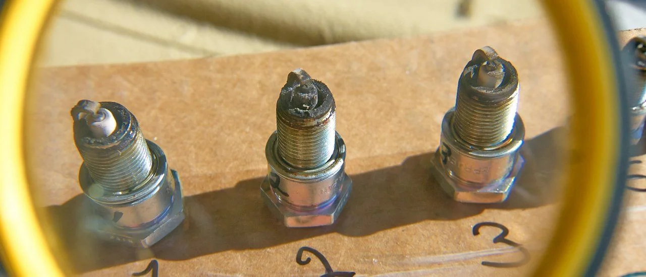

Just completed step one plug removal and it is a horrible thing to find. The pictures tells the story of the find. The plugs are not brut or melted at the electros as I first thought when viewing just caked on some with semi hard carbon/oil deposits. The plugs are less than four months since install, plug wires at the same time. They are correct plugs from what the book call for- BPR4EY. The evidence on the plugs show that the problem mainly could be carbon fouling from oil leakage, PVC or spark plug problems. I am going to get hold of a boar scope in a few days and check the cylinders/piston. As you can see the plugs have a certain amount tan color still on the electrodes tips so this is a good sign in a way telling me that either the plugs are not getting the correct amount of spark but trying or wrong plugs all together (not hot), plug wires are crap (could be), coil weak, distributor failing, or the ethanol fuel is playing havoc, or all the above.

I think that it is an ignition problem for sure. Your compression is okay and the plugs dont seem to be oily or wet. My guess is that your valves will be fine.

That #5 plug is UUUGGGLy--agree with your assessment of carbon fouling(#3 doesn't look that great either) Exhaust check you did(color) seems normal.
It may be the pic angle(or just my goofy eyesight), but the plug gaps look a little different.
I would check the resistance of all the plug wires(should be less than 25K ohms), maybe get a new set of NGKs(gap ~.039)- run em for a few hundred miles and check again
Yeah, I have been sweating bullets on this deal. Its starting to look better than grim. New plug wires as stated but as we all know they may have a problem so will give them a check as you mentioned. The plugs do look like well you hit it with UUUGGGLY. I have never had a vehicle that produced plugs like this. They are nasty. My book says .031 (8mm) on the gap, isn't 39 a little much? The BPR4EY plugs are correct (ones in pictures) and are on the hotter side of the BPR5EY plugs that are suggested also. I may try another set of the same to keep things a bit hotter in the cylinders. I stuck an old set of plugs in to get me around and after an hour got home and took a look under the old bonnet to view the oily drip and NONE??? So maybe the plugs are so bad (okay they are bad) that fuel was just not getting completely burned off and dumping. Will give it a few more days of driving and replace the plugs and check the drip. Still working the heat valve. Seems to be freeing up a bit.

The heat valve only rotates 90* max.
Plugs are carbon fouled. Could be normal w/ new engine break in and burning off assembly lube. Install new set of W14EXR-U or BPR4EY (hottest numbers available) and see how they look after a few more tanks of gas.

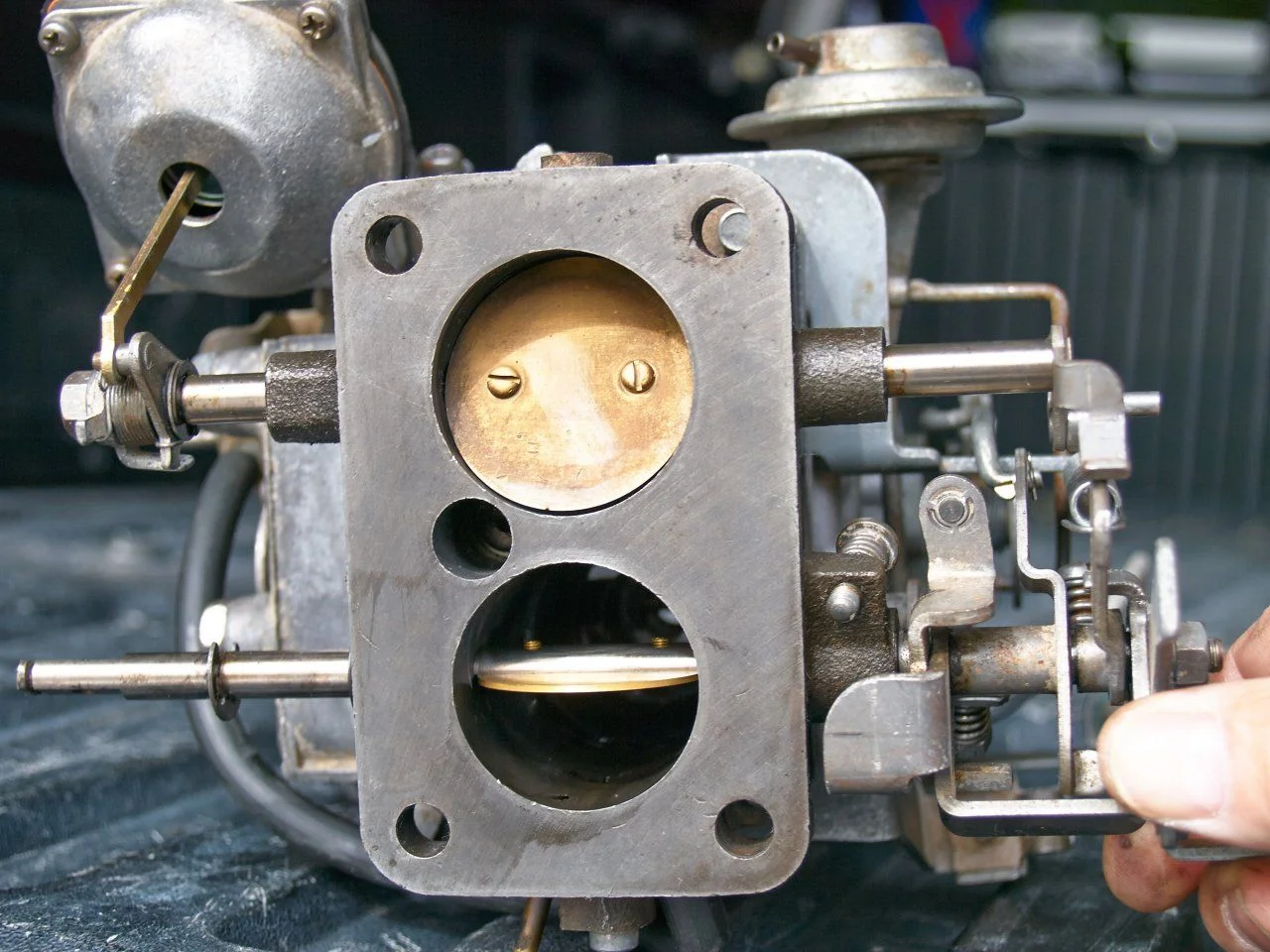

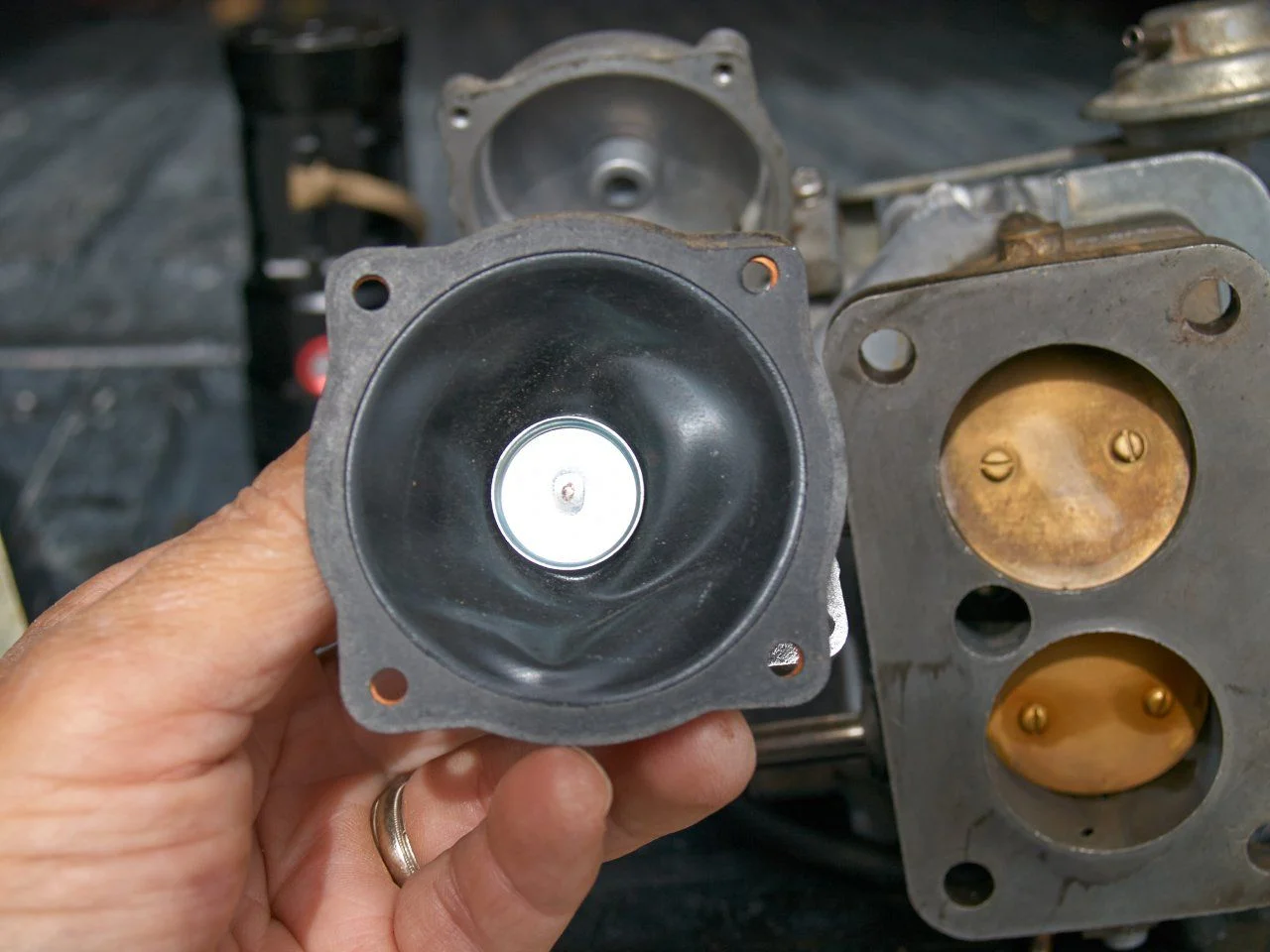

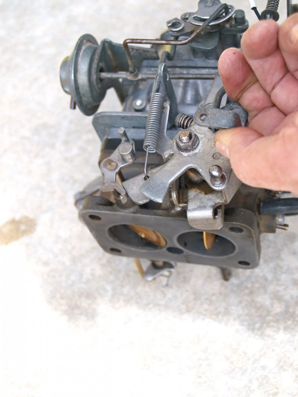

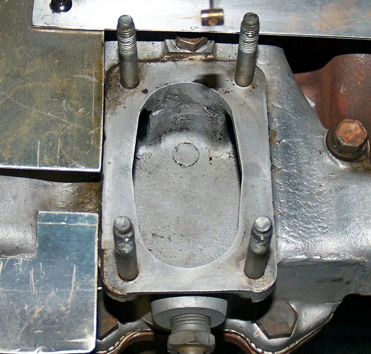

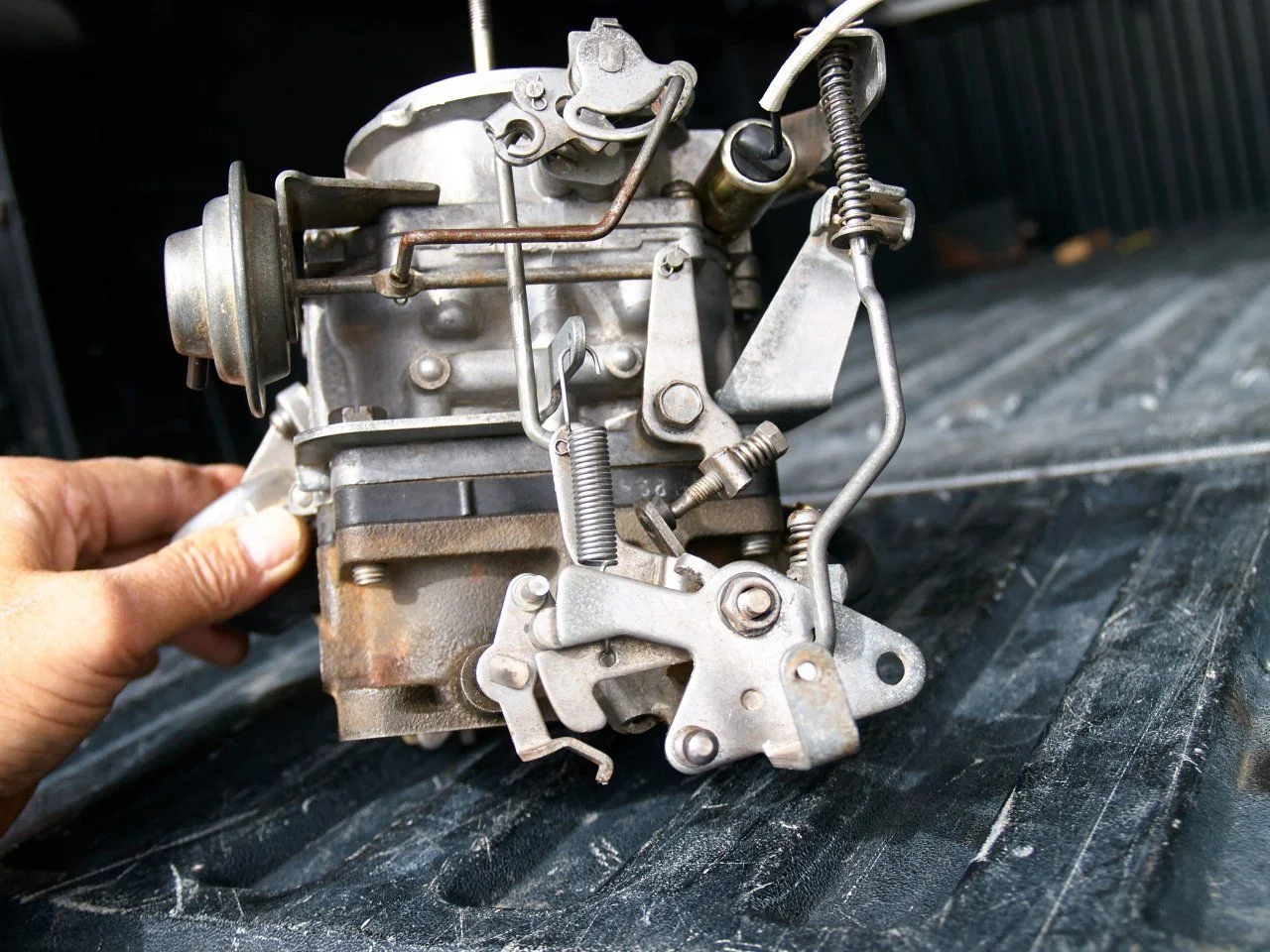

looked on the block side again after a few miles and the drip was back. Decided to remove the carburetor to check of cracks in the manifold floor under the carb base, all looks good other than a puddle of diluted fuel/oil as seen in pictures. Will check the PVC system again in a bit. What looks like cracks are cast marks on the manifold. I cleaned and used a high powered light and mirror and still looks okay. Isolation block looks good but not sure if it needs a second gasket along with the built in gasket as seen. Looked at the carb (you know better than I) and saw not much in the way of concerns other than I am not sure if the secondary throttle plate should be more in the open position with the primary valve fully open as seen in photo.
The small tab looks to be just touching when opened all the way.
Yes the fuel is level when viewed running. Had BPR4EY's installed and they cleaned up good. Have BPR5EYs in right now until I get this carb/manifold/fuel/oil problem figured out. I know photos are always best references so I have included a few incase someone see something that I may have overlooked. Also no black or blue exhaust smoke with instant RPM added and released.

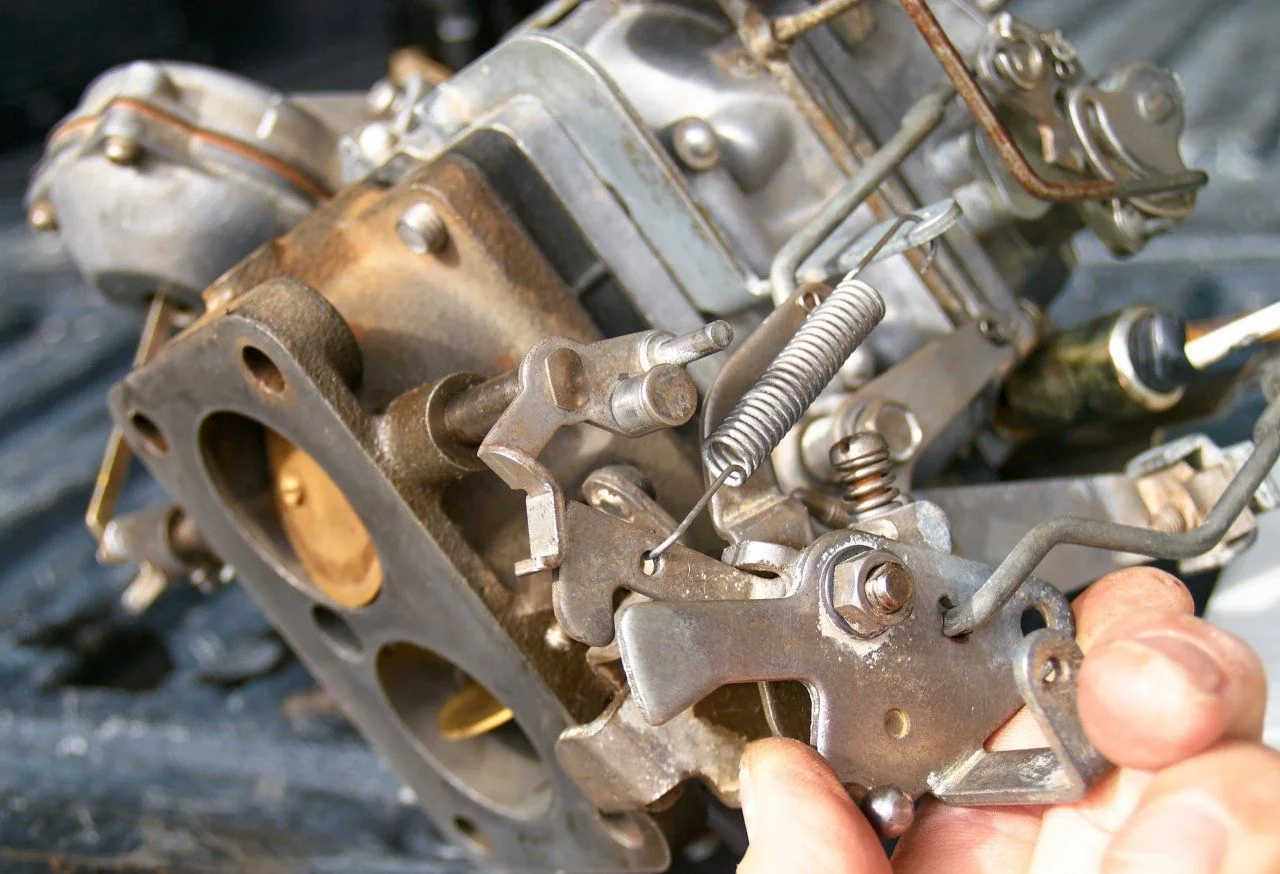

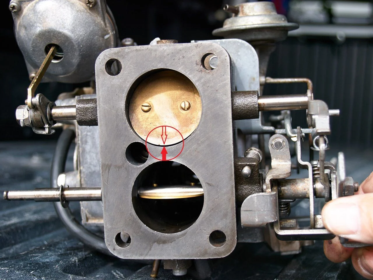

I saw something similar in one of my old school auto maintains books. Will be checking into the whole ignition system shortly. Just have to iron out a few little things with the carb before reinstallation. One is the secondary butterfly opening. Says to open primary and with a degree gauge cheek the angle of the secondary @ 25 degrees angle just before it starts to open. I do not have an angle gauge so is there an alternative to the check like with a mm wire, 1mm or ?
Thanks
The secondary bump is to ensure the 2ndary isn't stuck closed, so the relatively weak vacuum can open it without difficulty. As long as it knocks it open 1-2mm, it's fine. Focus on the important stuff: getting the cold BPR5's replaced with the correct BPR4s, and make sure the intake tract & exhaust are clear (clean air filter, choke open, no restriction in cat or muff...). Then drive it hard for a while & re-check plugs.
Thanks Jim for the information on the secondary's settings. It is good and loose so it should be functioning okay. Set @ 2mm. for my reff.

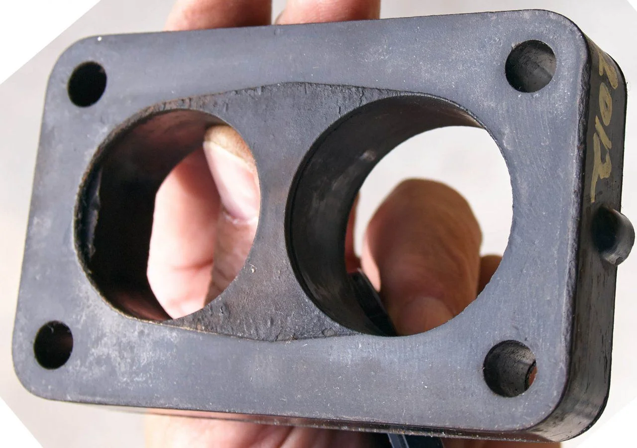

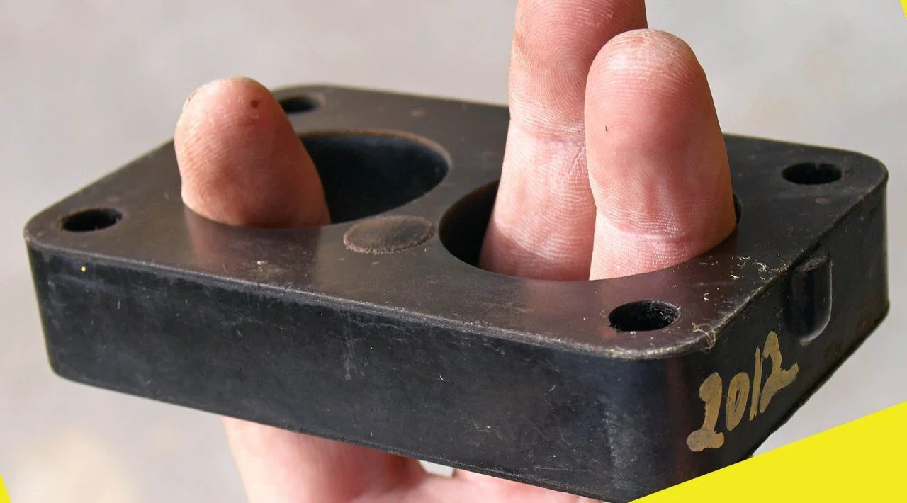

Bore scoped all cylinder's last night, all good. FJ40Jim, on the carb isolation block, are any other gasket required other than the factory ones imbedded to the block, book is vague? All you mentioned I had previously checked (no cat). With that said I agree all I can do is put it back together and give it a work out.
