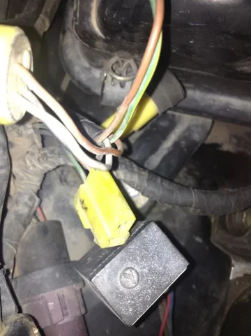

First off, I just finished putting everything back together after having issues with leaky injectors. Currently, I am experiencing a no-start/power issue. I can tell you for certain that when I parked my 4Runner in January, it WOULD start, and all the lights would come on normally. Does anybody have any suggestions about what to check? It should be noted that the vehicle has a fresh battery. Interestingly enough, a few lights initially did come on when I installed the new battery, but the truck would never start. It would not even turn over.
Also, I have a question about where this "ground" goes. It should be noted that the vehicle ran last January without the "ground" connected.
By any chance do you have a picture or diagram of where it goes?
Thanks for the example I will try that and see if if fixes the non start issue.

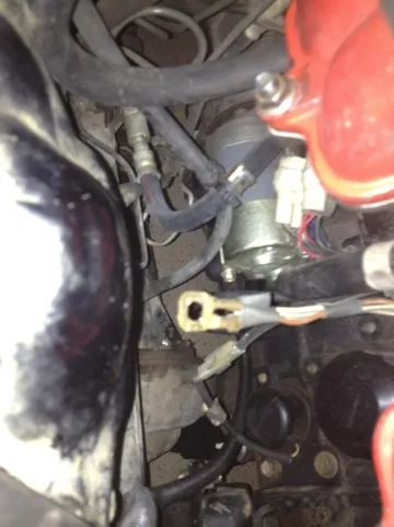

So is this the connector you guys are talking about?
What are the conditions for this test to work?
The reason I'm asking is I tried that connector before bolting the plenum back on. Nothing happened.
So does that test go something like this? With the plenum off, reconnect the battery. Then jumper that connection and turn the ignition to ON, thus pressurizing the fuel rail.
The jumper I made consists of a piece of 12-gauge wire with a male spade connector on each end. This jumper that I described should work, correct?
Check this image that I "borrowed" from Rodger Brown's excellent website (http://www.4crawler.com/4x4/CheapTricks/index.shtml#TimingCheckConnector):
This is on the driver's side inner fender on '85 trucks (EFI was still being perfected at this time), in '86 and up there is a diagnostic connector over on the fusebox behind the battery for everything. The plug circled in red is the fuel pump test plug. Yes, the behavior is (supposed to be) as you described. Any type of a jumper will work, a paper clip is typically used.

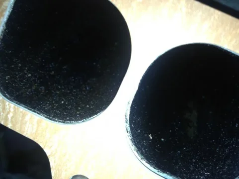

Also could you give me your thoughts on this.
This seems like a lot of build up for a new engine. Engine is a brand new long block with 1500 to 2000 miles on it.
I hope it's not one of the high pressure hoses, those things are stupidly expensive.
Does seem like a lot of carbon buildup for only that many miles. Have you done a valve adjustment lately?
