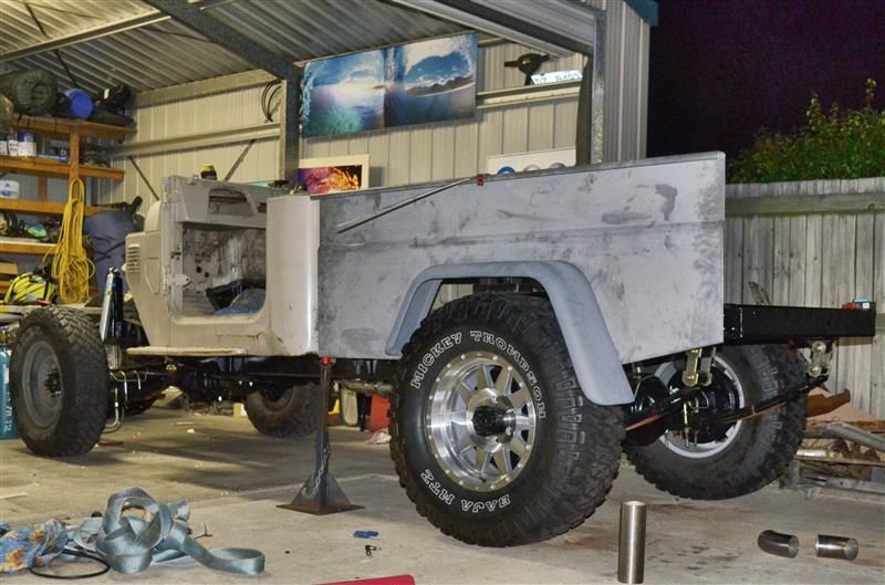

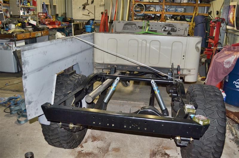

I dropped a heap of leaves out of the rear packs to get it closer to ride height and mocked up the styleside properly. I love the look of it, but am now worried the 35s are going to be too big with only around 3" up travel before hitting the tub.
I don't want to lift the 45 any higher either so am thinking I will have to drop back to 33s. Next issue is I think the 17" rims might look too out of place with only 33s on them....

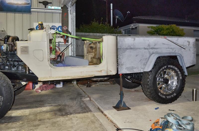

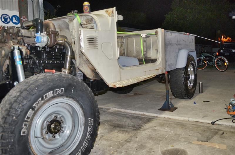

Started fitting up the OzEast fibreglass front gaurds (65mm wider then stock) last night. Chucked the doors and roof back on to get a better look on how the finished truck will look. Pretty stoked!

Finally finished up the 65mm wider front fibreglass guards and have had the headboard folded up and now fitted to the tub. Really happy with how its turned out. Wooden floor with polished stainless strips between each plank is next then get some inner wheel tubs folded up.
Have lifted the rear flares up which looks heaps better. I'll cut out the sheet metal to suit. Will allow me to run the 35s at the current lift height. I'll get a fibreglasser to cut and shut the flares so the front and back both finish at the bottom of the sides.
