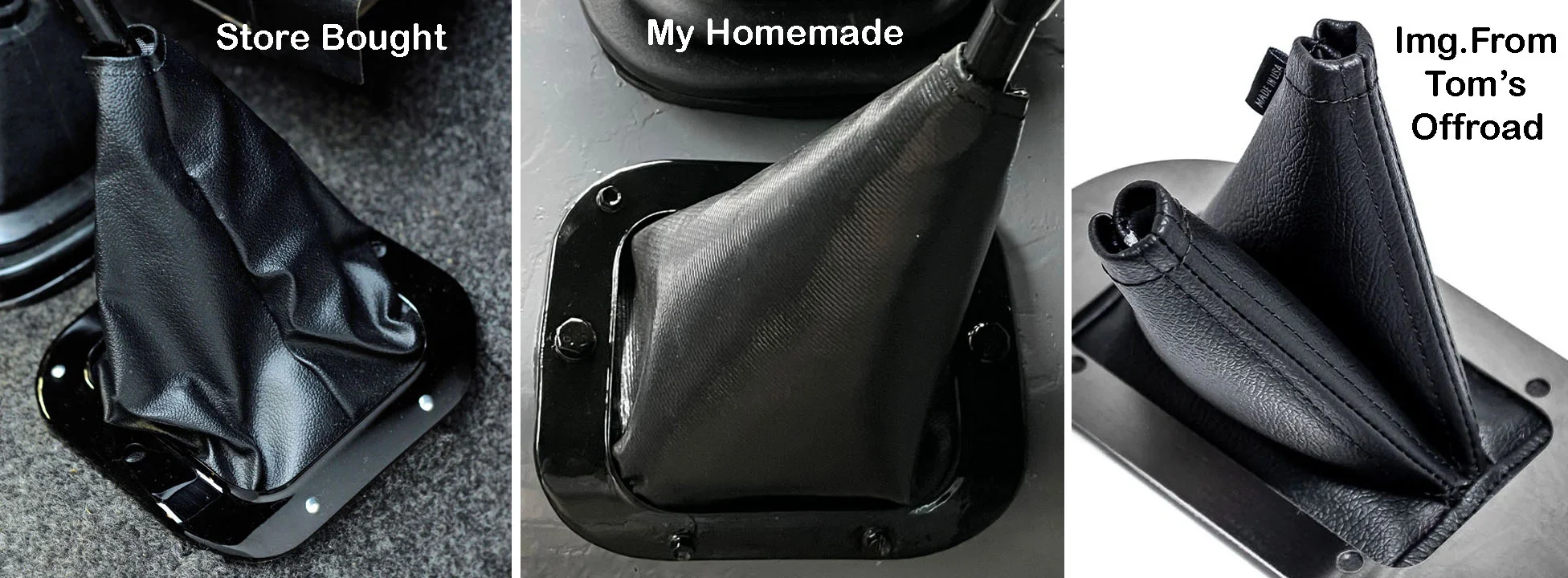

I replaced my single stick boot several times after the vinyl deteriorated so this last time, I sewed up my own boot using a high-quality marine vinyl. Maybe you could do something similar. Or even leather like 1911 suggested.
I made the boot for my single shift lever out of a piece of use waterproof tent floor. Drilled out the pop rivet's, cut the seams on the worn boot, laid it out as the template. Cut the fabric, sewed it up with paracord tie for the shaft. Put the boot in the metal brackets and pop riveted it back together. I think its still there and in good shape after like 20+ years.
