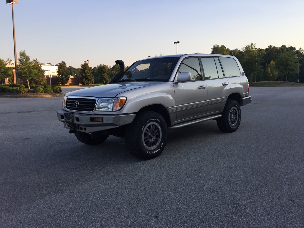

I generally like mine to sit level, but after riding on my bumpstops with all these beno-mobile parts in the back I can appreciate having a little extra umph in the rear springs.
I like it. you can prove them all wrong and wear them shocks out and maybe he will put you in some of those pros next time.
I have a heavy load in the rear now... so it won't be any heavier back there.
I also like the level look. So I'll prolly re-index the bars and buy a dif drop bracket.
This lift had already settled up front. So at lunch I ran it up on the lift and re-indexed the front brackets, assuming I had originally installed the DS one tooth off. I was right. We got it perfectly level.... but the dang front axle shafts vibrated terribly at highway speed... So came back and backed it down a bit, still vibrating... and here's the stance:
So... I have two options: either buy the dif drop bracket and prolly the A-Arms.... OR: just pull the rear springs and take a cut off the top of them... Not sure which way to go. I really don't want a tall lift, so I'm thinking the latter... hmm
Do they offer a shorter spring, or do they make a spacer that would let use the stock sptings yo lift the rear to match the front?
Yes... They do... But I was advised to get the heavy lift and bars, and I knew better. I truly knew better... but I did, and I hate it. I've never.
Ever.
Ever.
Seen a level lift, and I knew the heavy springs would do this. kinda sick thinking about it. It's my fault for not listening to myself. So I'll deal with it, cause I knew.

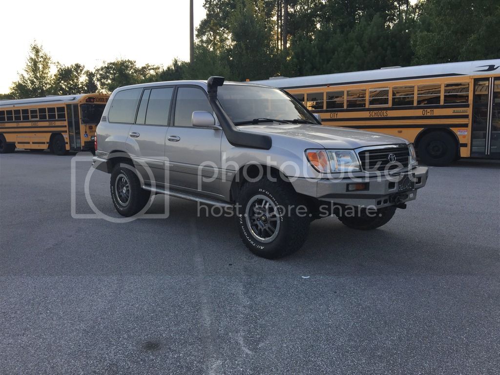

The pic in front of the buses, it drove fine and dandy. So maybe I'll lower it to the point it drives good again. Then get an alignment.
