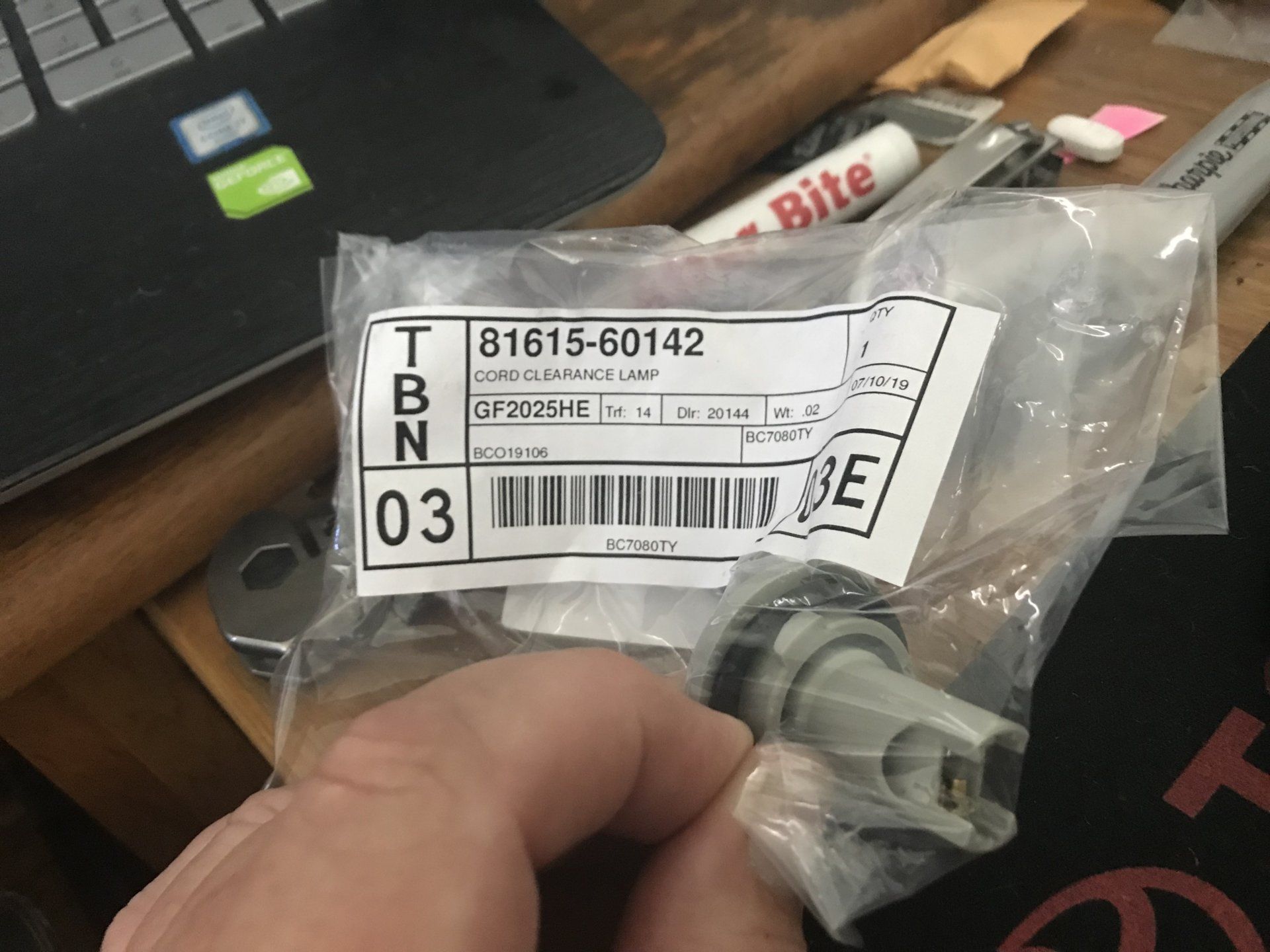

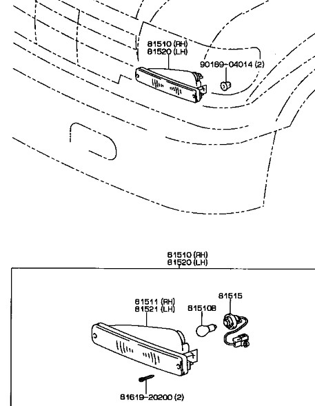

Ive ordered marker light, turn signal sockets over and over for the large marker lights below headlights and toyota KEEEPS sending cord clearance lamp sockets, whats the actual name of what Im trying to buy here?? God I miss BENO Amazon product ASIN B01873JOEY
This what they send me And pictured on truck are what I need
my sockets keep melting from fitting so loosely. hence the need to replace.

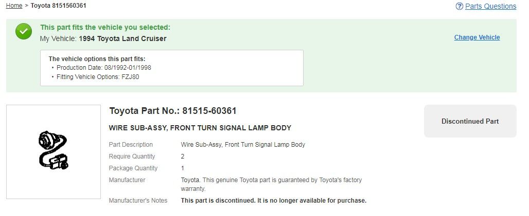

I can get ya one if you want think I have couple
I THINK I ordered a set and if you have them save them they are discontinued thanks
