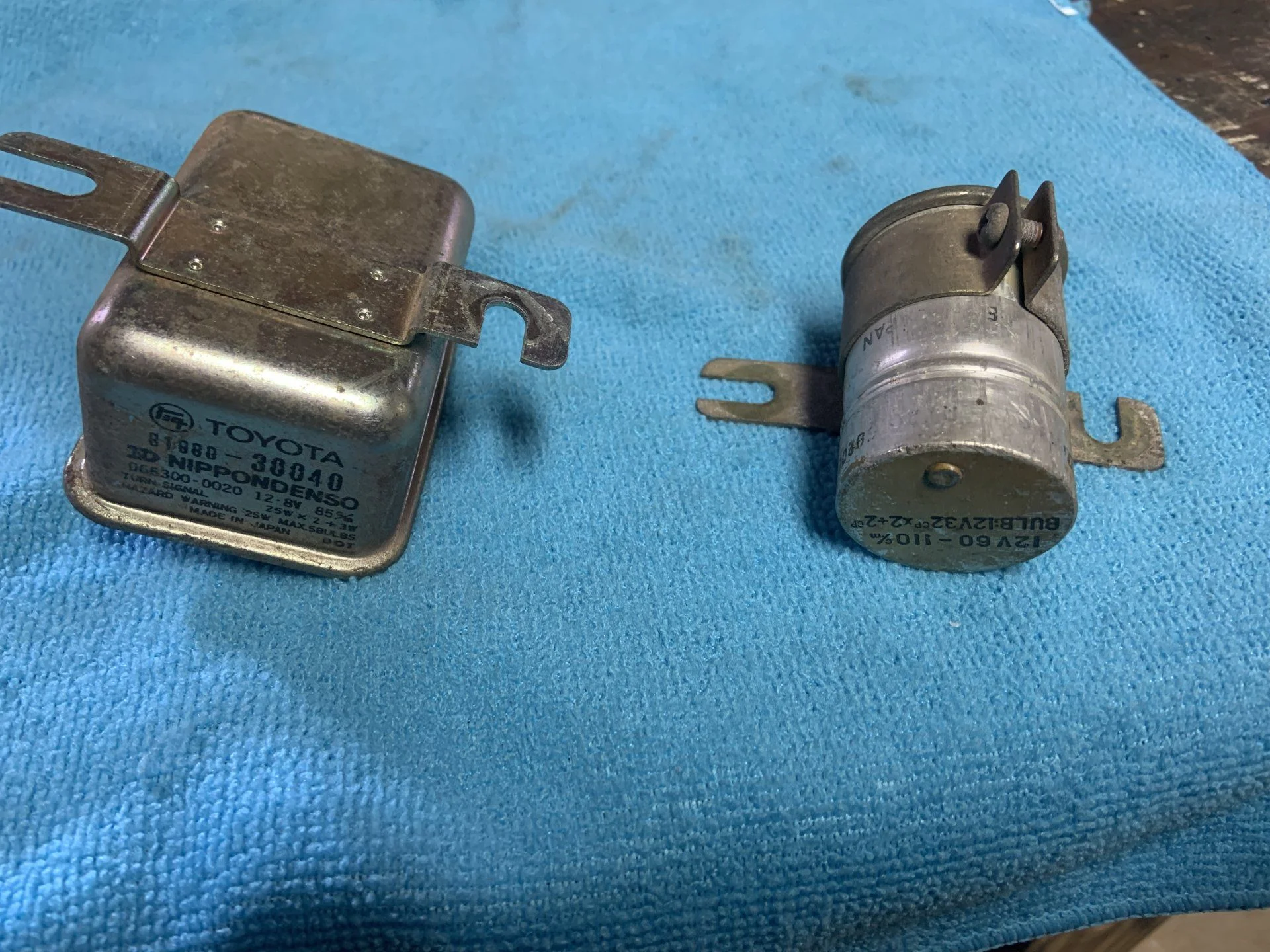

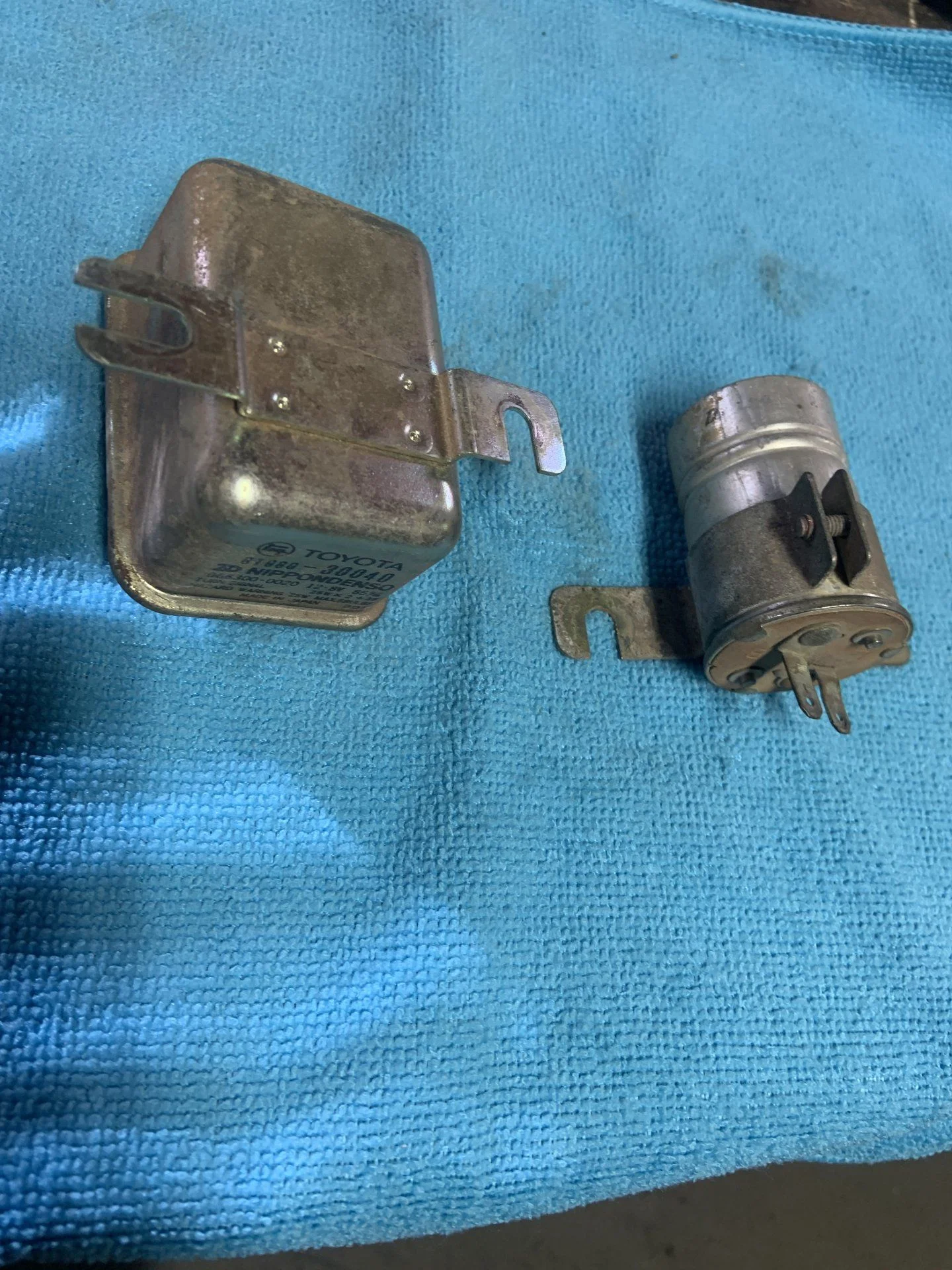

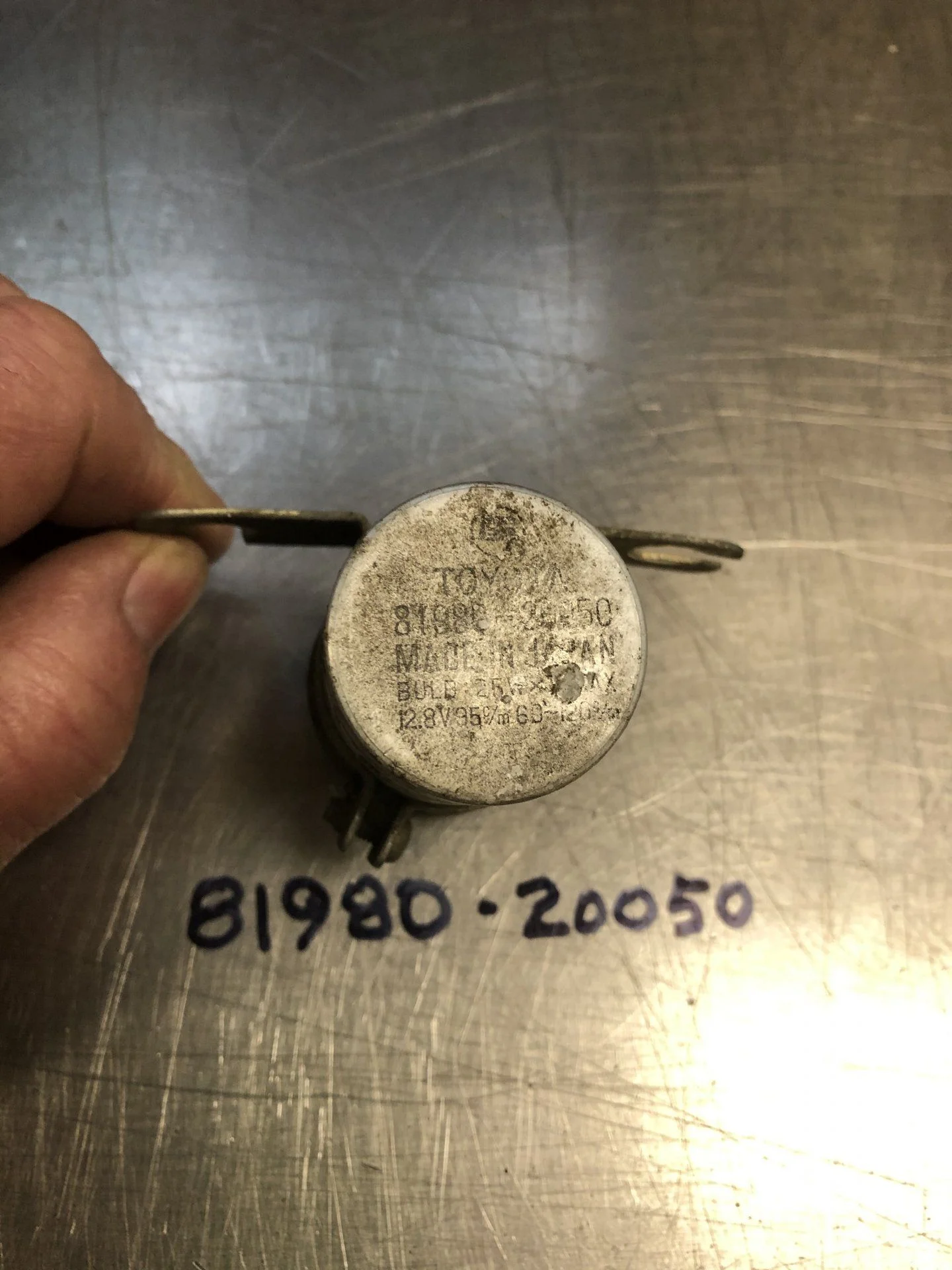

I have an aftermarket turn signal flasher installed currently and it blinks very rapidly. I also have the two OEM pictured below but neither of those work or are correct for the year. Can anyone show me what I am looking for? If you have an extra I am interested in purchasing. Thanks!
Heres a link to check your part numbers its very specific as it searches by frame#

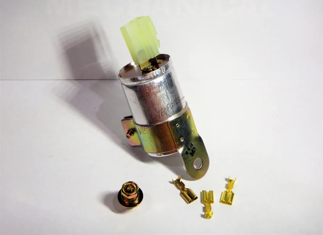

Chris, Toyota sells a solid-state replacement for the old cylindrical flasher. Plug n play. IIRC the suffix cod is 12H04. Cylinders are only for resto purists.
His issue is he doesn't know which one fits his truck since neither of them are on his truck

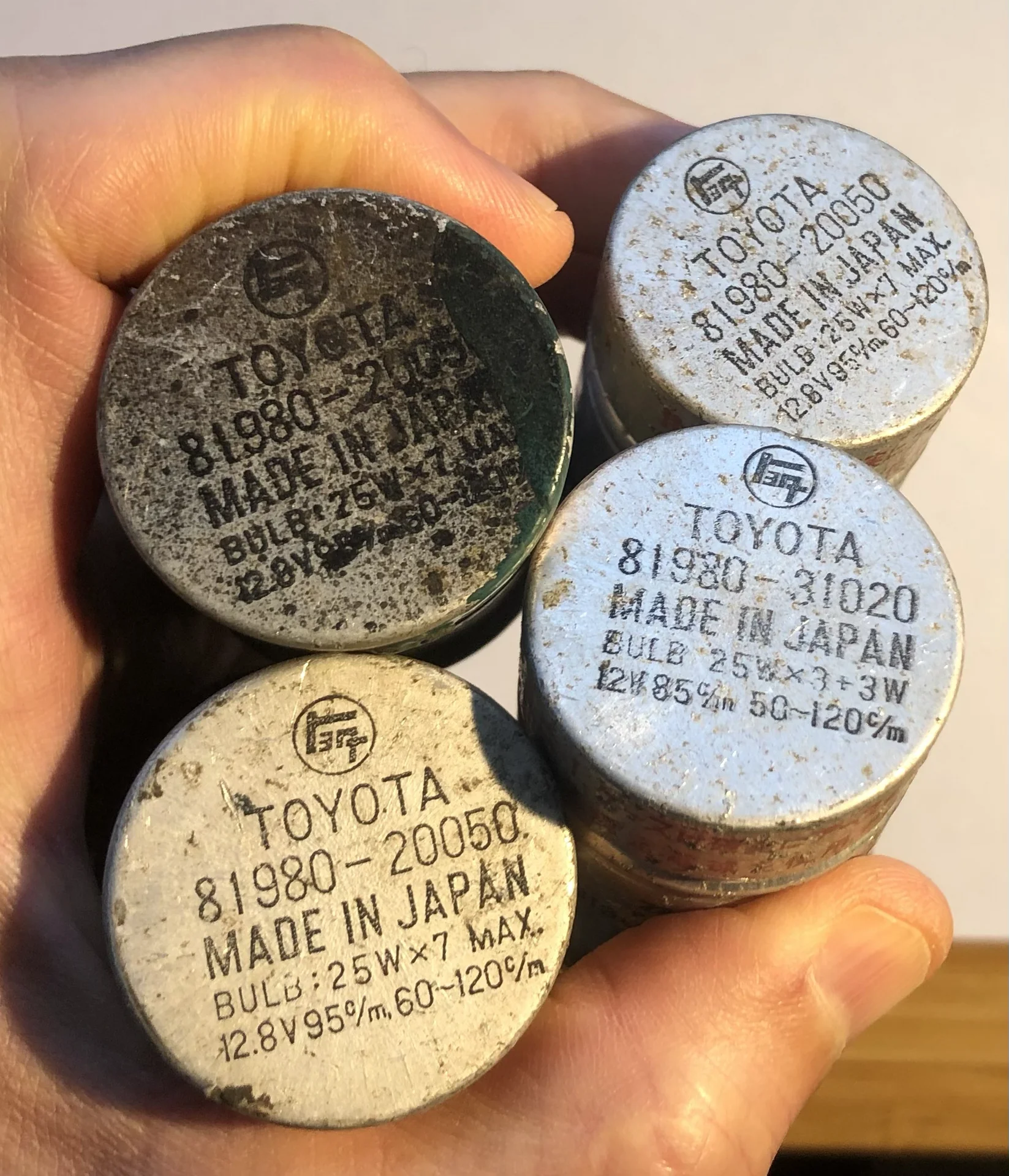

I have a few spare early flashers.
If ....ANYONE.... wants these four relays above for very reasonable - just holler . Not tested though bound to have at least one good one out of four. Fellow I got them from was always good about labelling the duds.
