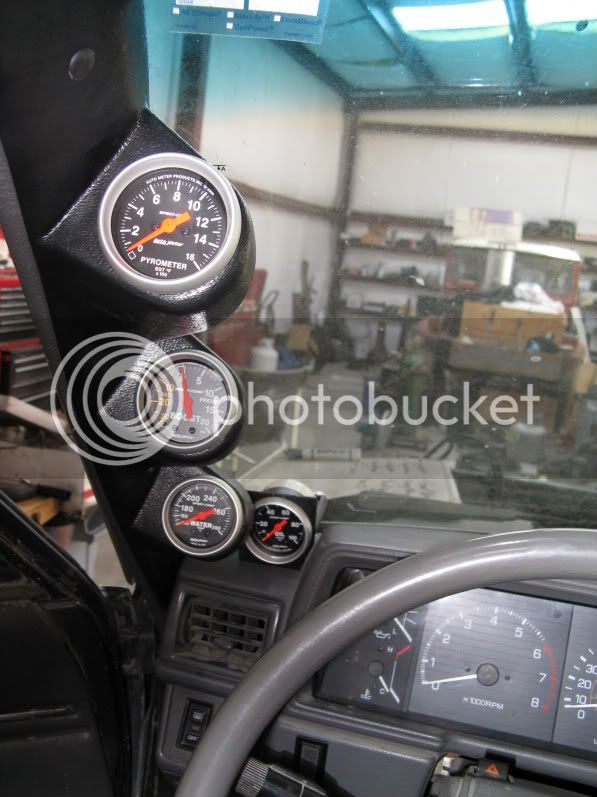

ntsqd, are you questining the accuracy of the aftermarket gauges? Rightfully so I think. I was just reading machine design at work and they sell top of the line pressure transducers, for like 500 bucks. There is no way a 50$ autometer gauge is going to be as accurate as that. However it would be intresting to put both types of gauges on a manifold and compare readings, and then see how the reading change over time.
I know from personal experience that DDC test cells get all the pressure and temp sensors calibrated something like every 4 months. So even the superexpensive s*** gets out of whack after some time.
Of the gauges pictured I would worry the most about the pyrometer, those things dont last very long. When DDC does engine testing there is uasually one in each exhaust manifold runner and after a few weeks they start to read like 3 million degrees, the thermocouples just dont last in that kind of enviroment, and gas engine exhaust temps are even higher than diesels.
Though I don't think that a vehicle needs the kind of accuracy and repeatability used in a test cell, that is exactly my point. That the aftermarket gauges are not something to rely on. To the best of my knowledge there is no published data for their accuracy and repeatability. Yet all but the lowliest gauge, and even some of those in McMaster-Carr's listing have those specs listed right up front.
The aftermarket gauges might have good specs, but unless they are published there is no way for the average person to know that info.
