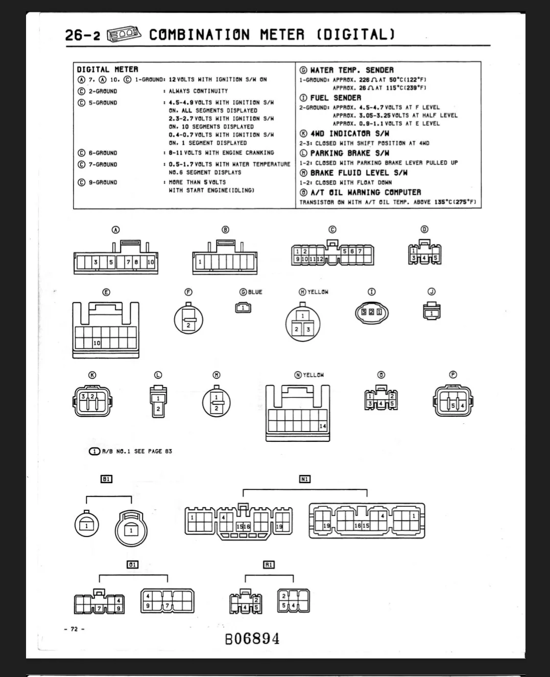

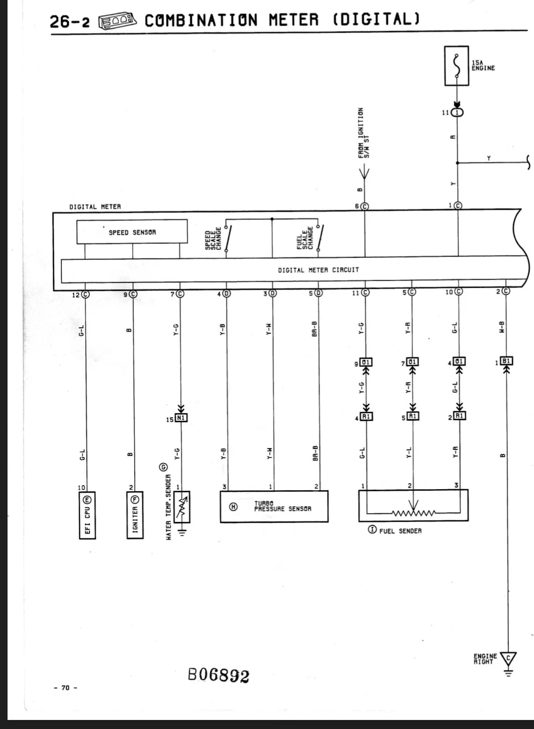

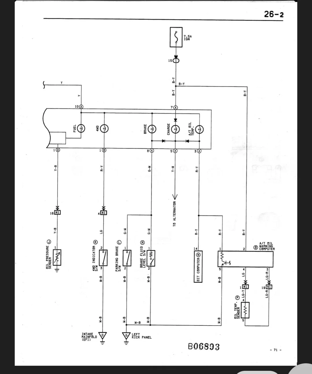

So I just picked up a 4runner gauge cluster unsure if it works. How would I go bench testing it? This is the wire diagram. I know there is quite a bit of work to do to get it to work on my Dlx 4runner. Any help would be appreciated
