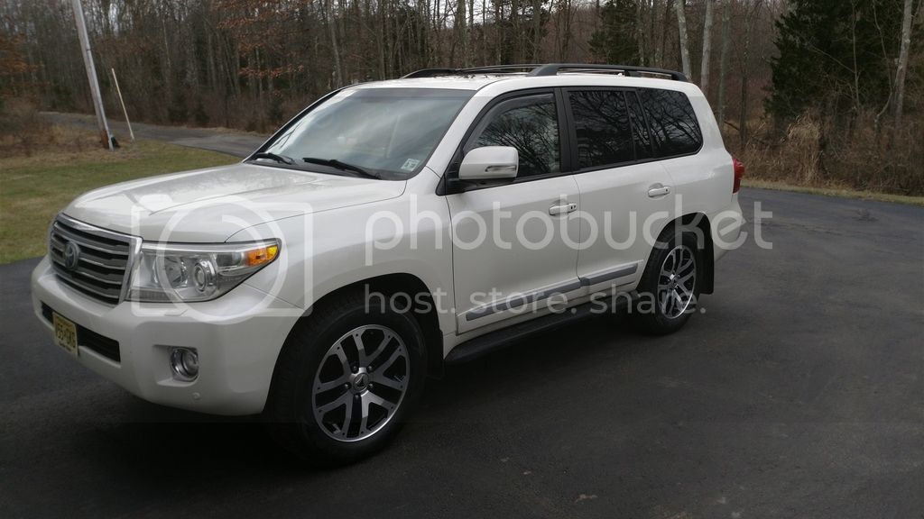

First post on this forum. I know, in advance, that I will need my flame suit around here, but I wanted to share a picture of my LC 200 series with Tundra TSS 20" wheels. I picked these up on ebay for a price I could not pass up. My offroading consists of basic country back roads and beach driving, we shall see if I have issues with the smaller tires. I really like the way it looks and after about 100 miles I haven't noticed any decrease in ride quality.
I haven't found a lot of info on these wheels. I bought them from a Toyota dealer, they told me they were take-offs from a 2017 Tundra TSS Special Edition. Toyota's website doesn't seem to have any info on them and they are definitely not standard equipment. The tires are from 2015 so not so sure how these could come off a 2017...

So I took the LC to my local Toyota dealer to try and register the TPMS.
They told me it could not be done, something about the wheel requiring a 8 digit pin and the LC using a 7 digit pin.
They also told me the wheels were aftermarket and told me that the TPMS wouldn't work on a Tundra either. Both of which statements are incorrect, see the port-option thread above, and the fact that the dealer I bought the wheels from showed me the TPMS working on the brand new Tundra before they took them off.
Can anybody confirm the 7 vs 8 digit thing? The LC is a 2013 and I believe the wheels are from a 2017.

I spoke w/ the dealer in Dallas who sold me the wheels. Here was his response:
Unfortunately the sensors in those wheels are for a Tundra. The Land Cruiser uses a different sensor. You'll need part number 42607-33011.

Looks GREAT!!
