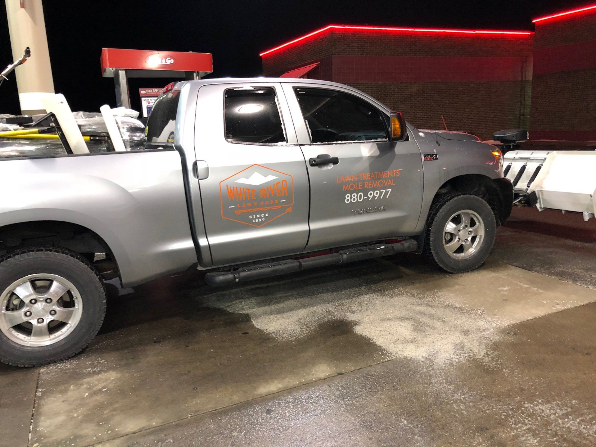

Finally pulled the trigger on the lift and beefing up. Went with OME Heavy struts and springs up front. It raised the truck 6” in front. Have PacBrake airbags in the back with stock shocks and can match the ride height I need based on weight. I mounted the Blizzard PowerPlow 8100 to see if the Truck could handle it. With the plow raised off the ground, the trucks drops less than 1” . I had to get 10 ply tires. Left the shop with 70 bags of ice melt at 3500# and the powerplow weighing 967#. Truck does great. Probably should keep the ice melt load to about 50 bags, But the Tundra is a beast! Plenty of power and love the tranny. Ride is really rough with no load. It’s about like my RAM 4500 for ride comfort. But I loaded it up to be a work truck, not for highway comfort. Here’s some pics loaded. The bottom of the plow frame mount is 9” off the ground with the plow up. And 17” off the ground with the plow not hooked up. This picture is 63bags in the bed. 3150#
