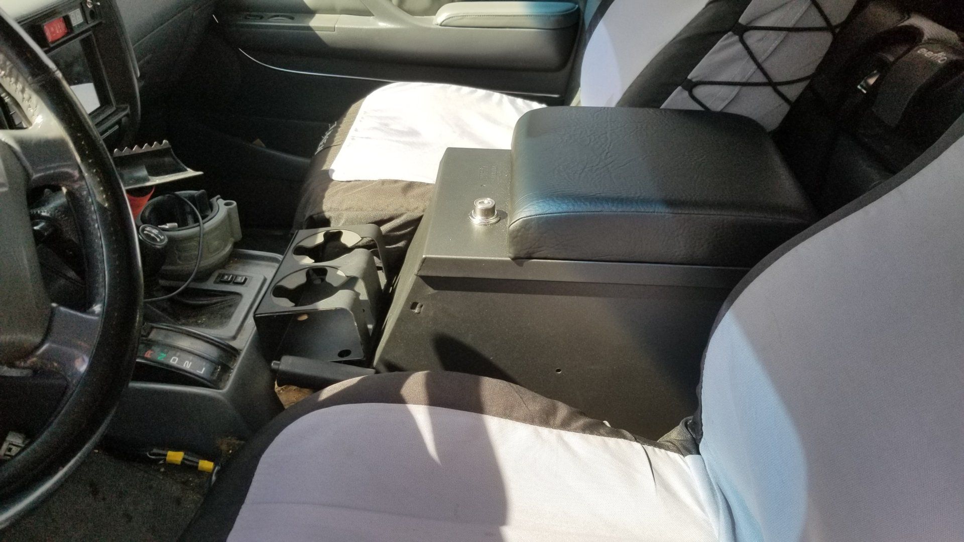

For my install I used 1 1/2" angle iron for front of box and 1 1/4" square tubing for mounting box securely underneath to bracket.
Pretty awesome to have an actual arm rest within reach and comfortable to boot, isn't it? Pretty much identical to how I installed my 10" tuffy. Probably my favorite comfort mod to date.

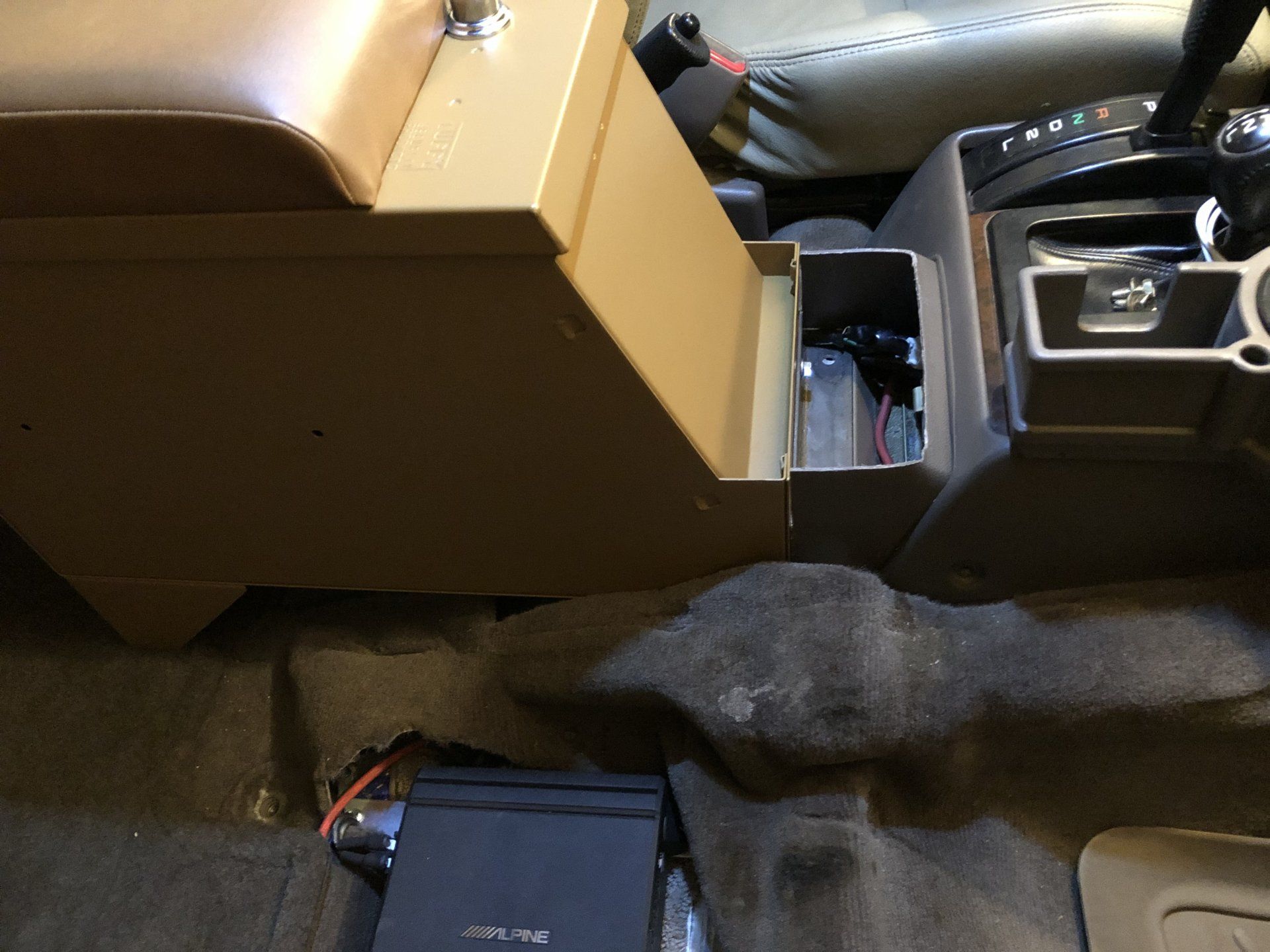

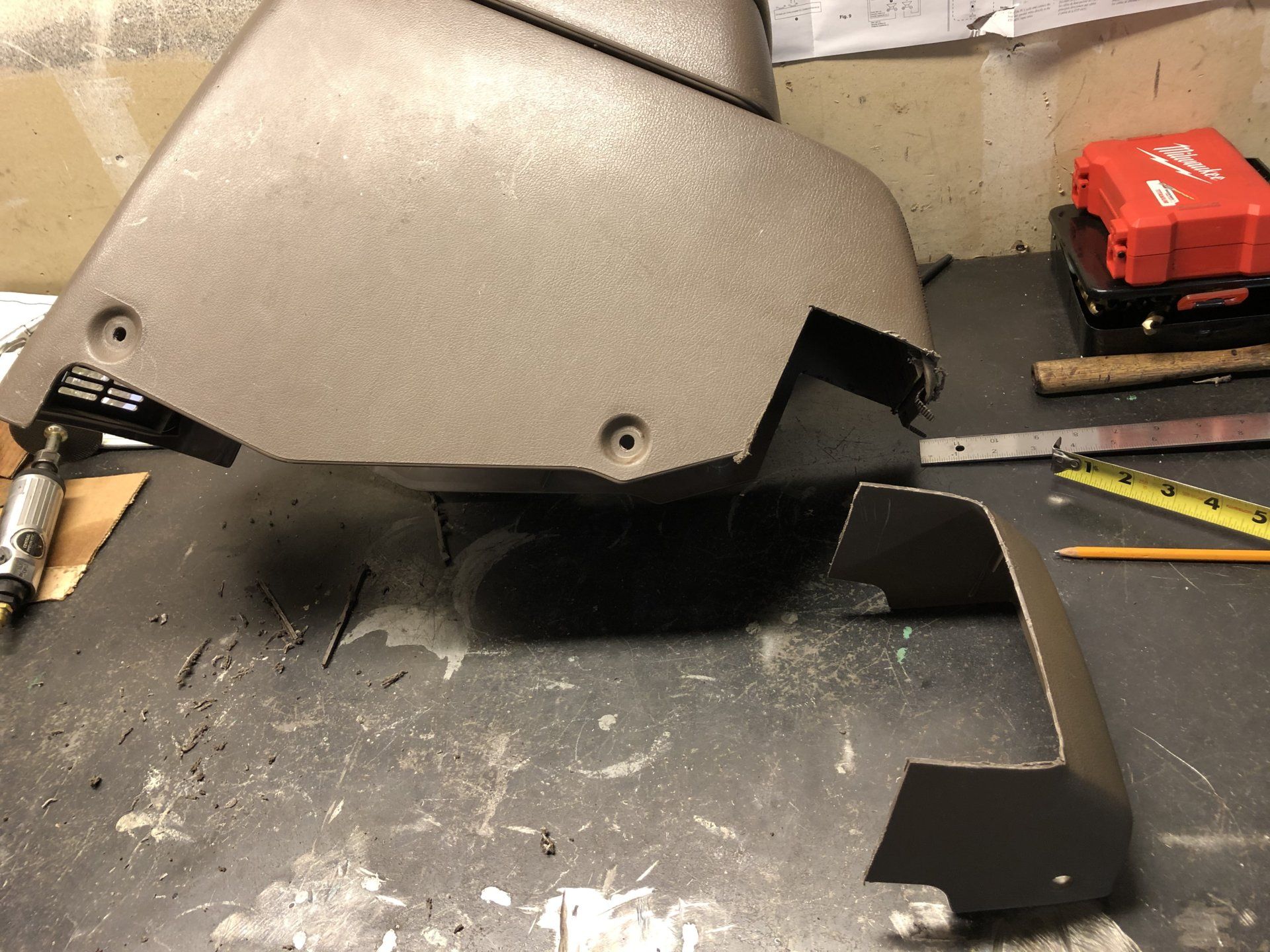

Still haven't figured out a good way to fill that gap. Putting the tuffy cup holder there would take a fair amount of trimming of the shifter console. Unless you put it on top, but then it'd look weird. Pic is with the cup holders just resting there.
You have any ideas, or anyone else for that matter?

JTSS, I moved the console as far forward as possible and mounting cup holder higher up...;)
This pic is just a mock set up ...not bolted in yet..
Moving center console forward and cup holder above gives one a lot of room in back seat area...

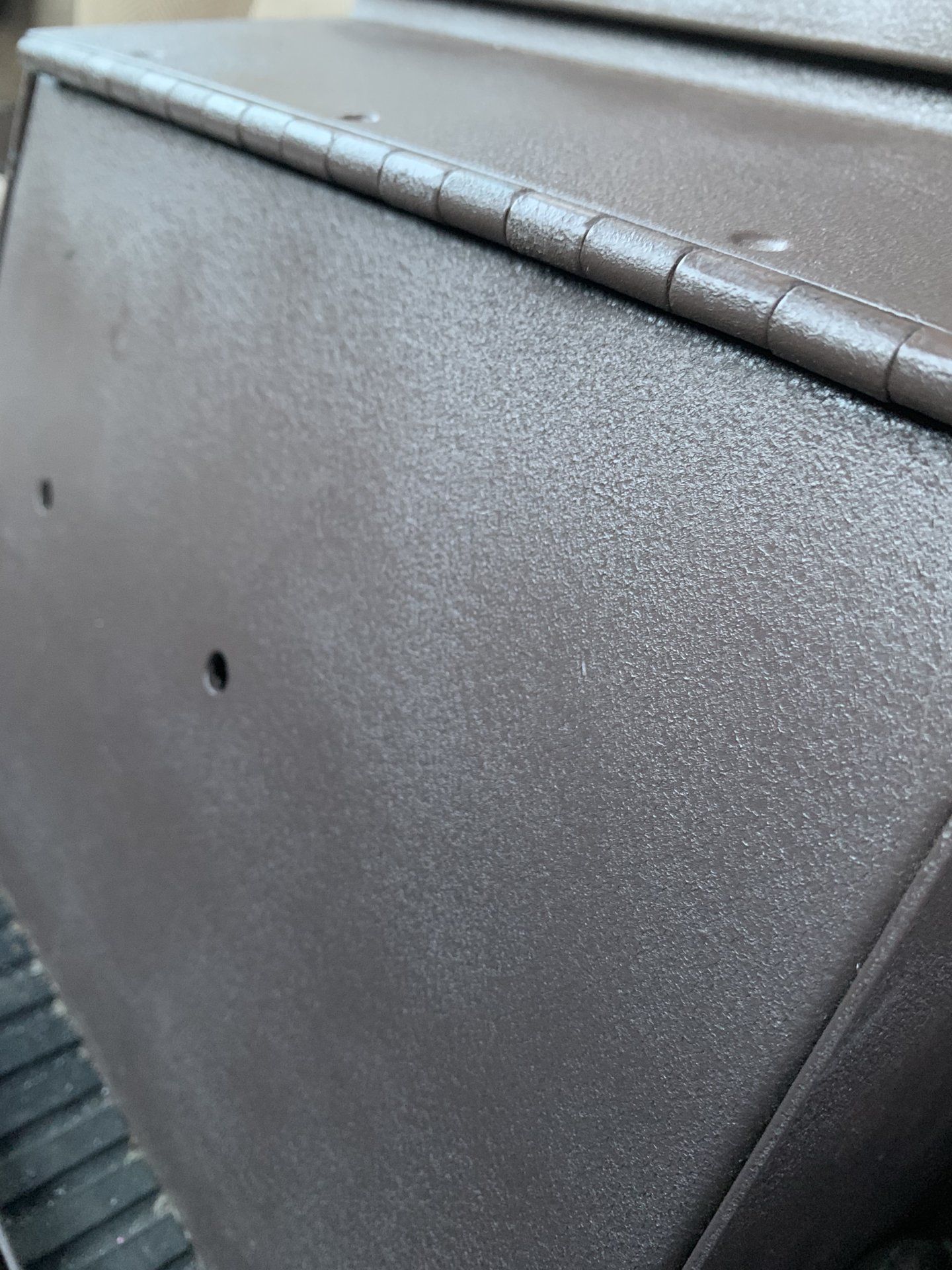

Trying to find a good matching color...tried rustoleum gloss sand...nope, it just doesn't work out, way to light...
Just sprayed with a darker tan/grey, I think I've found a match..pics to follow
Rustoleum Textured Bronze #7226 is a very close match. Easiest found online.

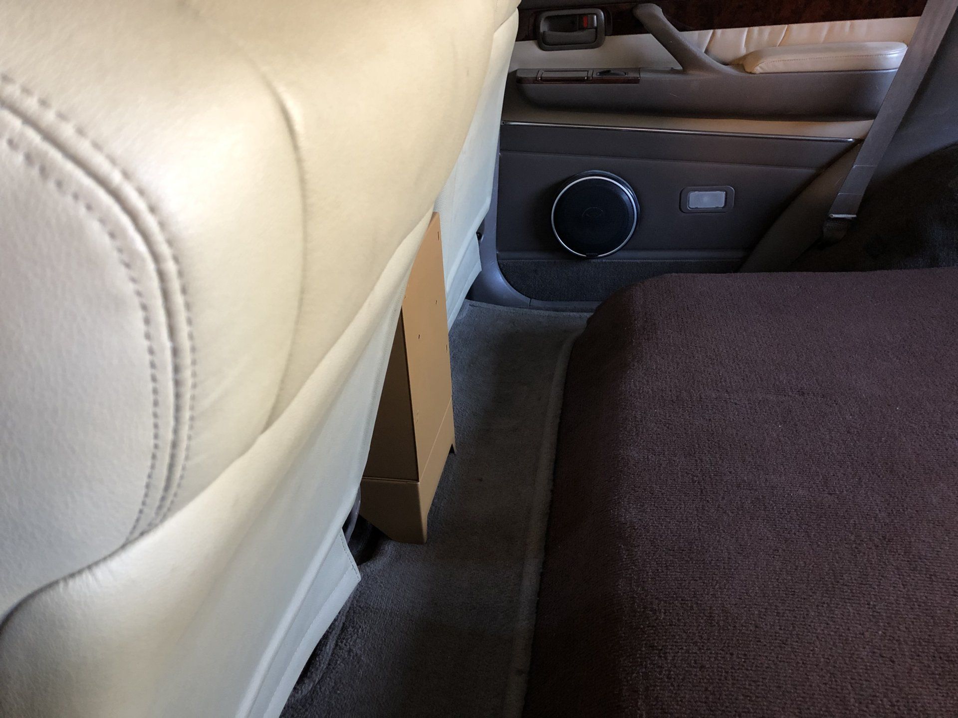

I put my cupholders on the back side of the Tuffy.
If you position the Tuffy right, the cupholders will clear the folded second row seats.
It's a little hard to see in this pic, but I used a piece cut from an old mudflap to fill the gap at the front.

It all went together slicker than a frogs belly ;)....got it painted to match interior and bolted in...just luv it!...it's a feral pig of a box.
