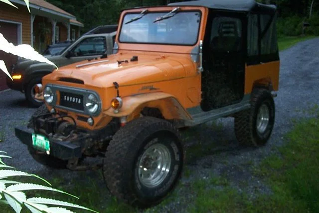

come to Burlington (actually Bristol) VT, and you can check mine out in person, if you would like. Wally built tub, long time ago. Still good as new.
don't look too close. :)

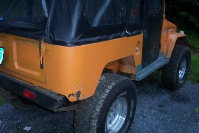

Two split original rears, cut the overlapping lip off, welded them together and added a 1" square stock across the inside bottom where it had rusted out (and for strength) And reinforced the joint weld with a 3" strap welded to the back. Follow all that?
I then took the original center latch and welded it on the end to the tub.
It is a 10 foot job (looks good from 10 feet) as I suck at teh bodywork.
