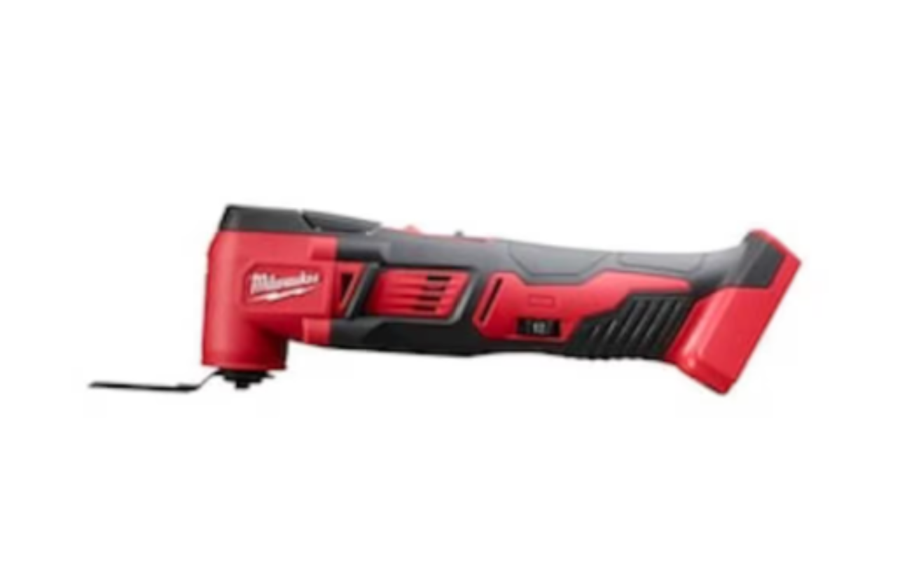

I have had great success using an oscillating tool to cut bolts. Just need to buy a good blade. I used it to cut the OEM rear body mounts.

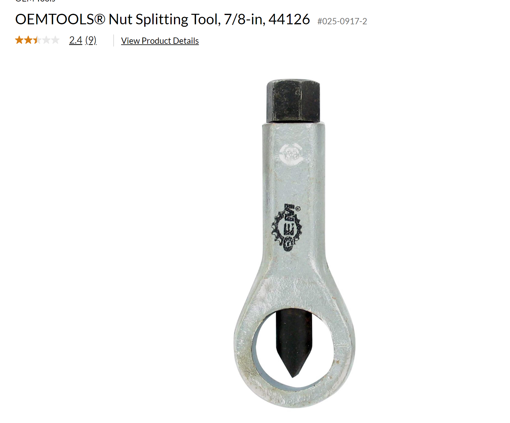

Or if there is enough room.. A nut splitter is a good tool as well.
One tool I've never collected. This is one location might be a great choice.

Well, been working on some other stuff and finally came back to these. Can I just say I hate carriage bolts? At this rate this thing will be done in 20 years. The oscillating tool worked great on the two bolts with the stripped threads. I've been able to get some other nuts off using PB blaster, heat and a breaker bar. Now, stupid question, but with the nut off I should just be able to push the bolt straight up and out, right? It's not budging. Thought I'd check here before I start banging my hammer on the bottom of the bolt to pop it up. Here's the pic of the bolt with the nut off. Thanks guys.
