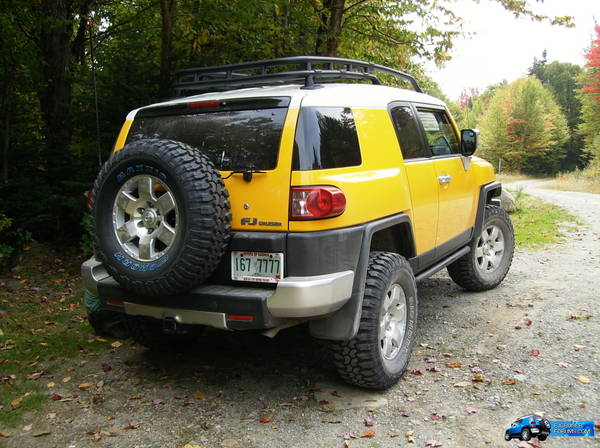

Here is mine I plan on running 35's in the spring

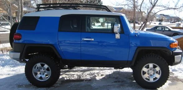

here it is....its nosediving...I only got the truxx lift cuz it was $200.00 and I did not plan on 35's but my eyes were bigger then my stomach...so the rear seems 0k, but maybe I should run a HD OME in front..(going to add a bumper)...... What about a AP off road coil over front? my only concern is a coil over is only bling..they dont add articulation sure they are adj..blah blah..am i missing somthing?

Wow that back is high for only 1.25" lift. Has everything settled in yet?
It doesn't look like it is sitting low, if it works I'd leave it alone
I'm sure you like everyone else has a list of other mods you want to do, I'd focus on them for now.
