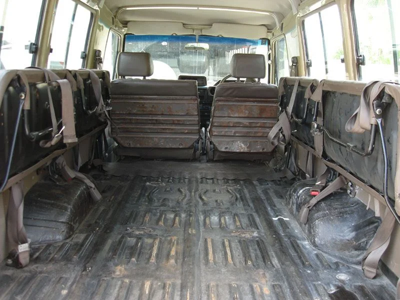

Well, After taking my 97' Troopy (HZJ75) on tree trips now, two to mexico and one to the desert I am zeroing in on what I want to do to it. To date I have done to following:

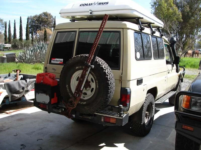

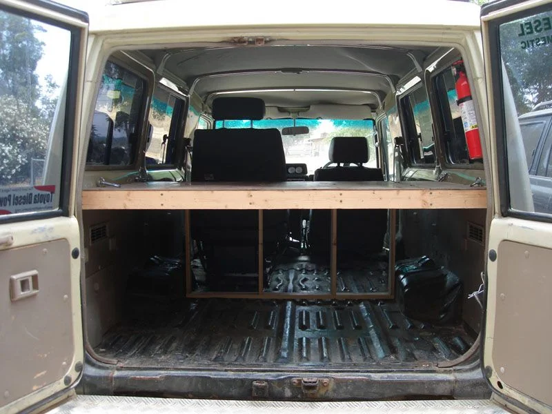

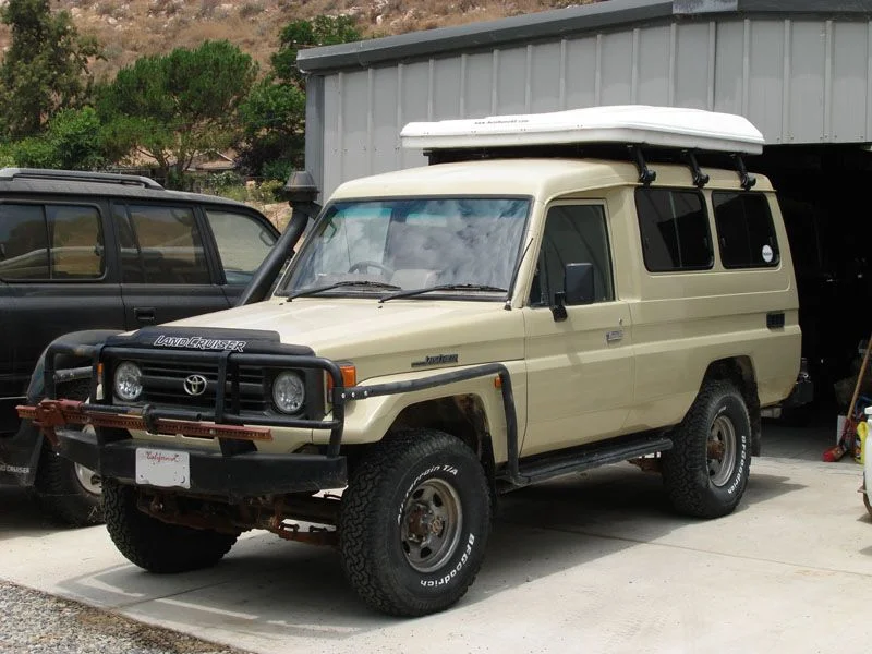

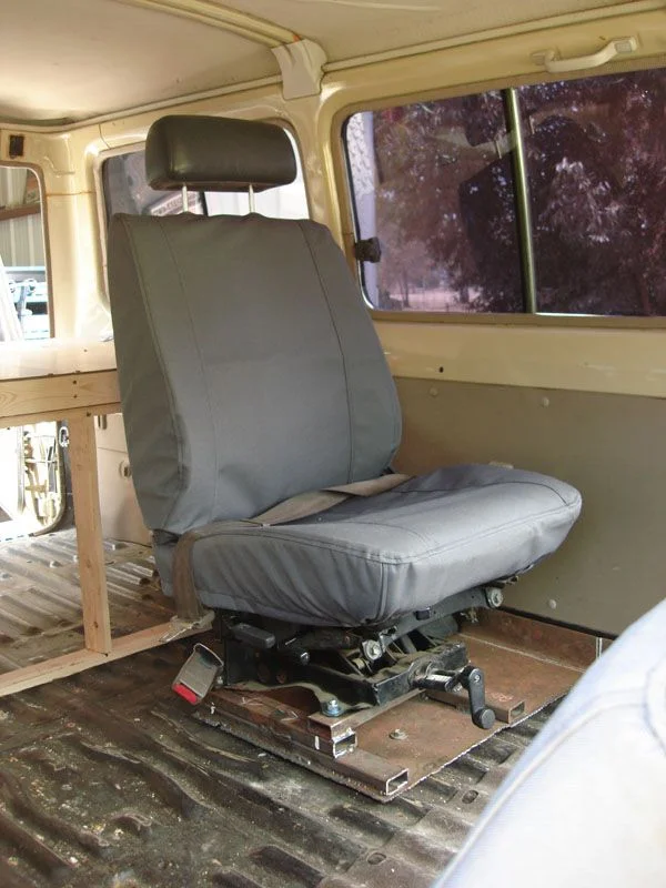

1hz turbo, updated bull bar & nerf bars, roof tent, remove the seating for 8, remove front bench, added suspension rear seat, built shelf, add kaymar rear bumper, gauges of course.

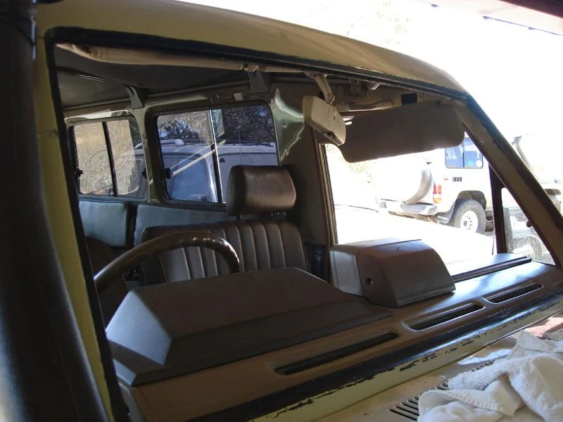

So I have learned that at least 2 spare tires is a must if you are really going on an expedition. I need to add overhead console for the radios (uhf) as well as a spot for solor converter. Propane tank storage (and probably PI), continue refinement on rear shelf and storage, possible even hood mount spare tire.
Here are a few photos:

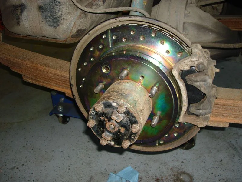

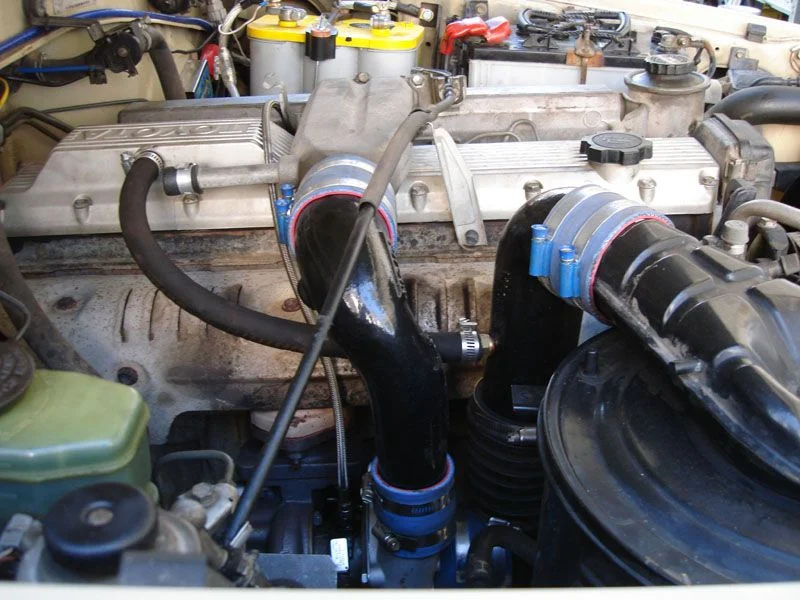

Pictures of work as I go...Here we have new rear disc brakes, turbo, dual batteries (12 volt system on this one since it's from OZ), and kaymar rear bumper. You can also see the side nerf bars and the roof top tent.

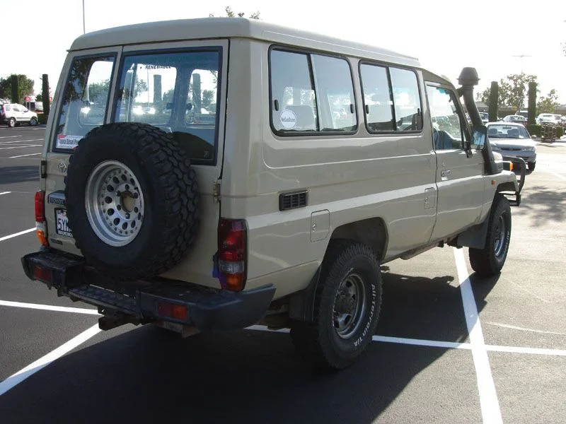

Hi Mike. What was wrong the old bullbar?

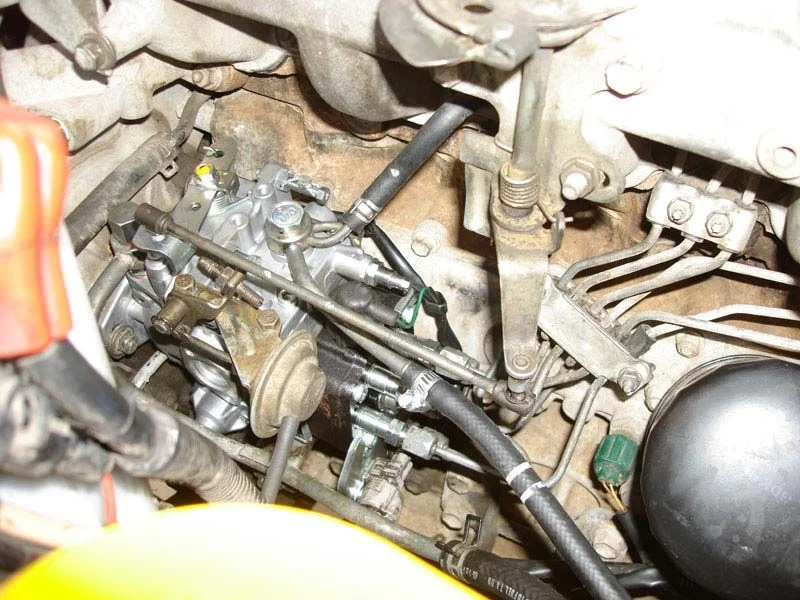

Did the new pump make a big difference?
I got the truck with 2 ARB Bull bars, one with winch mount (had rust, very old style) and one without, that had holes already drilled for nerf bars. The winch mount one was mounted on the Troopy. I basted and powder coasted the second one with the nerf bars and then put those on the truck, the first bumper I then cleaned up blasted and powder coated. At some point I probably will but the first one back on the truck with a winch.
The original injector pump went on my second trip (I was about 600 kilometers south of the US in Baja Mexico). So it had to be replaced. Luckily the pump went in a way that the Troopy was still driveable. I could not rev the engine over 2000rpm but under that it had full power so I drove it back never going over 2k rpm (slow going back). The new pump was obviously much better, and I a pretty sure the original pump was on it way out when I got the troopy. At the time I thought that was very strange for a pump to go with only 178,000 kilometers on it but most of my friends in Austrailia say tha is NOT that uncommon on the rotory pump.

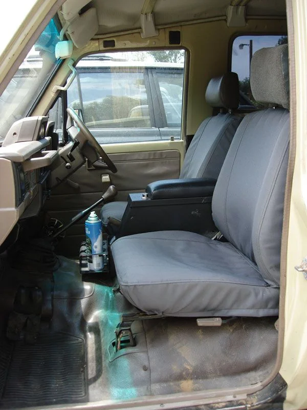

Mike ,whats that coming out of the floor where the PTO shifter normally goes?

About the "need" for two spares. I've never had issues with my BFG tires in thousands and thousands of miles of Baja and Mainland Mexico, as well as hundreds of thousands of miles here in the US. I know folks will take two spares through Africa, but other than that, I really think it's just extra weight. Spend the $ you'd spend on a second spare on a good set of tubeless tire repair tools and a patch kit/compressor.
