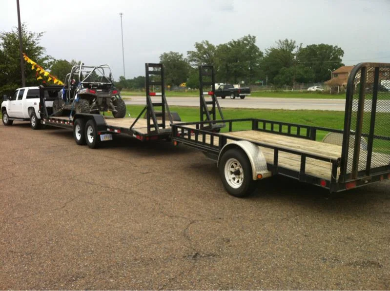

Anyone done this? I want to tow a camper (ball hitch) and tow another smaller trailer behind it (ball hitch). It would be behind my Ex and I have a controller. I wouldnt be close to GVWR, but may be long.

Two bumper pulls is a death wish. The second trailer can/will get to whipping pretty good at any reasonable speed.
Pulling a fifth wheel or gooseneck with a bumper pull behind it isn't nearly as bad, but they can still sway.
You've seen the UPS trailers in triples, no doubt? They call them "Wiggle Wagons" for a reason, and they're all on fifth wheels.

Here in CA, if you have the license, the hitch on your first trailer must be rated for the combined weight of both trailers. So you're pretty much limited to a pintle, gooseneck, or fifth wheel.
Even where it may be legal, do you really want to do it? and how skilled are you? Especially if you are nearing max capacity. Are you willing to put all your toys in jeopardy and more importantly peoples lives.

If you have it set up properly, why would it be unsafe?
This was my bumperpull setup. Worked great once I got the sway bar installed on the camper. Before the sway bar it was crazy.
The gooseneck makes it rock solid. No feedback at all.
