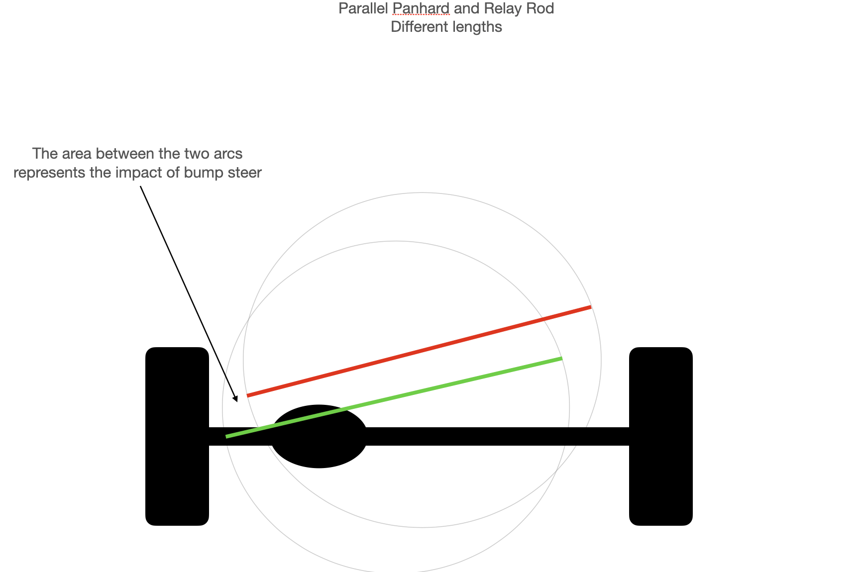

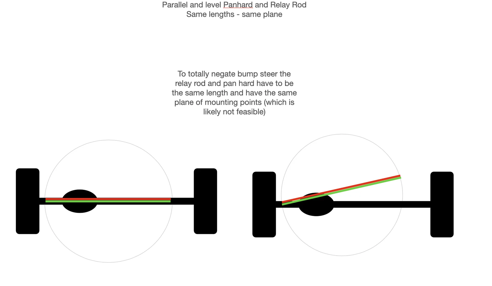

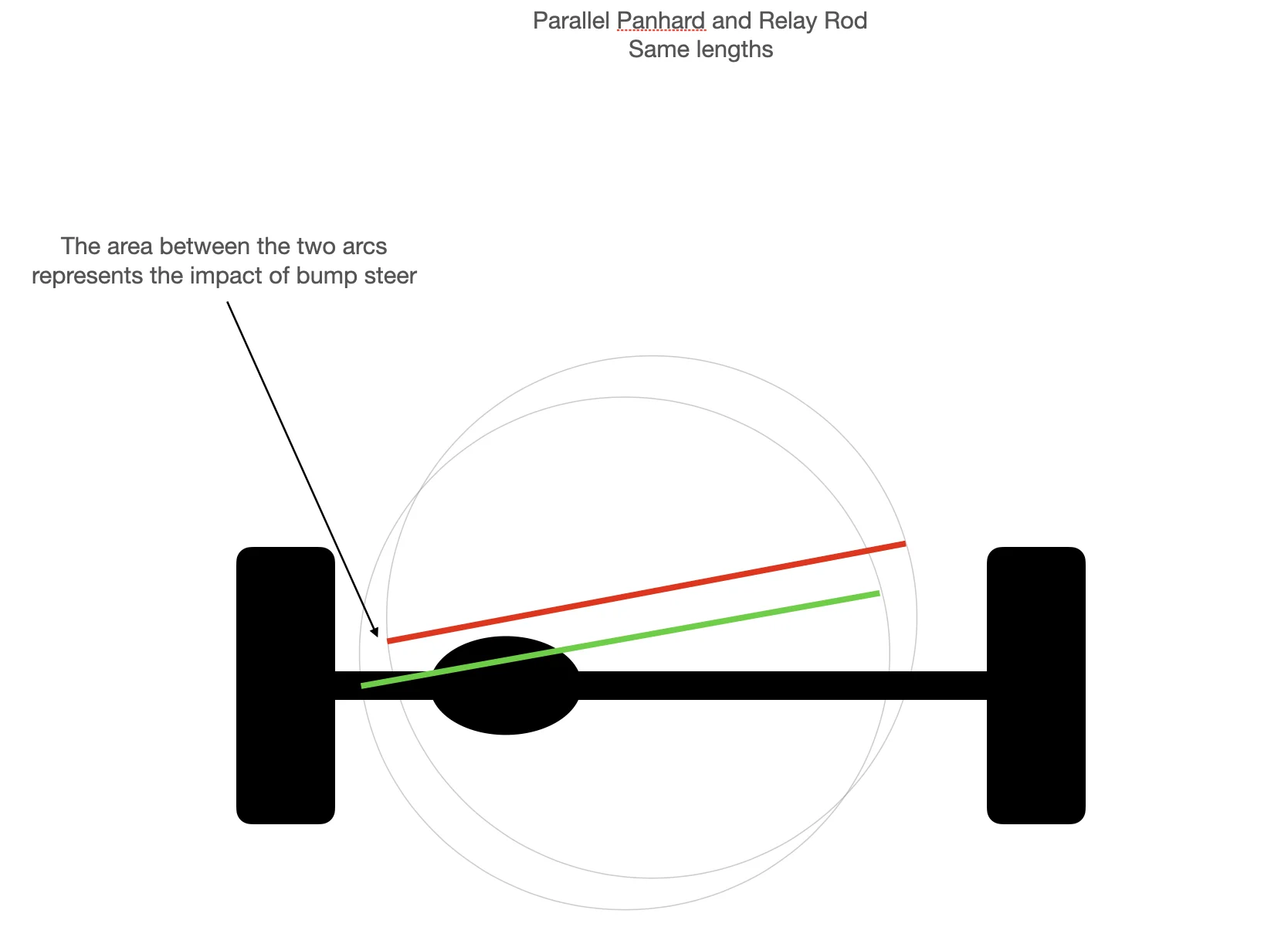

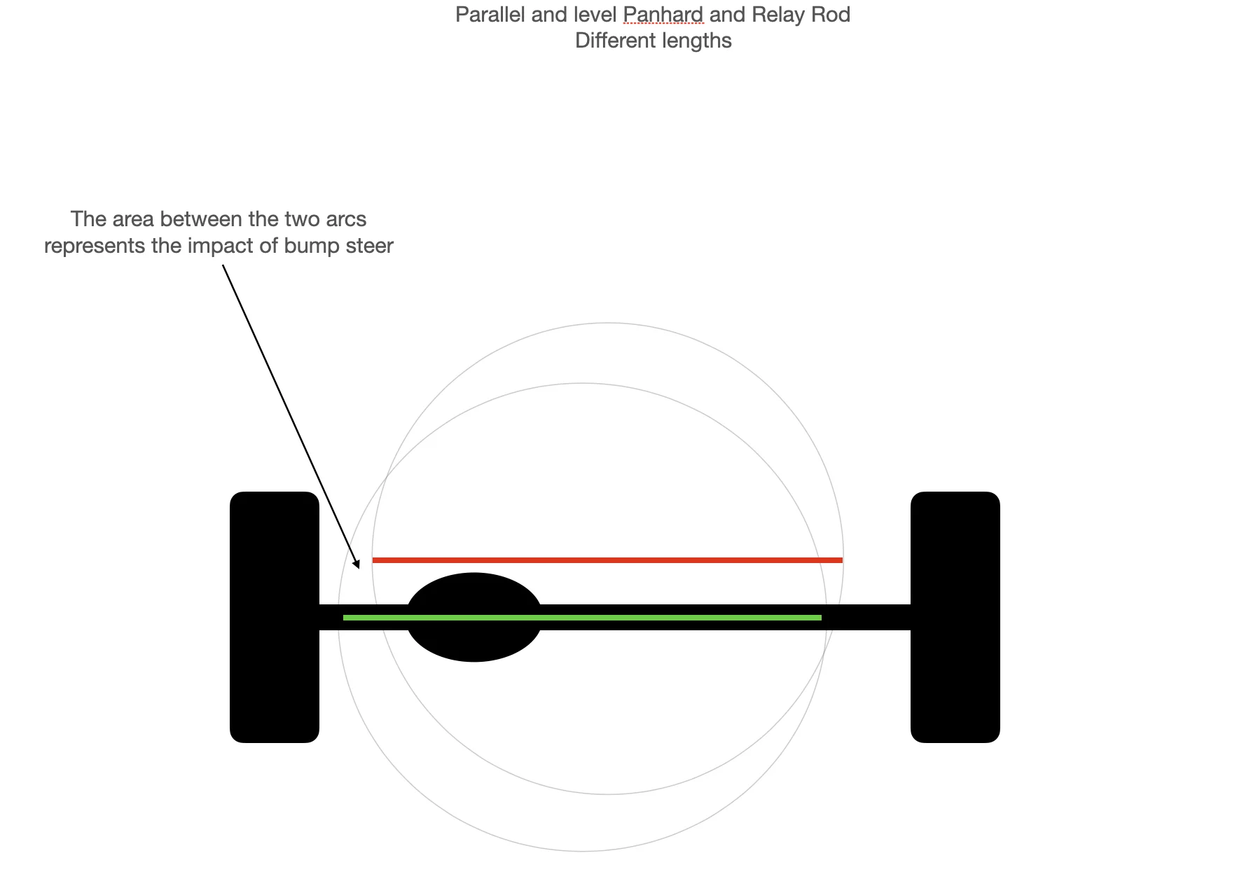

I also studied the issue of bump steer as I was doing this. I had a friend tell me to make my panhard level and I also read to make it parallel to the relay rod. Which is right? As I drew this out on paper, it's much of the same. You'll have bump steer either way. The only way to eliminate bump steer is to mount the relay rod and the pan hard in the very same plane but room make that nearly impossible. Here's a few drawings to study.
On a stockish FJ40, another issue plays in the mix. That's the fact that you can't make the panhard and the relay rod exactly the same length. There's just not space to line up the mounting brackets. That issue also amplifies the bump effect since they're traveling in slightly different arcs. It's a small difference but there.
I talked withe a local fab guy and full hydro-steer can eliminate this but he didn't recommend it for a vehicle that might travel on the highway. His thought was it had a tendency to wander (I still have to investigate this since I have no experience with it.). He did say, hydro-assist helps dampen the bump steer.
I'll post up some pictures. I'm waiting on a coil-over spring exchange.
