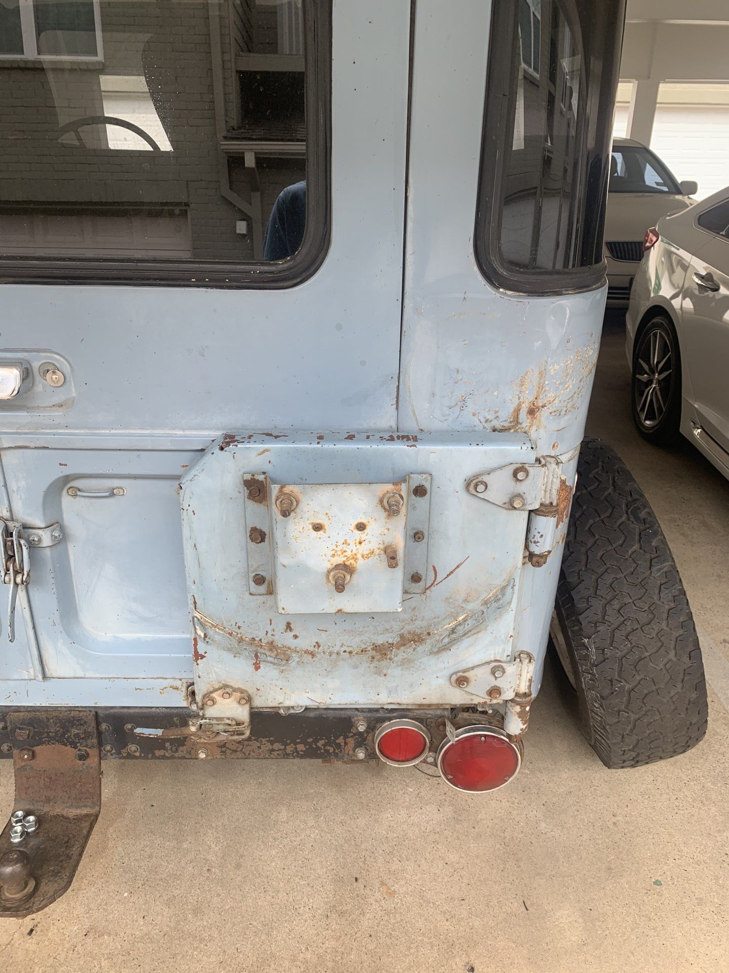

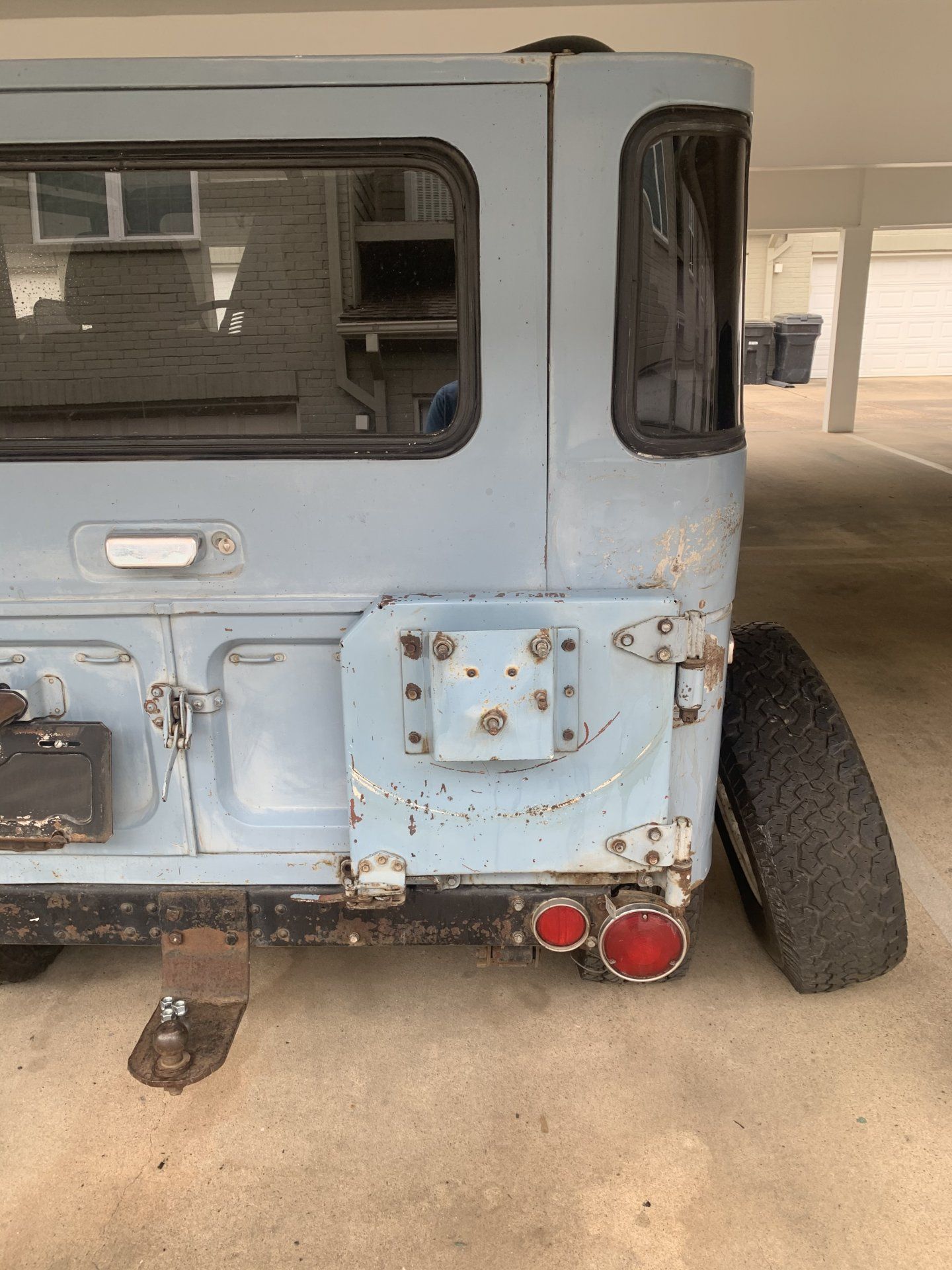

Hello all, could I please get some suggestions for treating very minor surface rust. What I'm thinking right now is sanding away paint until smooth, spraying on phosphoric acid, wiping and sanding all rust away, then putting on primer. I will do it all in sections, and then once everything is primered, it will get a one step paint job.

So, will the CLR mix also remove some paint along with the rust?? Or should I sand away the paint and hopefully a bit of rust, and then use the CLR mix on the rust?? Thanks!! Also, do you have any suggestions for a chemical treatment after the rust is gone, so then it doesn’t come back for a while? Thank you

Thank you! I’m planning to probably remove the paint all together, because at some point the PO tried painting another color.
You can do that with clr/Brillo if you want to try to keep original paint. There have been a number of people that have had success doing that.
If you don’t want to keep original paint, just get a sand blaster. Way faster.
