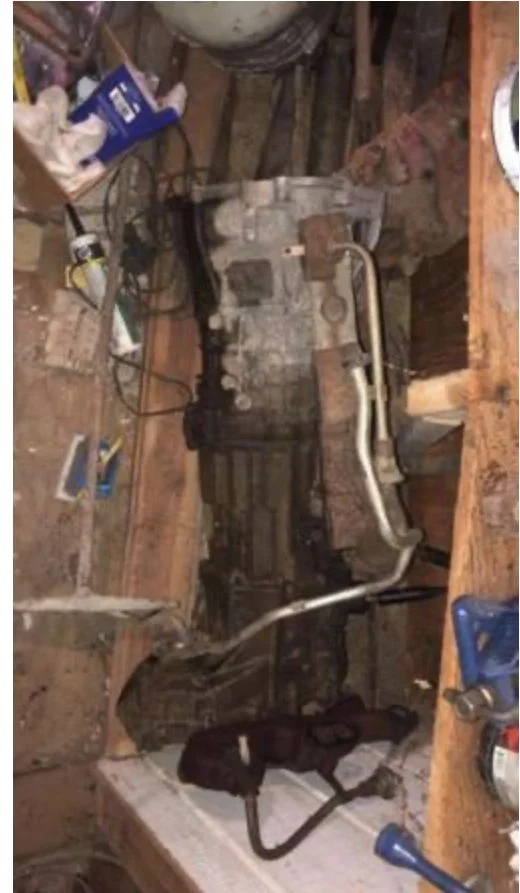

Thanks for the input guys! Here’s the only picture I have of it at the moment. It’s from the ad and it’s not the best. I asked him for some more pictures this morning and I’ll post them as well if when he sends them. Thanks again
Caution! Looks to be a driver's side drop. Your '79 is a passenger side drop. Transfer case may not bolt up.
Thanks for catching that. If I’m going to use the both tranny and tcase in the picture will I still have a problem or do you mean it may not work using the 5 speed tranny and my existing tcase? Thanks
Both. T-case may be chain drive vs. geared. Bolt pattern is different between the two. Inspect before you by. Call Marlin and ask questions, they know stuff.
