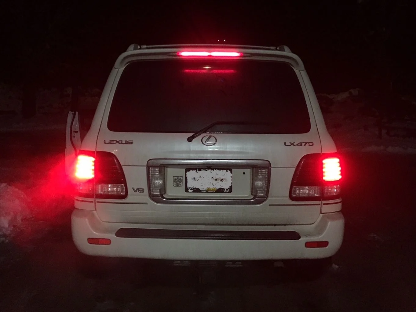

Also realize this is an old thread but found it in a Google Search.
Having thew same issue with my recently purchased FJ Cruiser. All four of the ABS, VSC OFF, VSC TRAC, TRACTION warning lights came on during the ride home from purchasing. The next day, we couldn't get it out of Park after starting the motor. Found the Shifter manual unlock button and used it.
Assume it is the Brake Light Switch... Does the brake pedal removal as depicted above work on the FJC too?
Sorry, I don't know about either question. Somebody will.
It turned out I just had to replace a bulb in the rear light. Really odd it could a fuse to short out, but now it works fine.
LUCKY DOG...
