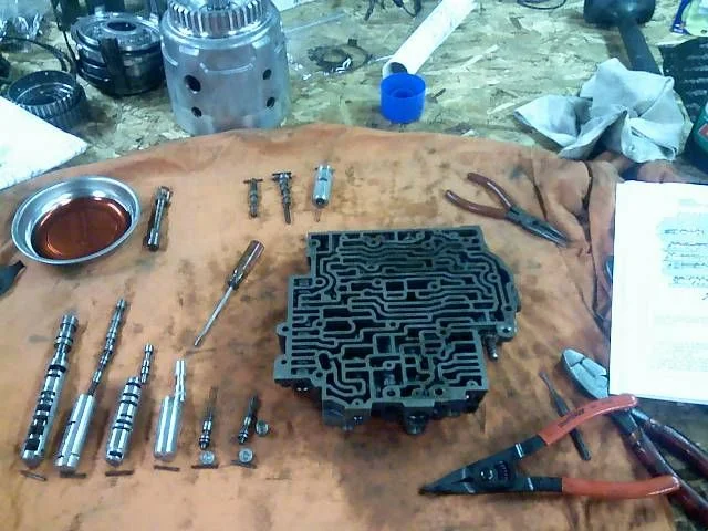

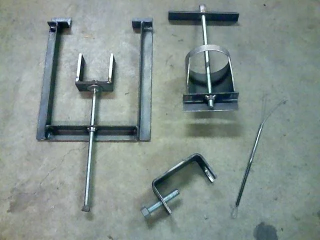

Couple of pics: 1) Valve body going back together after cleaning--it had so much friction disk grit in it that some of the valves were stuck completely 2) Tools you have to make to save yourself hundreds of dollars. I think I spent more time making tools than I did tearing the trans down. :grinpimp:
