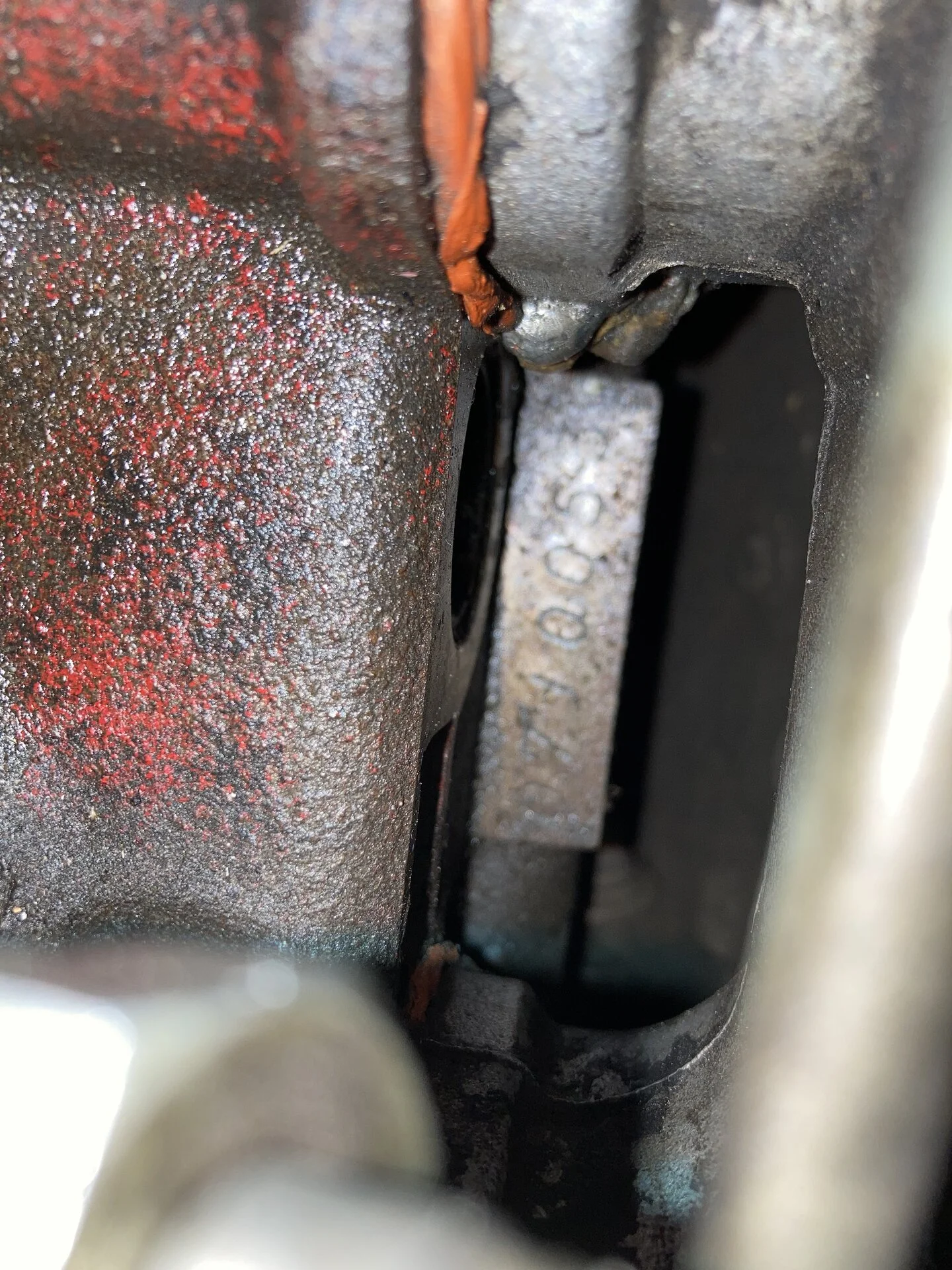

I believe on the transmission oil fill side, there should be a Toyota stamp with some ID.

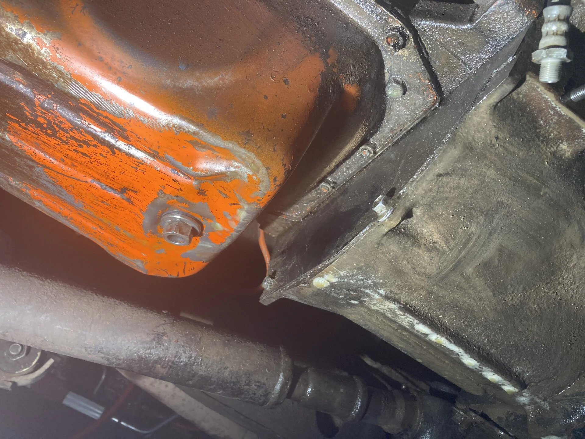

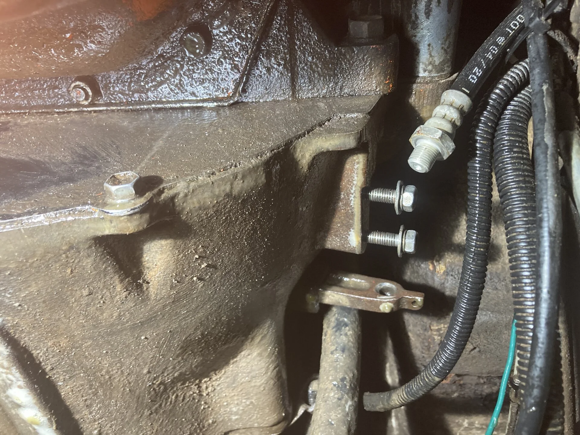

Still more cleaning to do but here are the markings and photos of my transmission so far.
Looks like a yota trans

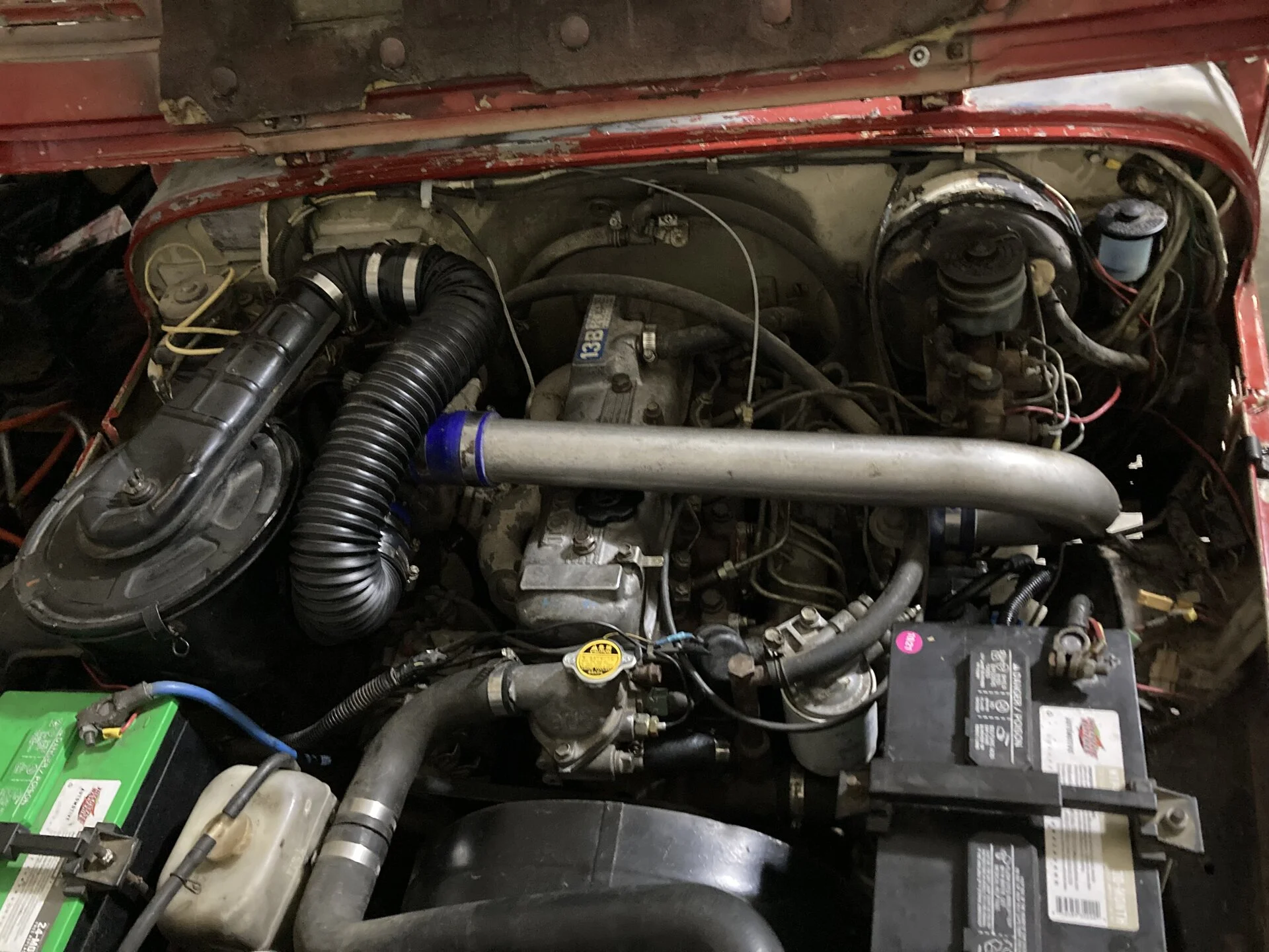

Thank you. 4-speed, believe the truck is from Canada and 13B may be from a Dyna BU 62 or similar but don’t know how to determine month and year of the engine ( see pic of engine number photo below)
Your interpretation of the transmission markings matches my VIN (see photo) of the truck so this transmission may be the stock transmission. That information you provided is extremely helpful because I am having trouble getting a replacement slave cylinder to work properly and was questioning whether it was a stock transmission. The slaves keep failing.
Added a pic of the engine for fun.
