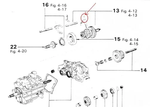

I suspect this pin has sheared:

Either the pin has sheared or the "L" shaped lever to the left of it has broken/sheared, I've seen it happen on occasion. Have you verified the shift linkage is all in tact underneath. There is a bolt on lever that bolts to the shaft that protrudes into the transfer case, it could be slipping there?
I had this same thing happen once and it was the "L" shaped lever as Kurt mentioned.
If you drain the fluid and open the inspection cover on the transfer case, you can see for sure if that lever is seating properly or not. When it happened to me I took a long screwdriver and reached in through the inspection hole and pushed the "L" piece back into place while a friend shifted the transfer case back into "high" so that I could get home. If this is your problem, don't try to shift the transfer case back to low until you fix it as you will have to repeat this method all over again.

and it seems that it was that "L" shaped lever, as suggested by Kurt and MadmanCruiser, that had lost its connection to the internal shifting rod. But there's more to this story...
It seems that this has happened before.
When i felt around to see if the bolt was loose, etc. I found that the linkage connector on the top of the "L" lever wasn't secured all the way down to the base of the shaft - there was some space between it and the top of the transfer case. So I thought straight away "ok, excellent! the bolts came loose and the linkage has migrated up the shaft, thereby losing any useful connection, therefore not shifting"
But upon further investigation, i felt something unusual around the shaft (it was getting dark and impossible to see) but it felt like a hose clamp. So I removed it and it was, indeed, a hose clamp! Then I removed the linkage from the shaft. I fiddled with the shaft of the "L" lever, trying to see if i could regain connection by feel. But it was very loose and started to drop into the transfer case. Eventually it dropped so far in that there was no longer any shaft left protruding, and I could not grab it any more.
It seems like a previous owner encountered this problem before, manoeuvred the "L" lever into place, and secured it there by means of the hose clamp, and simply bolted the linkage onto the remaining space left on the shaft (which wasn't much). So it was just a matter of time before it came loose again.
Seems to have worked like that for quite some time, the PO was honest and looked after the troopy, was a diesel mechanic, and so I don't think he would do such dodgy workmanship. So must have been the owner before him, or before him...
Anyway, I'm going to use a strong magnet to pull the lever back out again, and then use that magnet to hold the shaft up and into place while a properly secure the linkage. Should work for now.
