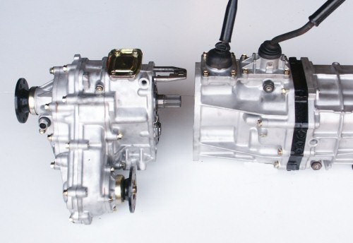

This is a forward shift:
Is this what you are talking about?
If so, the shift rails both need to be forward and the holes need to line up to make a square, then it is in 4H, remember everything is oposite from the way the shifter moves. the shifter goes right and up to go to 4 low, so that means the left shift rail goes down when going into 4L..... Sounds odd though.....
Yeah, thats what I'm talking about, Jerod. I didnt relize these transmissions and tranfercases were metallic gray. Since all the ones i have ever seen were brown :lol: ;)
I understand the way the shifter rails have to line up, and all. Its just mind boggling how far back the left rail is when its in 4Low. cause I can put the shifer in the slot on the left fork, and then the bolt holes on the plate are about 3/8" behind the holes of the trans.
I have never had a problem with this. Its like the shifter needs to be longer.
:confused:
Well it is a j patern.... 4L is farther forward than 2H.... Maybe it's an older forward shift version or something? I know that 84 will swap into 86..... But now I have a top shift and am not planning on going back!!!! :D
